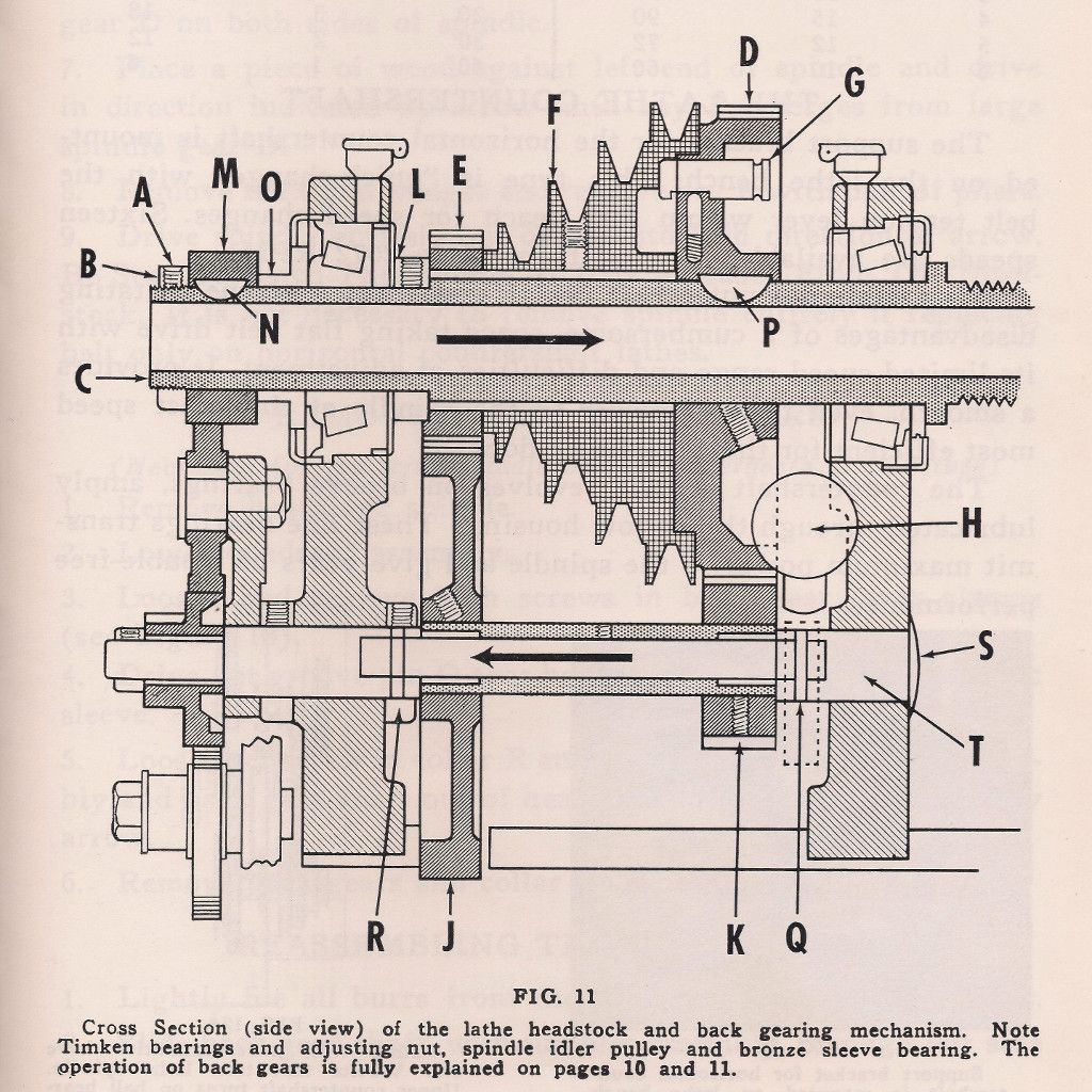

        Depends entirely on how accurate you want your lathe to run. I would never even consider mixing old and new bearing parts. Bearings usually wear because of either bad fitting or lack of lubrication/ingress of contaminants and if yours are worn then they are worn all over. When the lathe was first manufactured the Timken bearings were fitted because they are specially designed for machine tool spindles. The design of these bearings is very specialised and there is a massive difference between them and the "common" taper roller. Timken normally sold these bearings as pairs or sets and they were designed to run with a certain amount of preload. If fitted correctly they would run as sweet as a nut as long as the lubrication was adequate and of the correct grade and quality. Fitting commercial quality bearings would be o.k. but don't expect super fine surface finish, chatter free machining etc.
        Colchester and Harrison among others changed to using Gamet (pronounced Gamay) bearings and even put a plate on the outside of their lathes to advertise the fact. These are also a very high quality unit often manufactured to special order (and odd sizes !!). It is worth remembering that as a previous poster noted the price reflects the quality. Unfortunately machine tool bearings are usually the best quality for the reasons given above.
        It is still possible to buy matched sets of bearings to order but obviously this is reflected in the price. Many of the far eastern manufacturers at the budget end of the market use the lower quality type in order to keep prices down (and this can be heard and felt if you choose to do so).

                With the threaded nose, if it's as damaged as you say is there enough meat to turn off the old thread plus a little bit, cyt a fine thread, then make a sleeve with a matching internal thread, assemble it with Shaft Lock Loctite, then cut a new nose thread. Better fix the bearings first I suppose.

                  I think the other Ian was referring to the threaded part at the back of the spindle rather than the spindle nose:
                  The threaded collar B applies the pre-load to the bearings. There is plenty of meat available to just turn off the old thread and cut a smaller diameter thread and make a new collar to suit.  No need to change anything else.
                  The drawing is for the under-drive version with the back-gear under the spindle but the principle is the same.
                  To use the bearings without the flange, the inner oil baffles could be replaced with flanged retainers screwed to the inside of the headstock. You will have to be careful that they can support the pre-load which is set with the spindle at working temperature (about 25 C above ambient) by tightening the collar until all fore/aft play measured with a dial gauge is eliminated and then given another 1/16 of a turn.
                  If Ian L2 would like a copy of that drawing I have put a higher resolution version here
