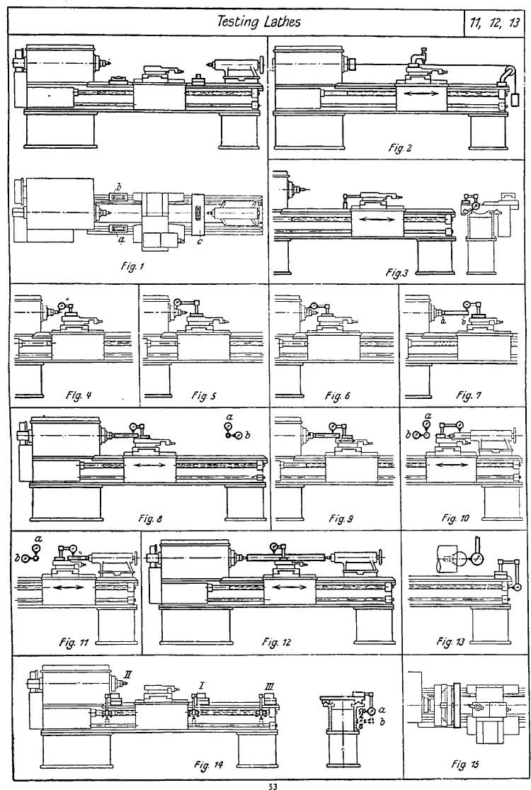

      Just for completeness, these are the various arrangements for each of Dr Schlesinger's lathe tests. Click for a larger view.

                  Posted by Neil Wyatt on 30/06/2015 18:01:18:
                  Good to see that a between centre test bar is used. Easy to make pretty accurately even on a lathe that is a bit out. Turning can be substituted for the other test bar but would be best to sort out head stock bearings first. In fact it's safer to at least check that before doing anything else.
                  Not come across the wire and weight before. Interesting one.
                  Really the other one is to turn in several ways first as that can help interpret results.

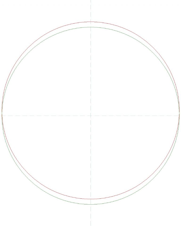

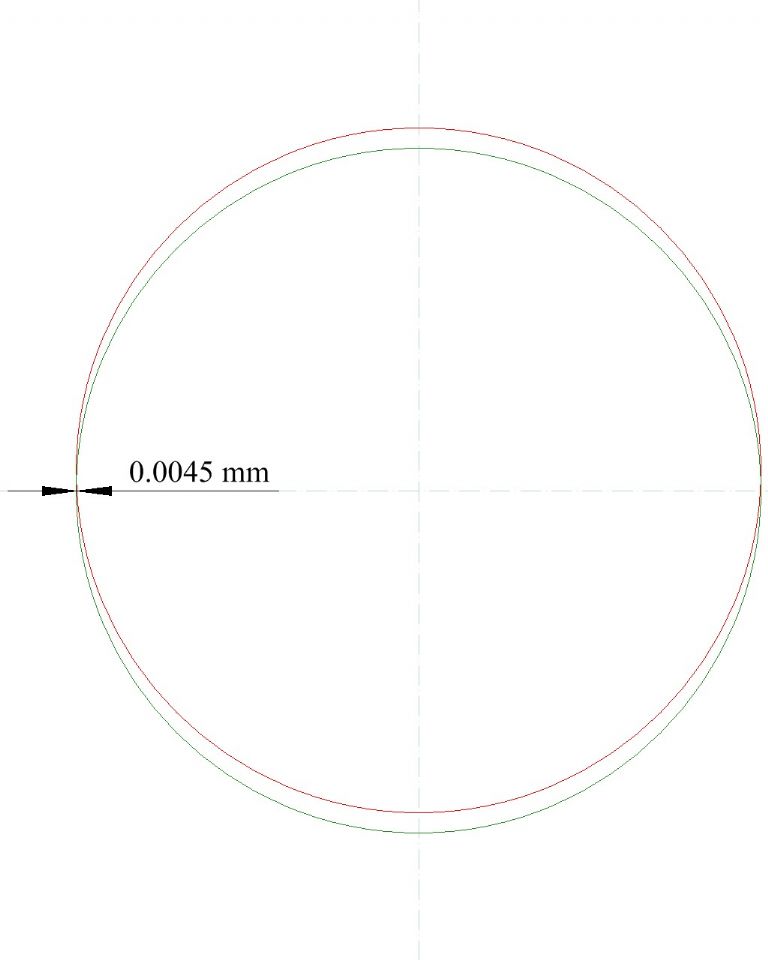

                                                    A few more pictures to say how I convinced myself to stop worrying about this – of course others may be different but for me I concluded my lathe was good enough for the things I wanted to do. As a very wise man said earlier in this thread ‘don't worry so much.’!!
                                                    Draw a circle 5 mm diameter
                                                    Draw another identical circle on top of it
                                                    Displace one circle up by 0.15mm
                                                    Measure the distance between the two circles on the horizontal and where the cutting tool is
                                                    Edited By David Cambridge on 04/07/2015 06:59:26

                                                      David as you have shown its not so bad when turning. Now put a 3mm reamer in the tailstock chuck and see what happens, the top edge of the reamer will be high by 0.15mm so in effect acting like a boriong bar taking a 0.15mm cut as it tries to straighten itself so your hole will be double that at 3.3mm which is certainly more of a problem than the O.009mm on dia whan turning.
