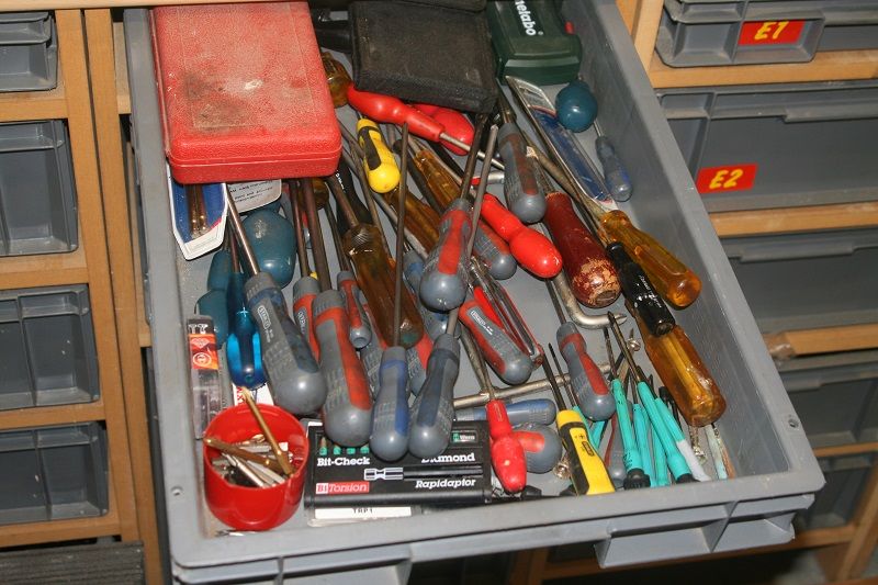

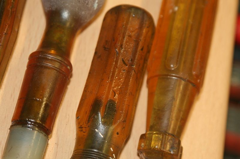

                                            I have the same problem with some Stanley Screwdrivers dated from a similar era. These ones have a yellow plastic handle emitting some sort of liquid, but I thought it was my imagination….
                                            Pete

                                                    Spurry
                                                      @spurry
                                                      img_9712a.jpgAs I do not seem to be the only one with 'strange' screwdrivers, just been out to the workshop to re-check mine.In the whole tray of screwdrivers there are two, at the moment, that are 'sweaty'. The liquid also has an acidy smell,for want of a better word. First pic shows the worst of the two, as removed from tray indicated in second pic. These are, I believe, Steadfast not Stanley as first thought.
