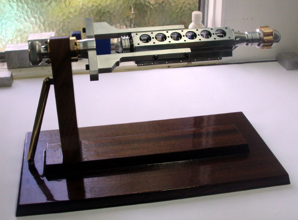

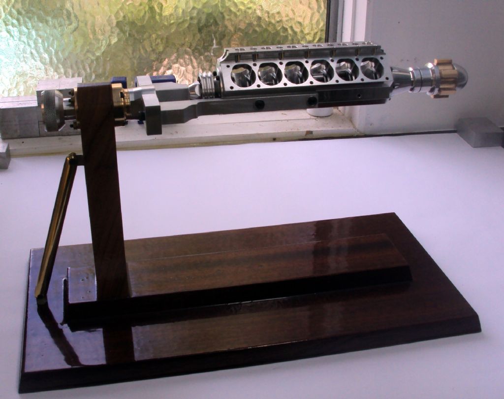

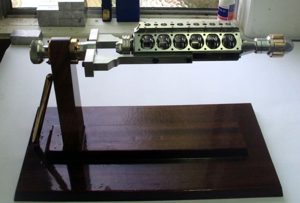

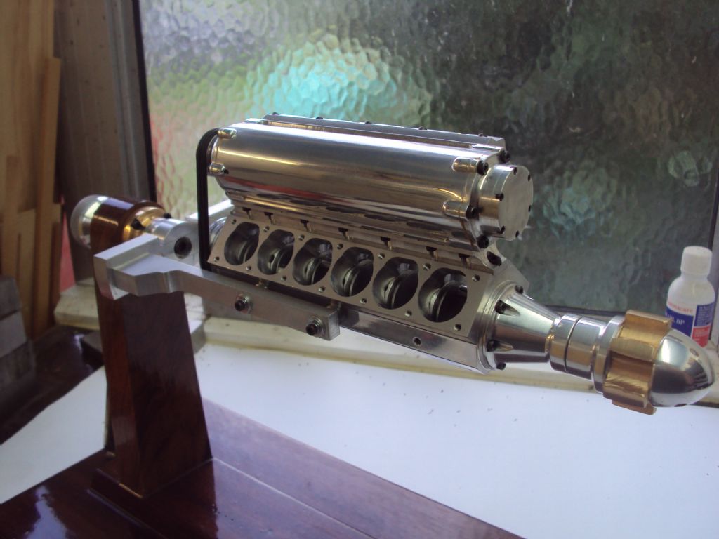

      OK so i have a fairly decent excuse for the delay in updating this thread this time, called a burst appendix!!! which as it turns out was nearly responsible for me checking out of life way too early!!!!! Thankfully i have learned to listen to my wife in times of crisis and let her take me to the docs who immediately put me in an ambulance and sent me on my way to hospital. Surgery on the same afternoon saw me alive but stuck in hospital for the next week, but alive none the less. so just before i went to hospital i had started to make an engine assembly stand so i didn't need four pairs of hands to put these engines together. Below are some photos of said stand with the V12 fitted and undergoing final assembly. hope to have this engine finished and running by the end of November, here's hoping anyway.
      cheers for now
      dean
      The brass gear looking thing is just a fitting to enable turning the engine over by hand without having the prop fitted. Makes life a bit easier when assembling the engine.
      dean
      Edited By dean clarke 2 on 09/10/2014 01:03:00

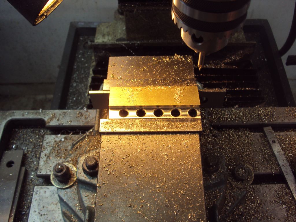

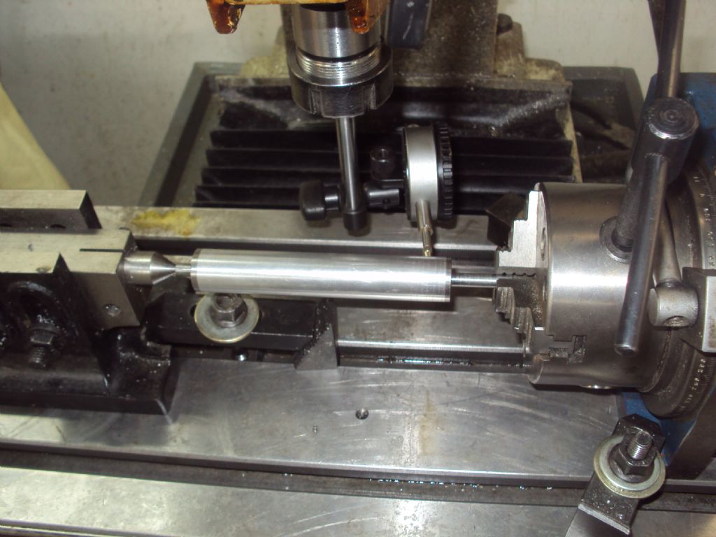

                      dean clarke 2
                        @deanclarke2

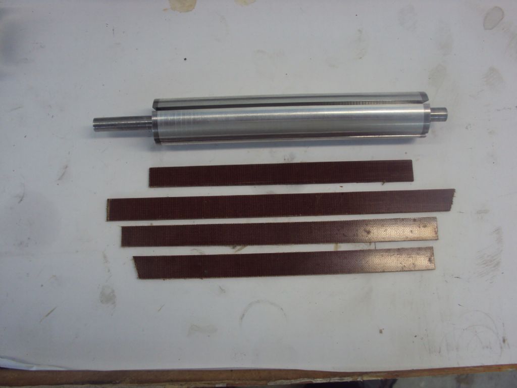

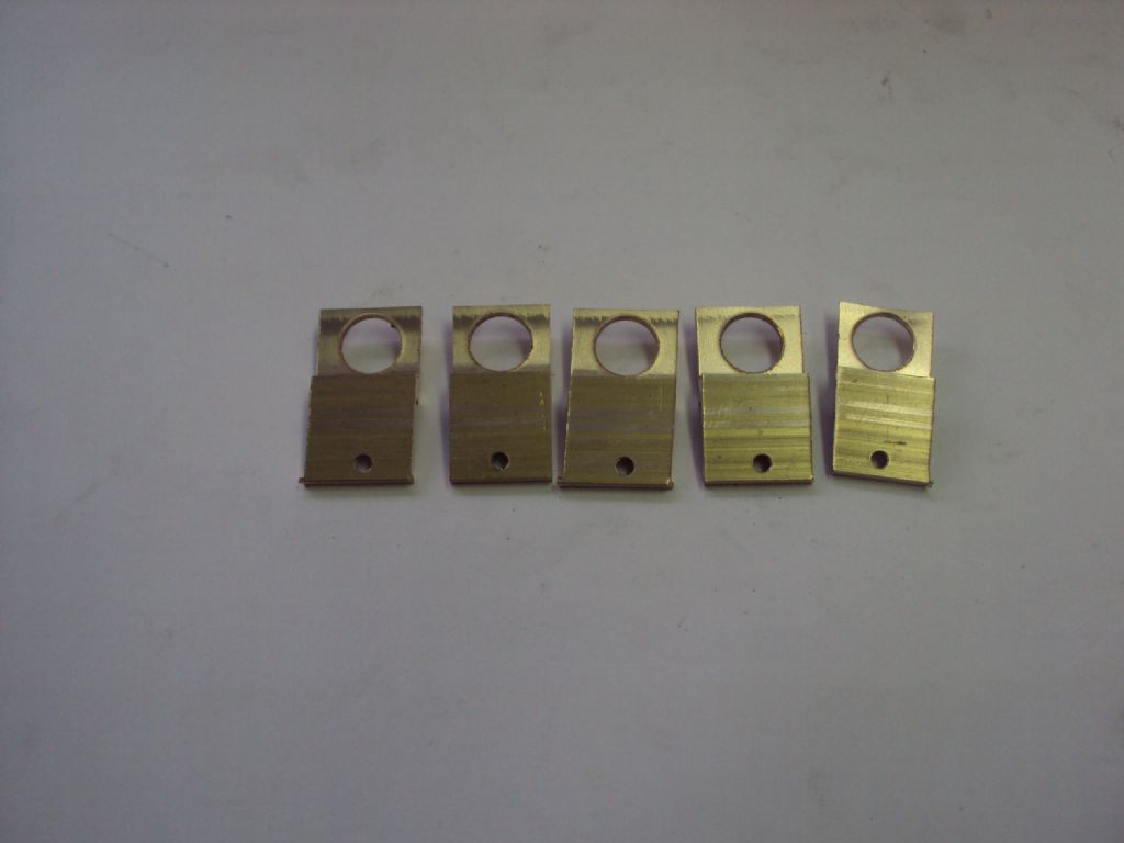

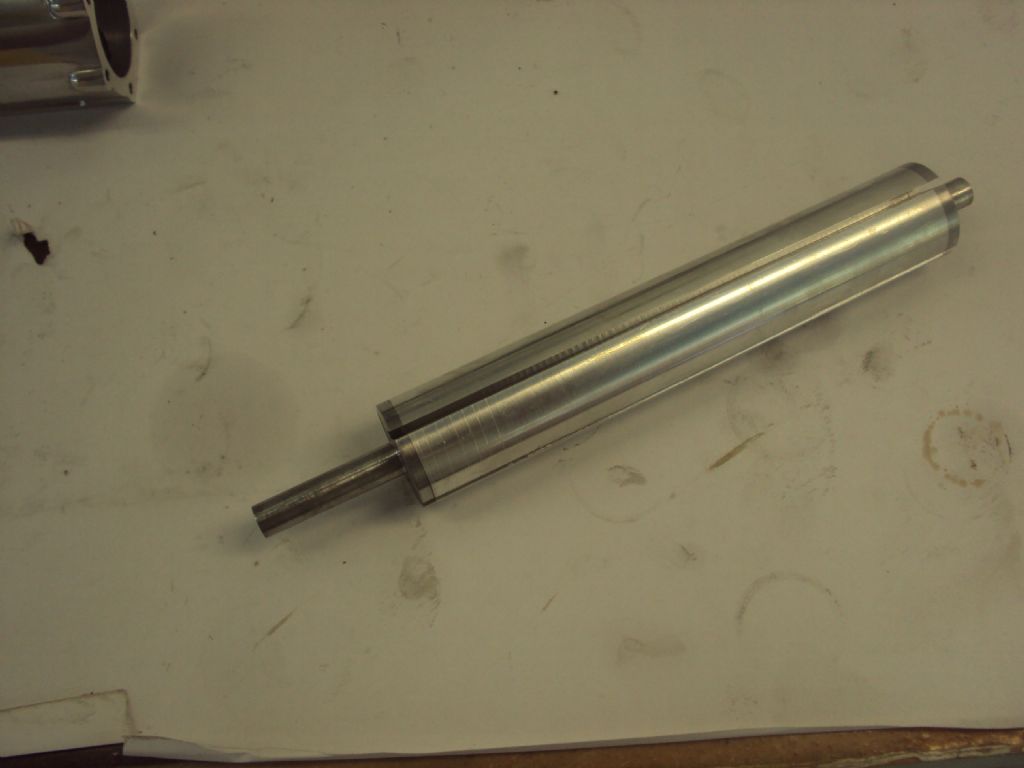

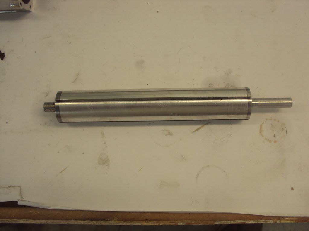

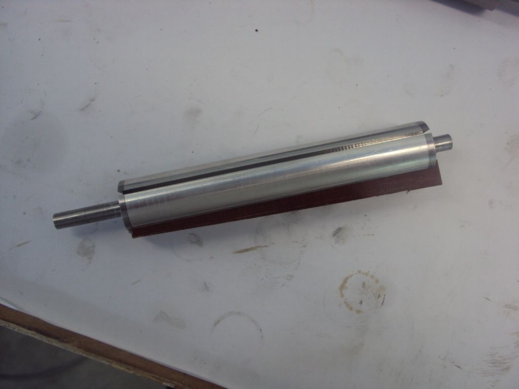

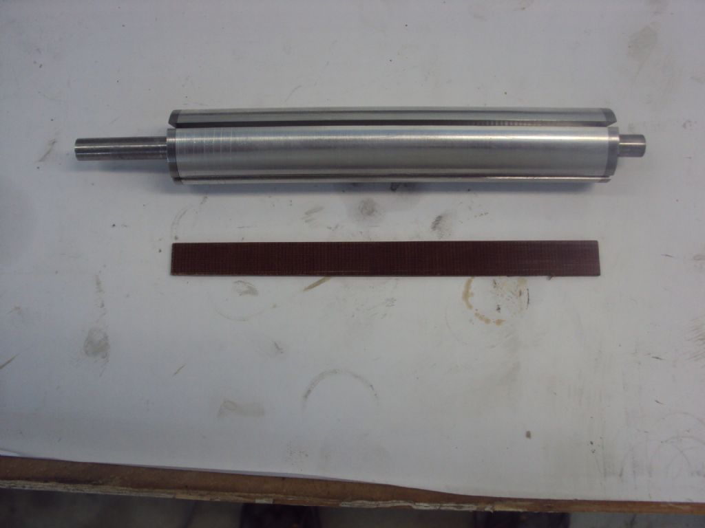

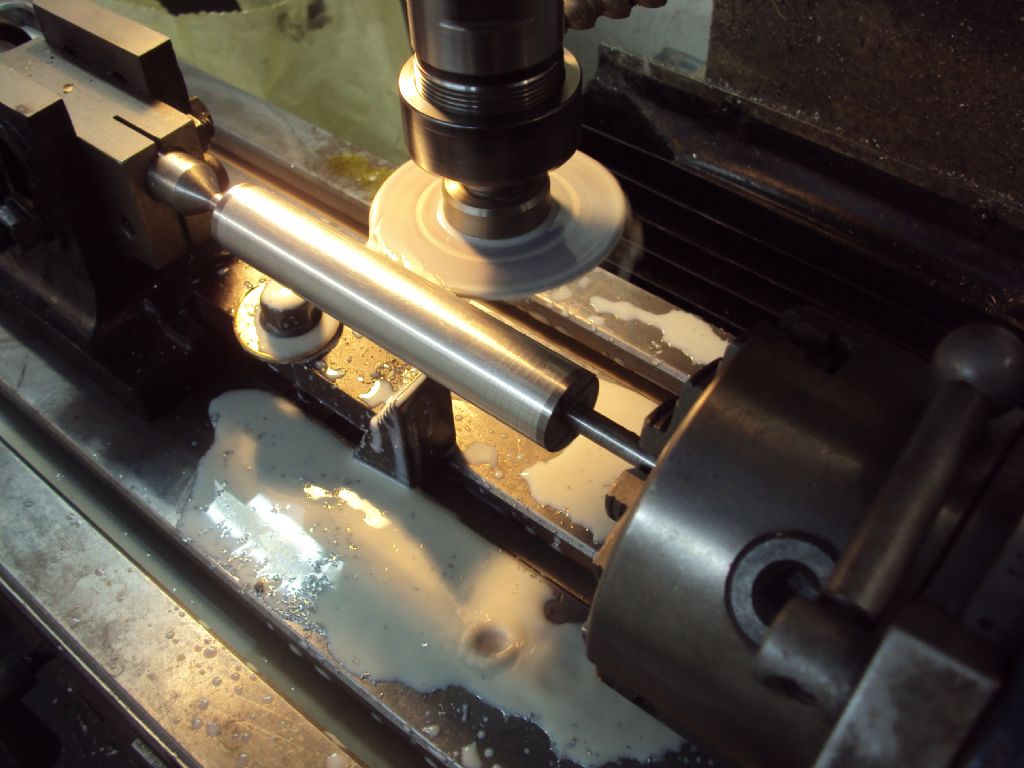

                        Well it's been awhile i know but I been kinda busy, but i finally found a roundtooit for this V12 project. Been working on the supercharger recently and have just finished machining the rotor vane slots into the rotor, took a bit of fiddling around to setup but got there in the end. All that's left to do now is polish the vane slots to allow a slippery slippery fit of the phenolic vanes.
                        here's some update photo's
                        Hope to have it all done in the next few days or so………………………………………..hopefully lol
                        Dean

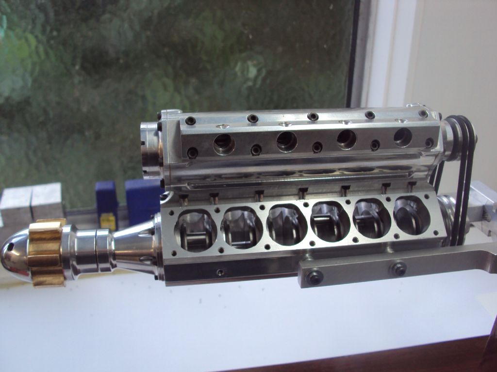

                            #172481
                            dean clarke 2
                              @deanclarke2

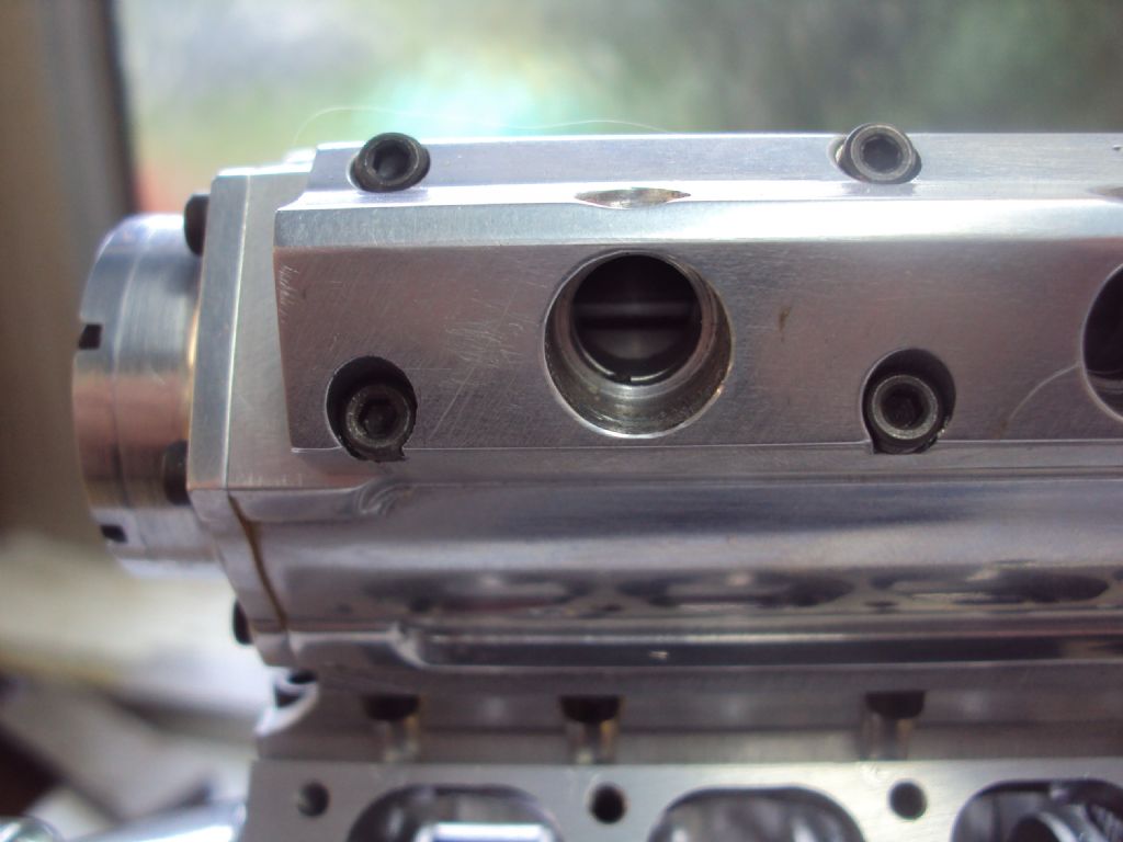

                              OK soooo………………….. I managed to find a few more roundtoits and have finished fitting the super charger rotor vanes to the rotor. They all have a nice and free sliding fit and good end clearance, made all the gaskets for the two end covers and the manifolds. Below are some photos showing the finished blower assembly fitted to the rest of the engine.
                              This photo is a view down the carb intake hole and shows the vane in the slot. Once I got the whole assembly together I couldn't resist trying the supercharger out to see how much blow it would give. I hooked up the starter motor to it and there was a very definate blowing of the air coming out through the sump holes in the bottom of the block!!!!!!!!!! Fantastic I would say!!! Quite a loud noise from the blower so I think it might have a very interesting sound when its running.

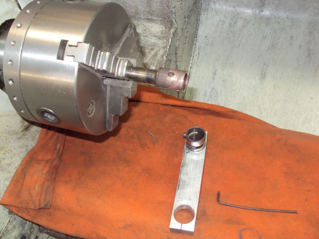

                              So the next step in the construction is the finishing of the liners. I have started lapping these using the same technique that Ramon describes in his ETA build thread. I have used this system before when i made the V8 (here's a link to the youtube video of the v8 being hand started for anyone interested. https://www.youtube.com/watch?v=Np7zvGrc3U0 )
                              The liners are firstly honed and then lapped with 14 micron diamond paste, then cleaned. When they are all at this stage the lap is then cleaned and reloaded with 0.5 micron diamond paste and all the liners are then brought up to a mirror finish before fitting the pistons to each individual liner making up 12 matched piston liner assemblies.
                              Here's a couple of photos of the start of the lapping process.

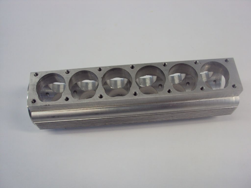

                              #172485
                                Posted by dean clarke 2 on 07/12/2013 04:12:58:
                                here is the first stage of the block.
                                Dean,
                                I have "quoted" your first two photos of this amazing thread, as a qick reminder of how it started.
                                Thank You for sharing your journey.

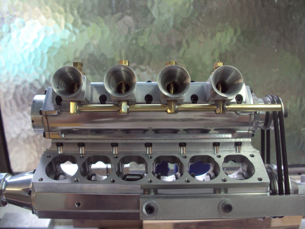

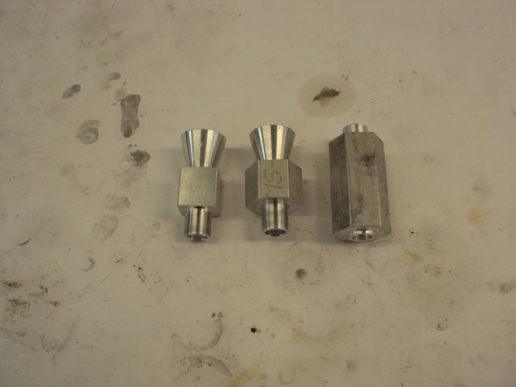

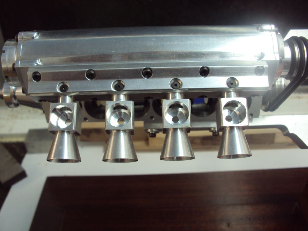

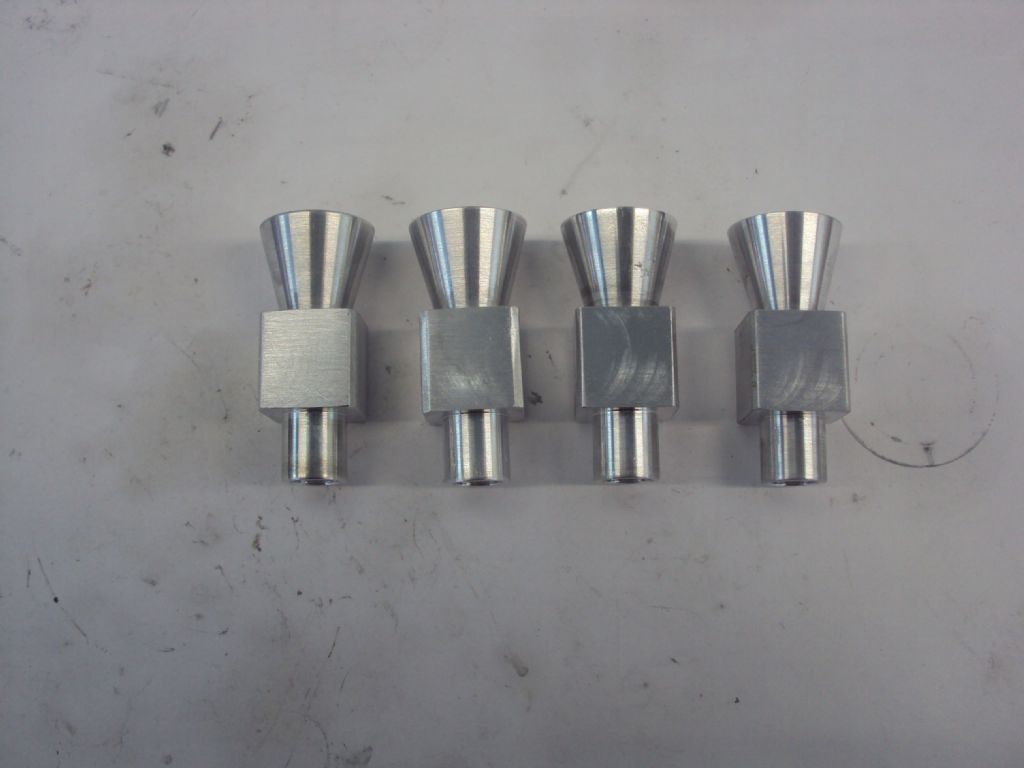

                                      #182509

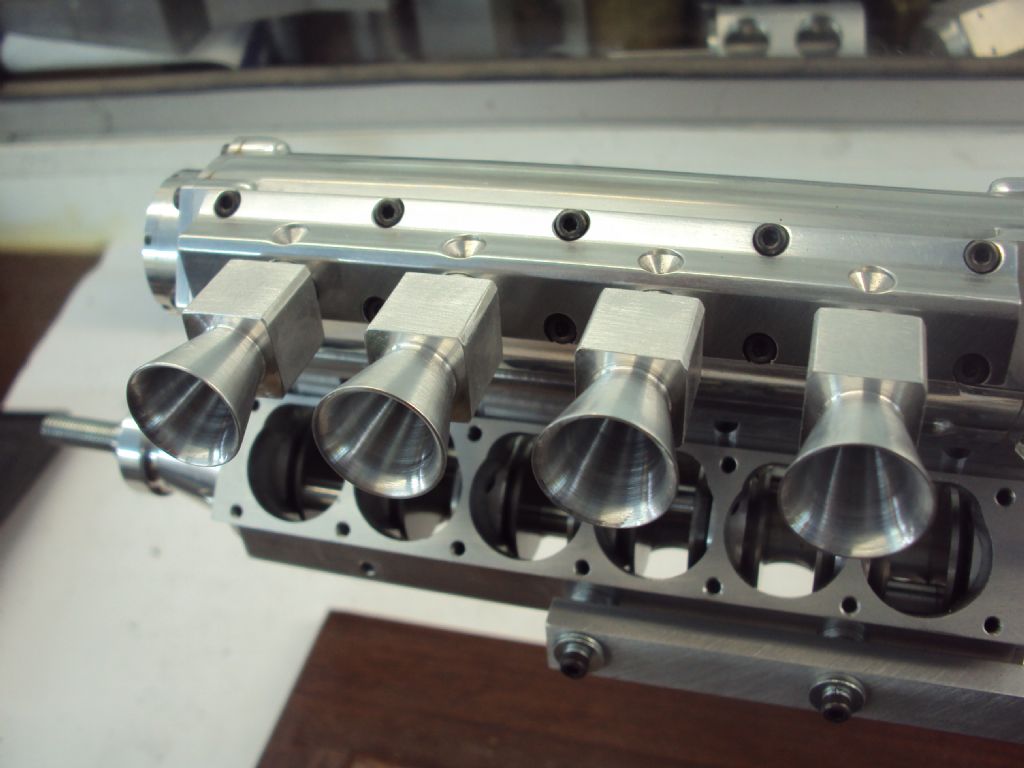

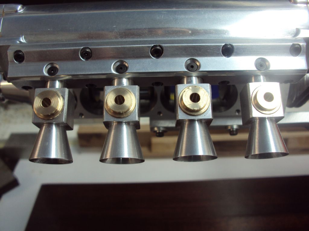

                                      dean clarke 2
                                        @deanclarke2

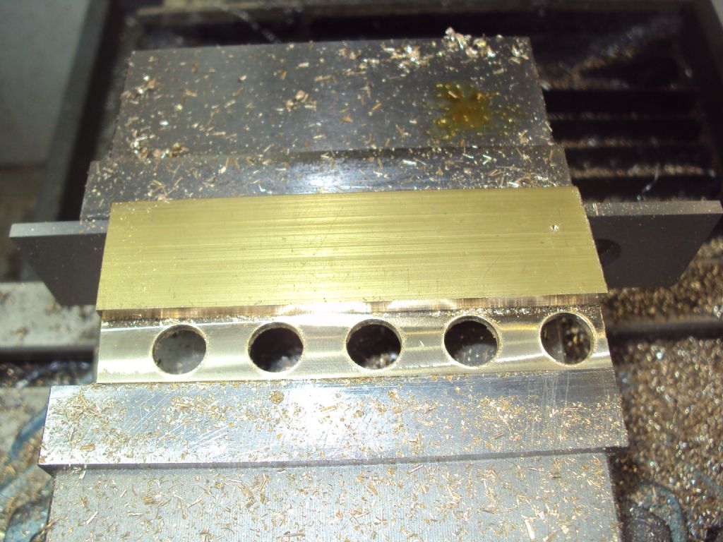

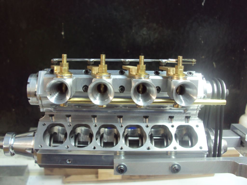

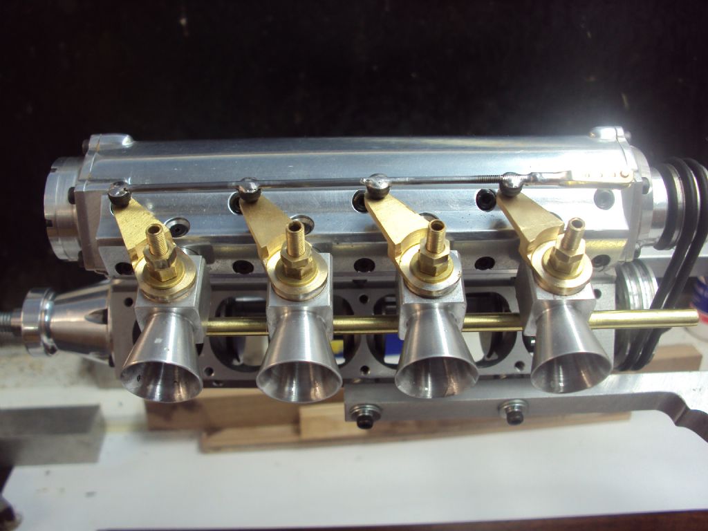

                                        Hi all, once again sorry for the tragically long time between updates, pressures of life and all that drama, but never mind I have managed to find a small bit of shed time and I have taken a break from the unimaginablely boring task of lapping 12 cylinder liners to save my sanity and have gotten on with the four carbs. I have finished machining the bodies and throttle barrels, fuel jets and fuel delivery rail. Photos below show the progress to date
                                        Well thats all for now, hopefully i'll find a few more roundtuits and get the rest finished soonish LOL
                                        Cheers for now
                                        Dean

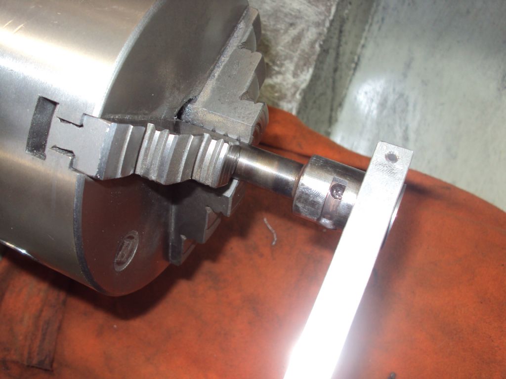

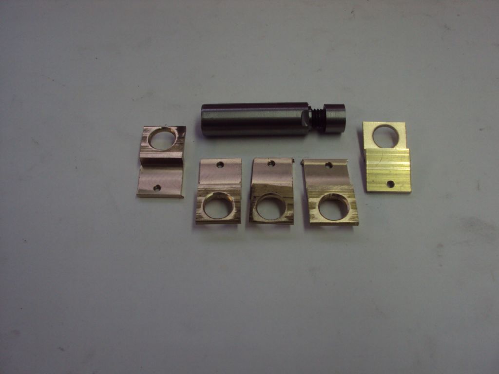

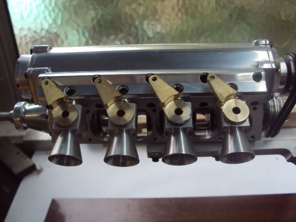

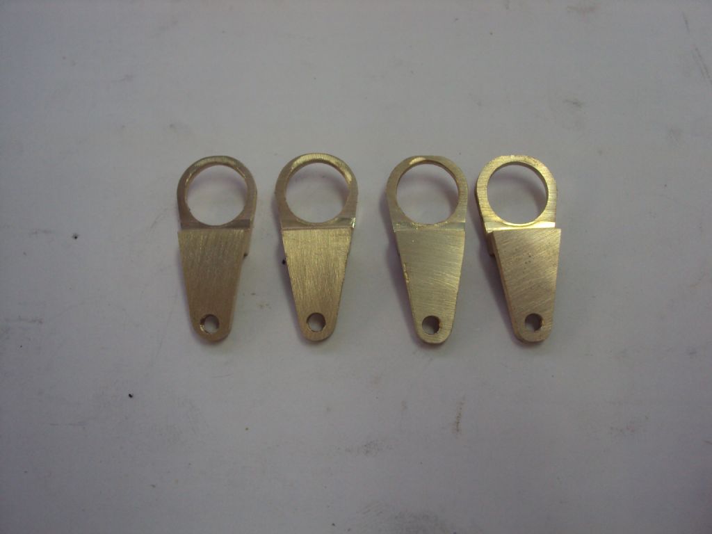

                                          dean clarke 2
                                            @deanclarke2

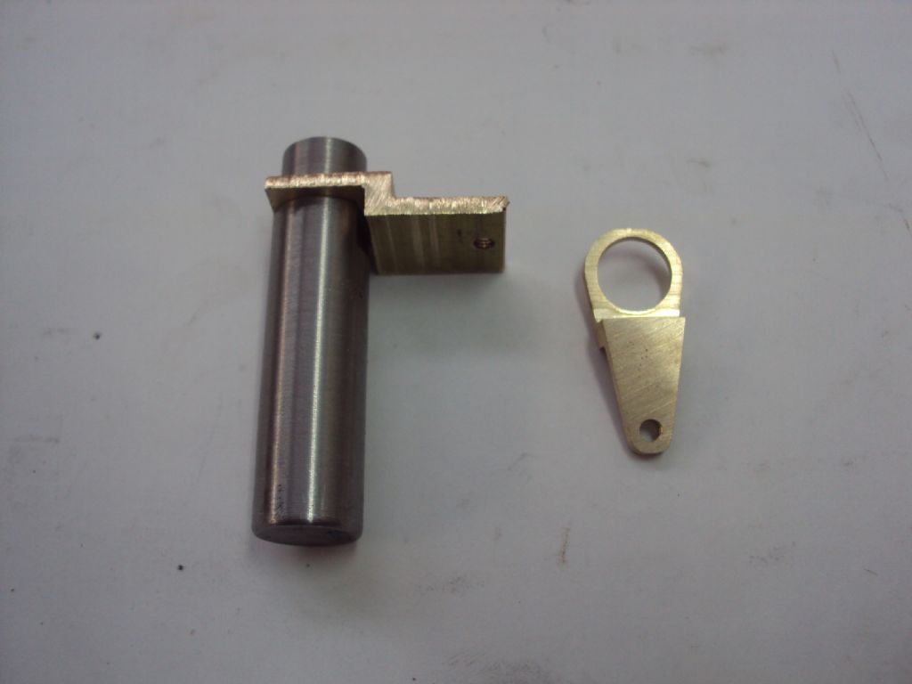

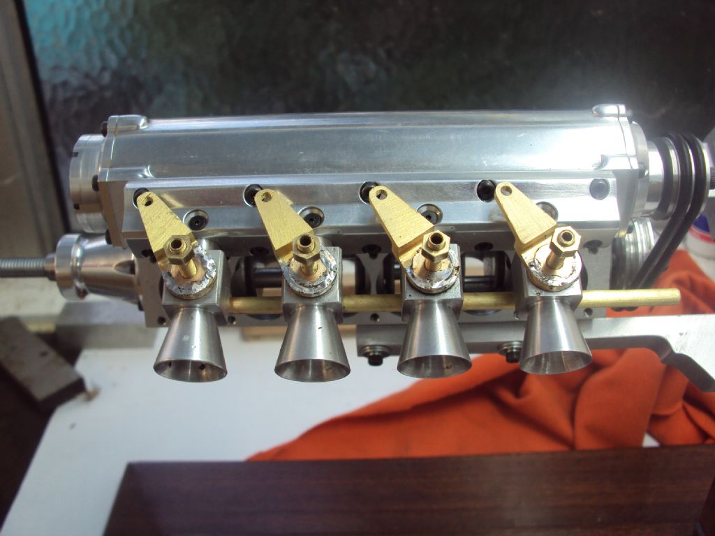

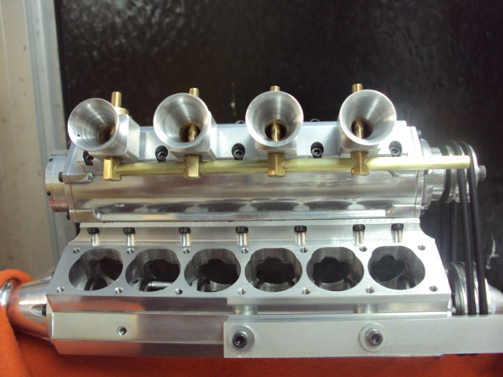

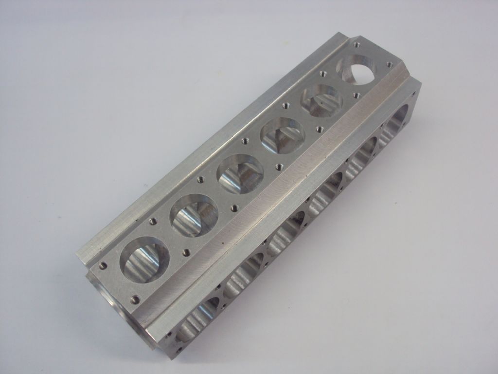

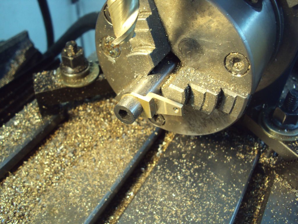

                                            OK So it's kind of a miracle I know but here is the next little bit achieved on the V12 build. I have managed to get the throttle levers built and ready to fit to the throttle barrels, then onto the throttle linkage system. Here are some photos for you………
                                            Hopefully I'll be able to get a bit more done this weekend
                                            Cheers for now
                                            Dean

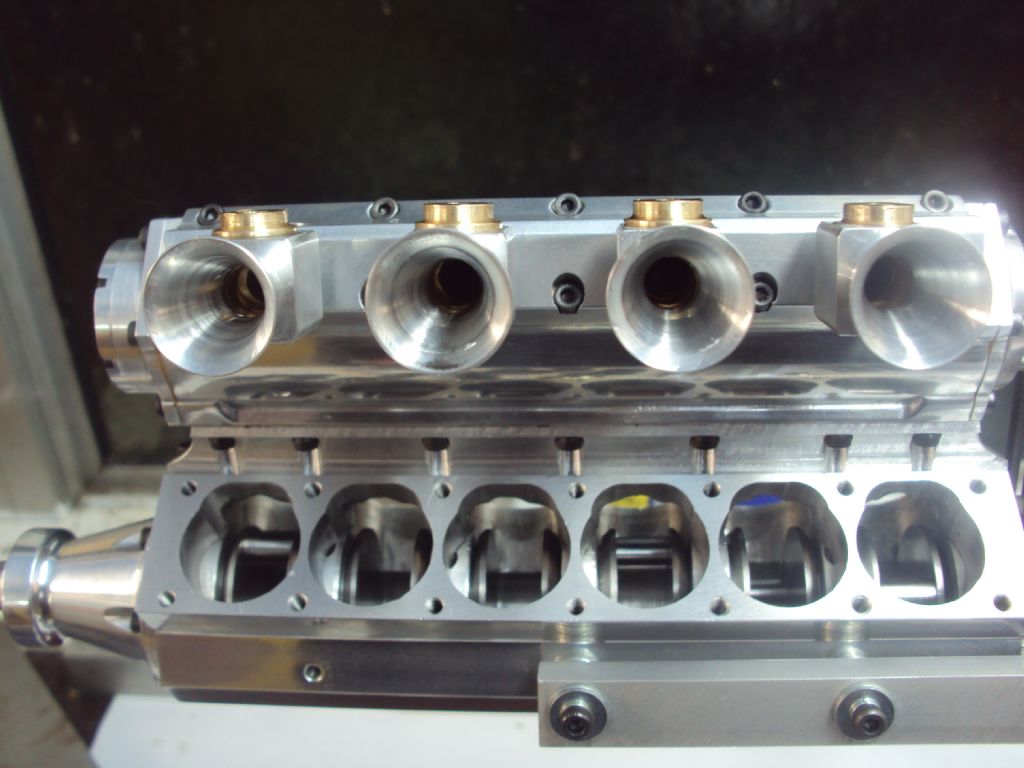

                                            #184794

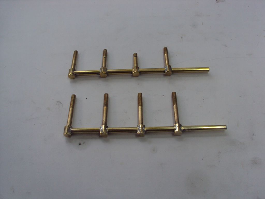

                                            dean clarke 2
                                              @deanclarke2

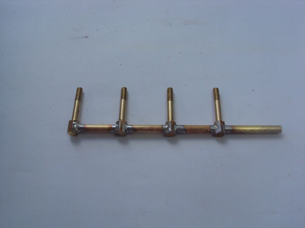

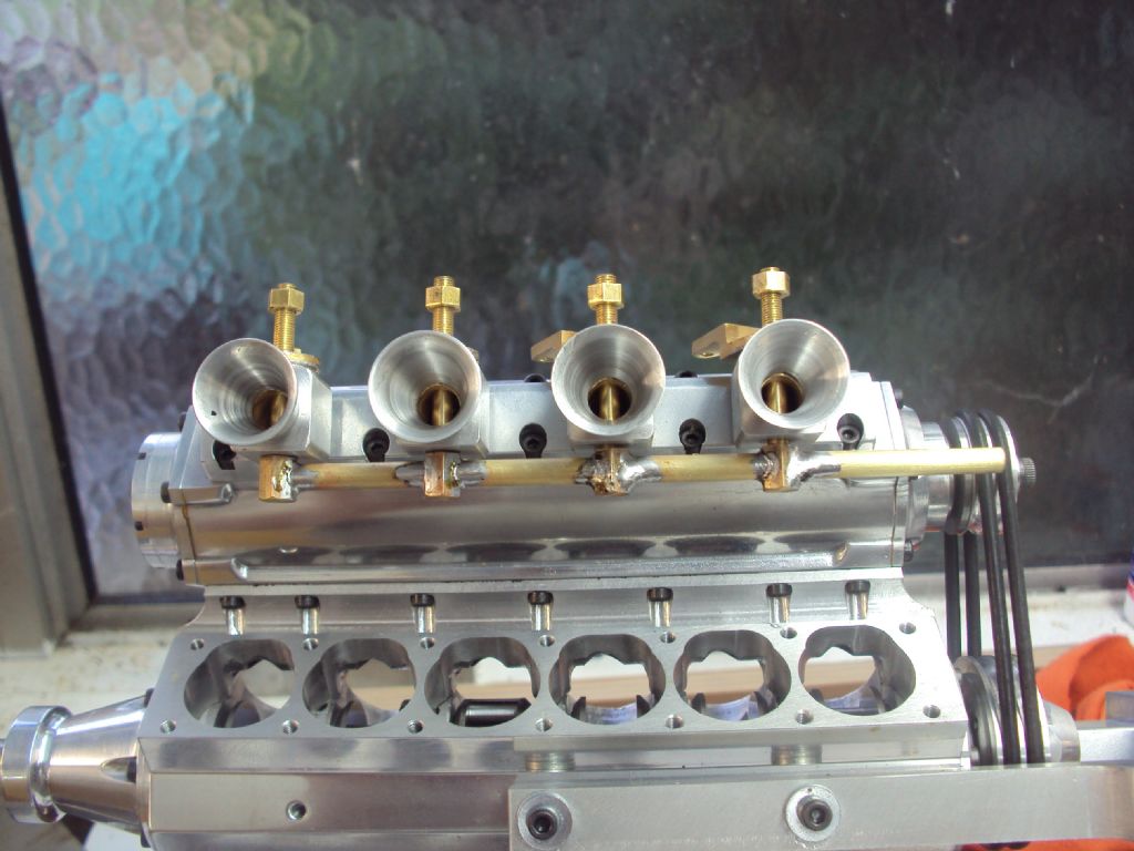

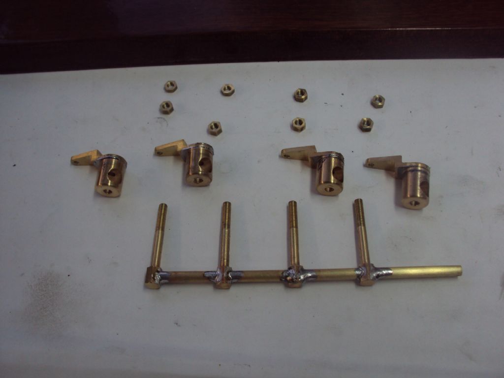

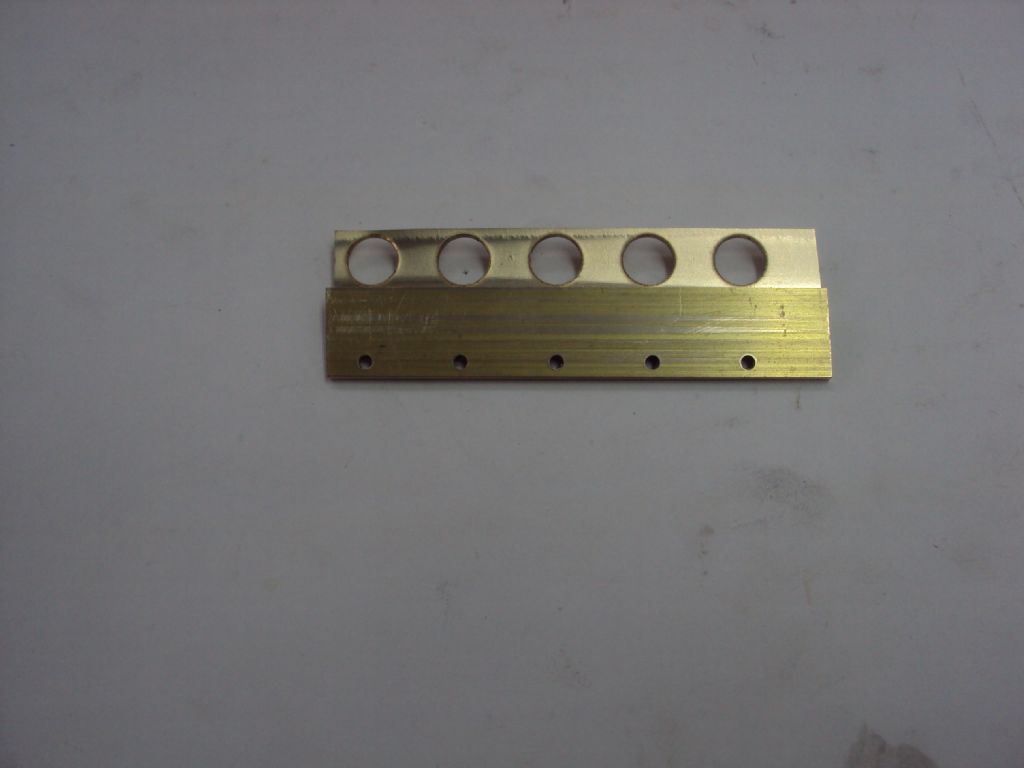

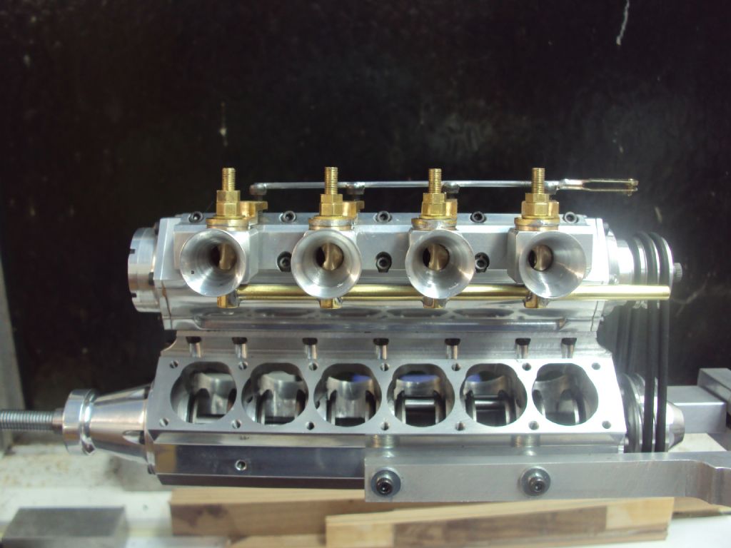

                                              Well progress has been somewhat slower than I had hoped and plagued with a few problems, but I guess if it was easy everyone would be doing right? I have managed to get the four carbs finished and the throttle linkage assembled but not without some frustrations photos below show some of them
                                              So those of you with a keen eye will probably notice the overtly shorter fuel jet in the top fuel rail, This was the first rail I made and it had been threaded internally for a threaded needle assembly, This proved to be a mistake as there wasn't enough meat in the wall thickness and the one became two!!!! bugger!!! Hence the second fuel rail redesigned for a needle carrier and not a threaded needle. Oh well live and learn I guess.
                                              This photo shows the new rail and the levers fitted to the barrels before being cleaned up.
                                              This photo shows the replacement fuel rail being test fitted, Who can see a small problem here i wonder?!!!!
                                              So here we have the finished article and although it hopefully looks all good there is a rather annoying large problem I discovered upon trying the throttle travel movement………………. as in it doesn't……………. move that is…………………… BUGGER!!!!!!!!!! I found the reason after looking at the photos. There is a slight difference in the height of the the fuel jet base after being soldered together. This meant that when the nuts were done up and the preload set it pulled the jets out of true inside the barrel, thus causing the barrel to bind in the carb body. I am looking at how to fix this at the moment probably just separate the jets and use silicone fuel tube in between each jet. below is a couple of photos showing idle and wide open throttle postions.
                                              Thats all folks will call again later
                                              cheers
                                              Dean

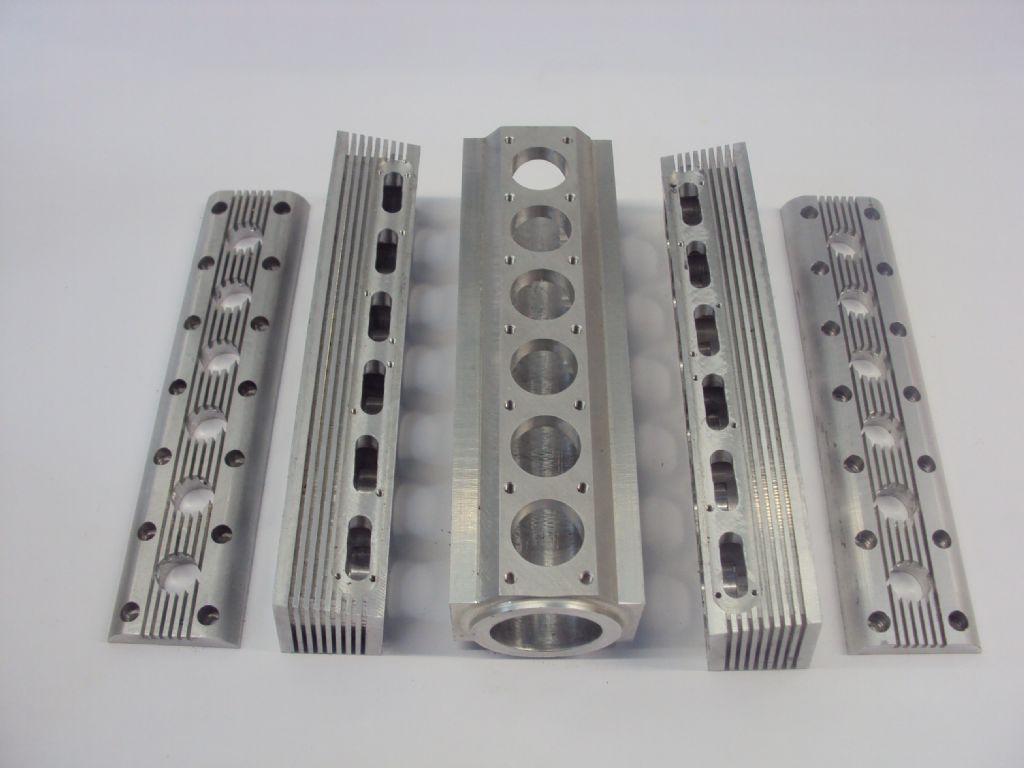

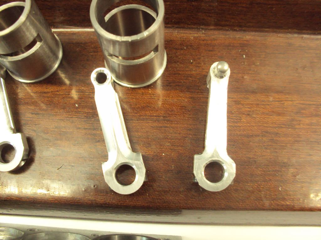

                                              dean clarke 2

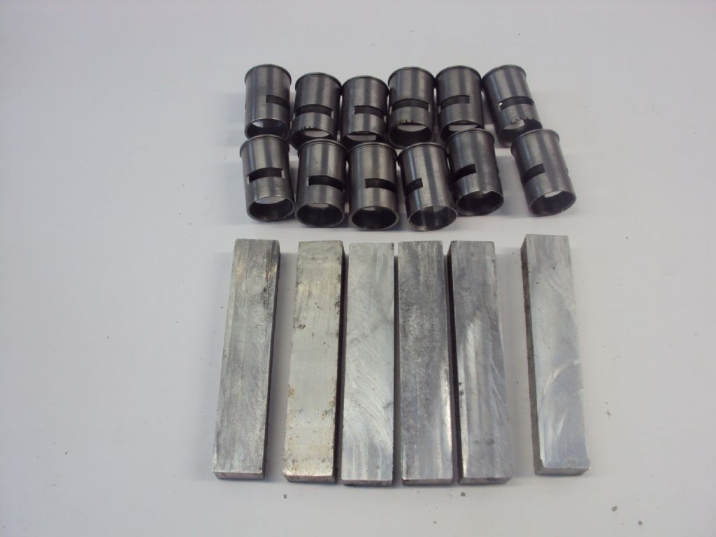

                                                @deanclarke2

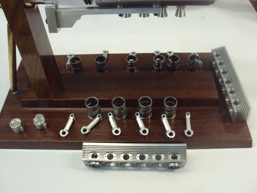

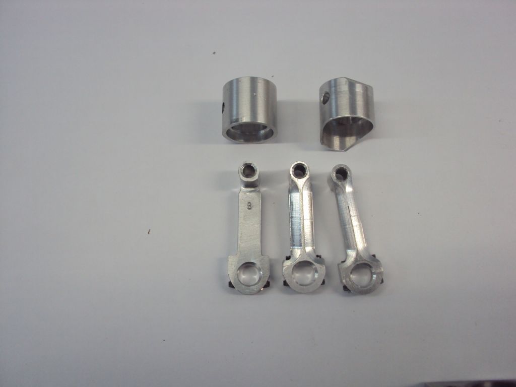

                                                Well, I'm still alive and kicking just in case anyone was starting to wonder?? Um been a little while since I updated this thread so I thought I should probably get onto it. So here it is, the next installment of this build. Having gone slowly mad trying to lap and polish 12 liners I have finally been able to finish this step of the build. I have also managed to make a pattern piston from ally to figure out the final dimensions of the pistons. This was somewhat of a frustrating excercise but I'm glad to have done it now as I think I have managed to get it sort of right at last.(joys of scratch building without any drawings lol). here's a photo of the progress to date including a couple of further mods to the conrods.v12 liners and rods (1).jpg
                                                This last shot shows the development of the conrod profiles to get them to rotate through the full cycle without fouling on the piston anywhere. The piston on the left was the first try and the one on the right is the final design ready for machining the cast iron pistons, which is the next step in this long drawn out saga of a build. Apoligies for taking so long but I have been sidetracked countless times with work and home demands. Also there is another slight confession I have to make……….The cylinder block at the start of this thread is actually the second attempt at said part…… the first one was almost left as scrap after i accidentally machined one cylinder bank off while milling in the valley section of the block, luckily I hadn't started on the sump side so I just put it aside and made a new one. However being the tiger for punishment and possibly slightly rattly in the head I had another look at it a while ago and prompted by the comments from some about fuel consumption I thought I'd salvage it into a flat 12 engine block and build it the same as the v12 but naturally aspirated. The flat 12 will be identical to the v12 in everything except the fact that its a flat instead of a vee design and it's not supercharged, The cylinders are setup in the same matched pairs but will be running on separate big end journals so that each pair will reach tdc simultaniously, the crankcase being sealed into individual compartments by the center main bearings. Below are some photos of the progress to date……….. Once both engines are finished and running I'll be able to do a few tests on fuel consumption and power output..
                                                And yup thats another set of 12 liners to hone, lap and polish…………… someone shoot me will ya.
                                                Well thats it for now I'll try and be a bit more onto it in future
                                                Cheers for now
                                                Dean
