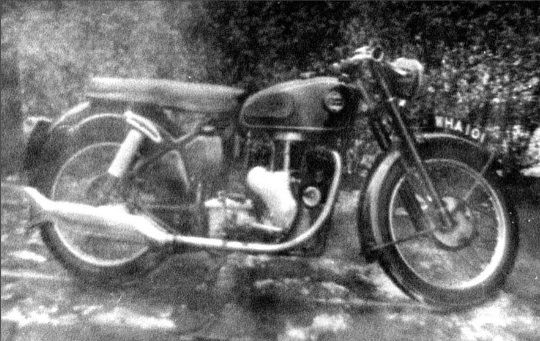

              Ian Abbott
                @ianabbott31222
                This is the only photo of the '54 Velo. Boy, did we have fun. Purists will notice that it has a later tank and seat and Ace bars. Done before I bought it. Someone had also modified the innards, so it was a sort of 500cc MAC not 350cc. I'm sure that other stuff had been done and it pissed off a lot of Triumph riders who thought that they had a chance…..

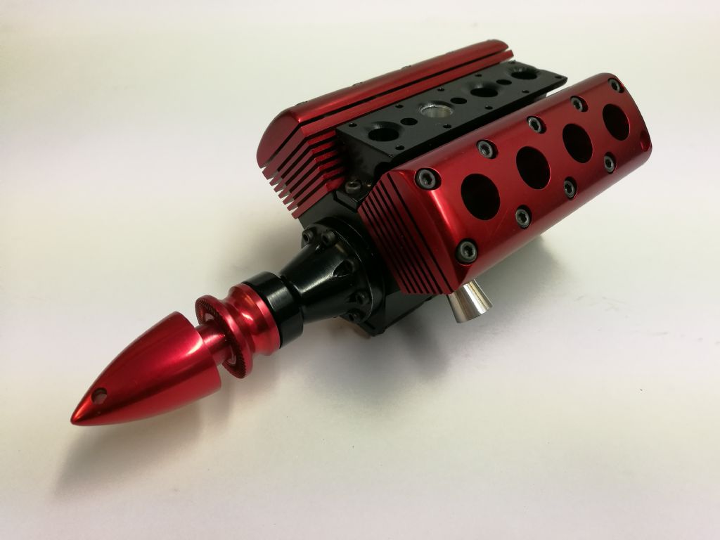

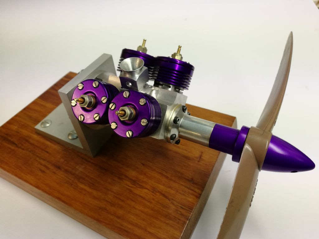

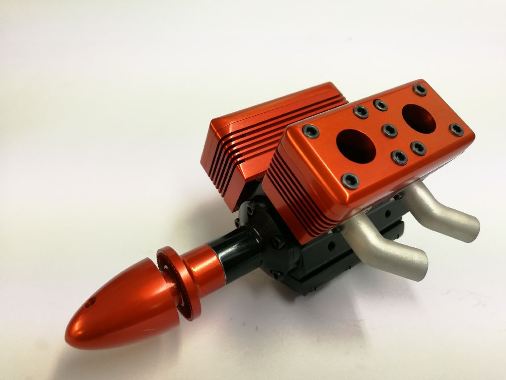

                                      Well let me start with an apology to anyone left hanging from my last post to those of you have have just flatly fallen asleep from boredom waiting for another update. I have been somewhat sidetracked with this project with trying to catch up with some previously started projects that have been left wallowing in despair at the back of the shop.
                                      Photos below show the causes for the delays.
                                      I should have the V12 running again in the next couple of weeks.
                                      Cheers for now
                                      Dean
