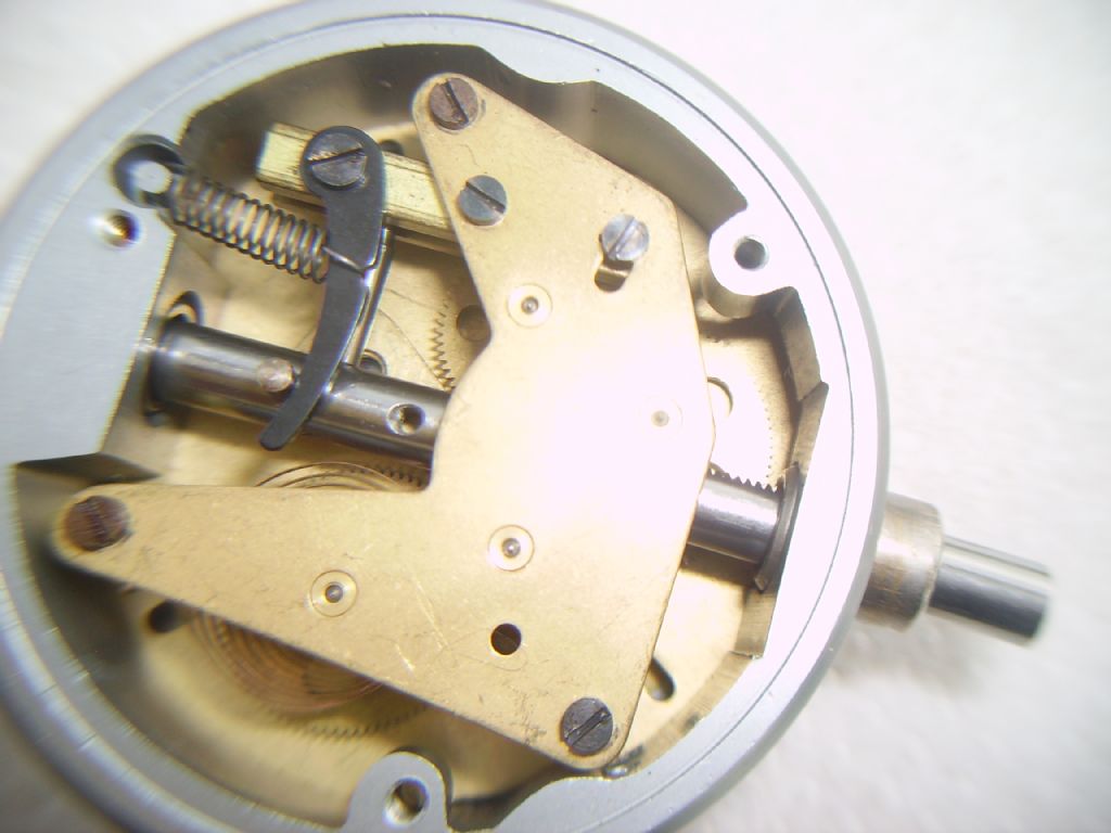

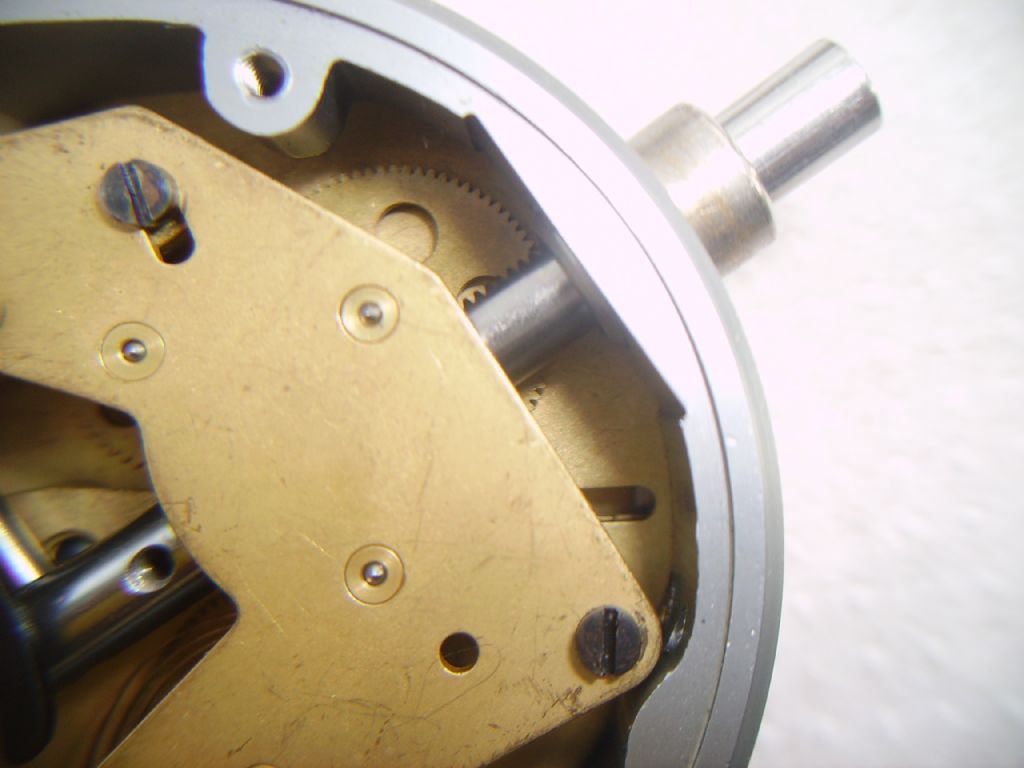

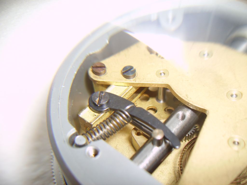

                                            Near 4 weeks have passed and with paraffin, petrol, methylated spirit and liquid butane all tried and had the gauge in a sealed tin with the back off for a week over paraffin fumes the gauge moves stiffly but it still will not move under the return spring power.
                                            No corrosion to be seen and no evidence of damage using when viewed with a big magnifying glass so any more ideas before dismantling to look for further stickiness.
                                            #234771
                                              You seem to have tried everything reasonable … short of dismantling it and cleaning it like a watch.
                                              My guess is that either the pivot holes are gummed-up with oxidised oil, or the plunger is slightly bent.
                                              Can you show us some detail photos of the mechanism ?
                                              Edited By Michael Gilligan on 15/04/2016 22:04:07

                                                  Photos of the mechanism will be job for tomorrow, will hang on in case the pictures give any further ideas before dismantling as my pound of sausages shape and sized hands could do damage to the poor thing.
                                                  #235028
                                                  Dod
                                                    @dod
                                                    #235029
                                                    Dod
                                                      @dod
                                                      Master of the blurred photo mesad
