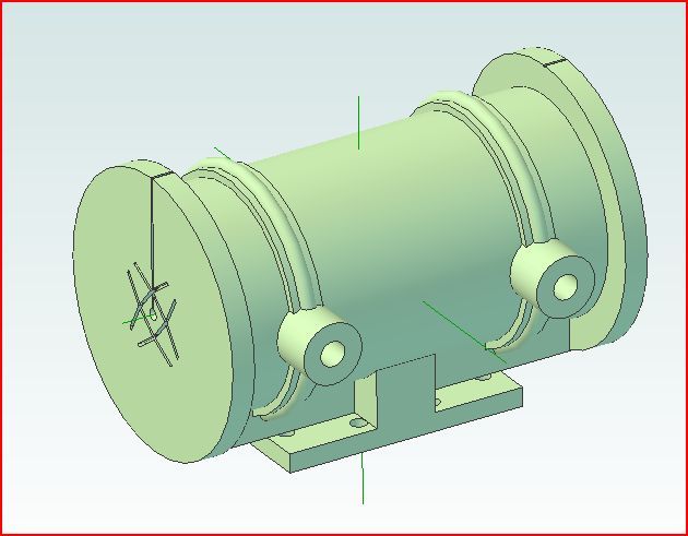

                  I think I would only do the arc, 2 "D" shapes and the angled cuts on the feet and get them fixed in position, leave trimming to O/A length, the stepped bottom and the 4 fixing holes until the cylinder has been bored then you can pick up it's position and get the heights and hole positions set from there. Basically create the "casting" first them machine it
                  I don't think the step on the bottom is to provide sideways location as at 1 5/16" it's a lot narrower than the gap between the bedplate casting which is about 1.400". Most likely there to stop the feet becoming too flexible as there would be little material left if they were just flat bottomed.

                          Another option to plugging the ends is to stick a thin bit of scrap sheet to the ends with hot melt glue, I use this quite often when there is a hole where I want to put a mark such as the ecc strap on the Victoria.
                          #550767
                            Just to add, if you are not familiar with the usual way to find the ctr of the casting then striking 4 arcs of aprox half dia will get you close and you them place your ctr mark in the middle of the arcs. If you don't have odd leg callipers then find a bit of bar aprox half flange dia and use that to scribe 4 lines with bar and cylinder on a flat surface. If you have  ascribing block or height gauge that can be used too do the same sort of thing.

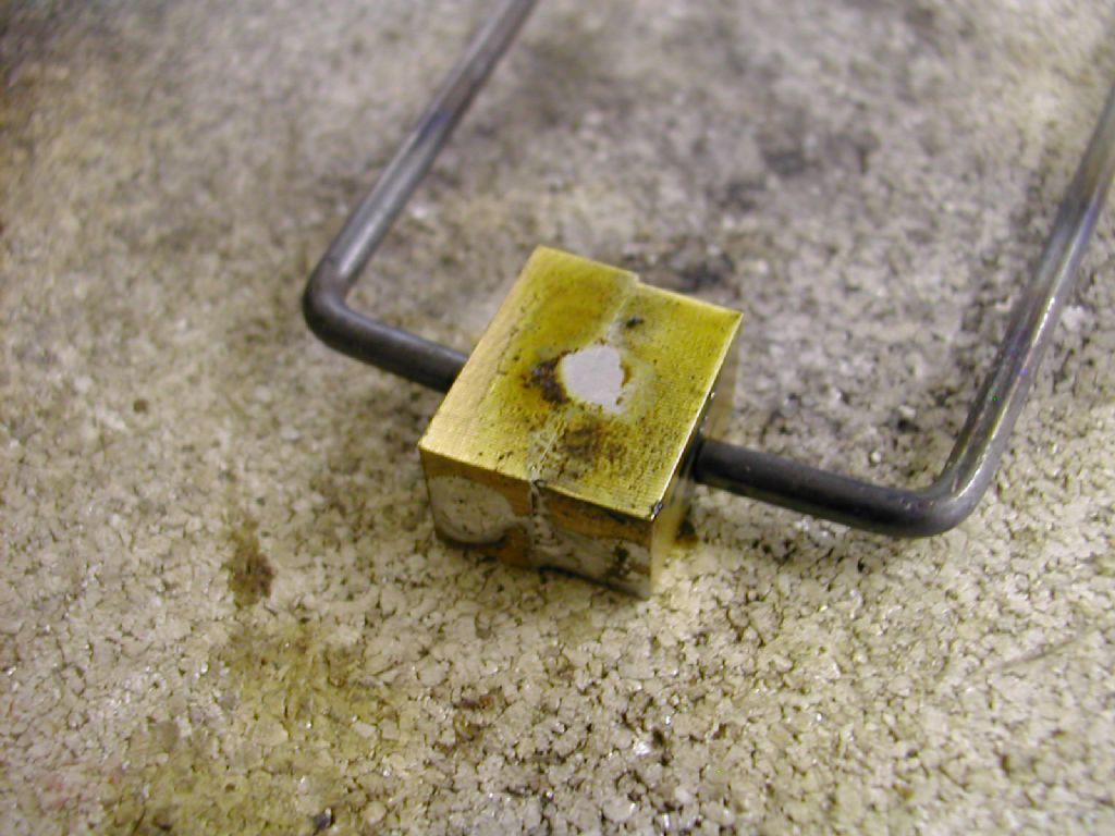

                                                Also divided the 1/2” square bar up for the feet. Just enough in the end, using short middle bits:
                                                I milled them to consistent lengths, and they are a bit oversized so I can trim them once fitted:
                                                Didn’t have much luck soldering them together, the solder only seemed to capillary into a tiny bit of the cleaned and fluxed joints. I tried to tin the mating faces, but they weren’t having any of it…a slight tap saw them fall apart…
                                                Perhaps the wrong flux, or not enough heat (propane/butane mix)?

                                                  that flux should have been ok so probably not enough heat to get a the metal upto temp. Tin and sweat is the best method

                                                    How were you holding the pieces together Doc? As Jason says tinning the faces is best but the parts need to be in sufficient contact without being too tight together.
                                                    You could try this – a piece of 14-12 swg piano wire bent as a two pronged clamp. Gives just enough pressure to allow the solder to flow. Well flux the parts and put a blob of solder across the joint then heat gently and uniformly until you see the solder flow
                                                    Idealy it wants to lay on something non heat absorbent – this is a piece of Skamoflex -perfect for this sort of op.

                                                      Thanks both. I was using screw clamps, with flux between the parts, and heating each joint and dabbing with solder until a blob formed, and – sort of – ran into/around the joint. I guess it was too tight a join.
                                                      I did wonder about some kind in sprung clamp in conjunction with tinned surfaces, but never got them tinned in the first place.
                                                      Not sure I’ve got any insulating material. I tried to retain heat by doing it on wood, but of course it started to smoke. Maybe an old concrete block?
                                                      Anyway, I’ll try again tomorrow with piano wire. Cheers.
