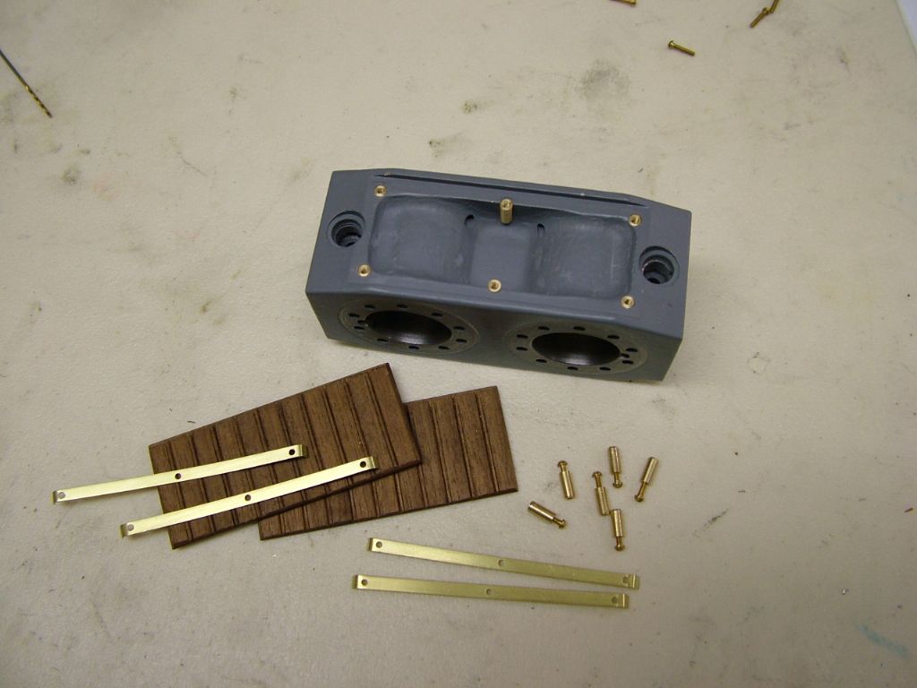

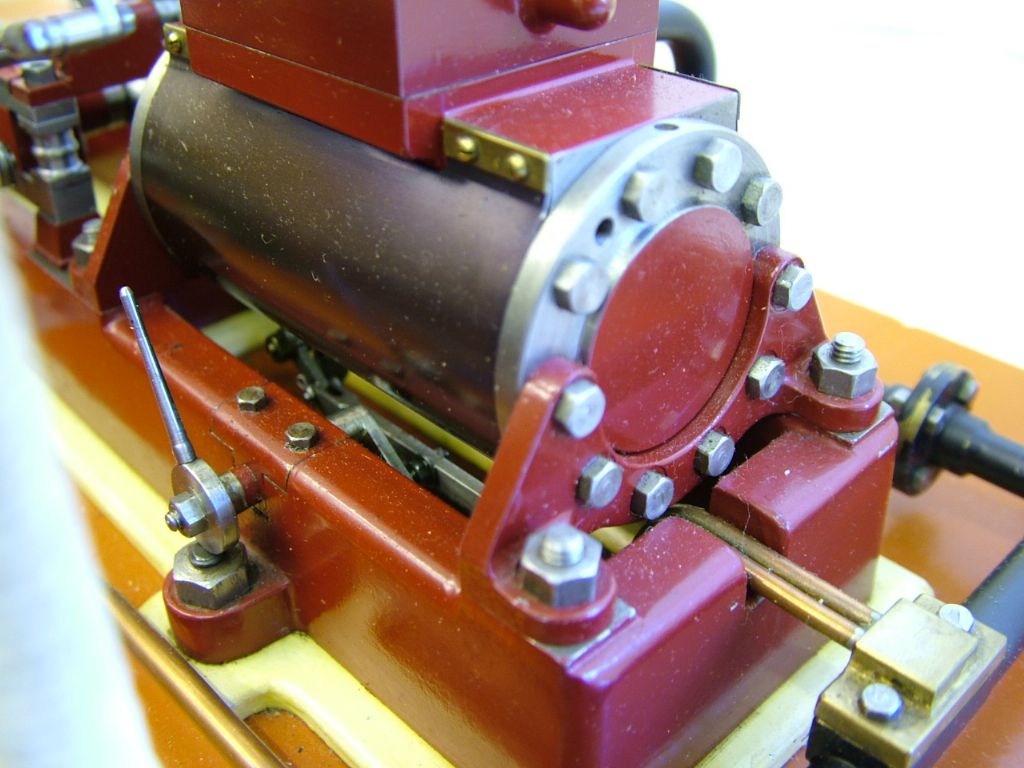

      Nothing wrong with using aluminium save one thing – impossible to get a colour on it as on steel. There was coloured ali available but to me it does not have the same look as steel – depends on how you see the finished model representing full size.
      Tempered shim steel is relatively easy to work – I use a ground hacksaw blade to scribe (score) and gently bend to break along a line. It can also be cut with a jewellers saw filed and drilled without issues and even milled if held down properly – clamped between two sacrificial pieces of ali or steel.

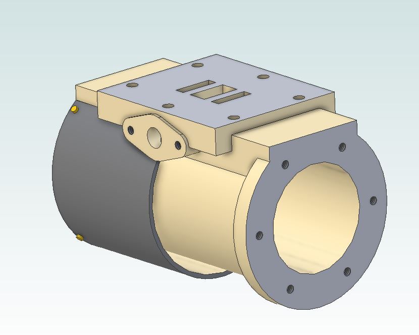

      I made the lagging in one piece held with small section brass strips at the top edge.dscf0433.jpg
      #531573
        I think you will have to do it in two pieces as the modified cylinder "feet" will not allow a single sheet to be wrapped around the cylinder so maybe something line this (feet not shown)
        #531582
        Ramon Wilson
          @ramonwilson3
          Ah, I'd overlooked the feet modification Jason – I think I'd be inclined to do it as two halves though with the split line along the length underneath with cut outs to clear the feet.

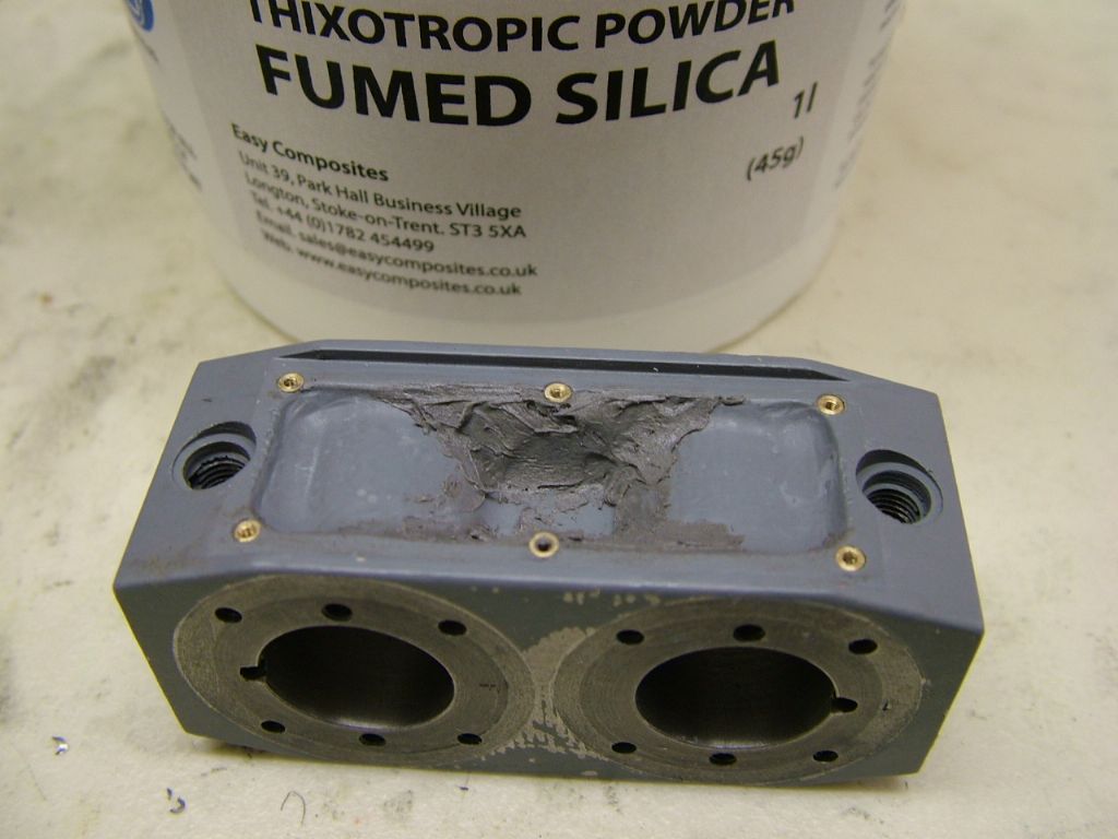

                  Also – if using very small brass BA screws (14/16 BA) as fasteners – it's a lot less stressful to drill and tap small individual brass inserts in the lathe and fit them to suitable holes in the casting rather than drilling and tapping the casting itself.
                  Now that is a cunning idea! Do you then Loctite the brass inserts into the hole in the casting?

                    Hopper, Nothing cunning about it just an idea born of the same fear of yourself – breaking the tap!
                    Yes the parts are loctited in – they are tapped blind so that the loctite does not enter the thread. I shall be doing this on the latest build in due course.
                    Here's some pics of the Double Ten rebuild which Doc G may also find of use
                    This looks far messier than it was- I used the silica powder to thicken the JBW into a thick paste to reinforce that central bush

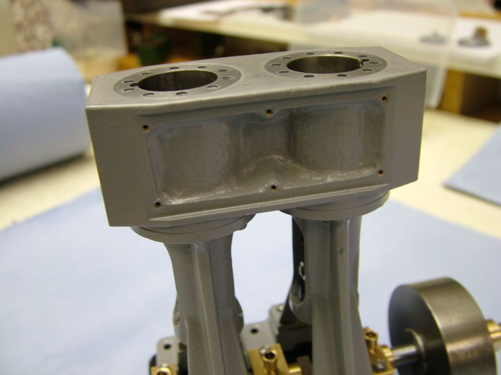

                    and once fettled
                    Hope thats of use to both of you

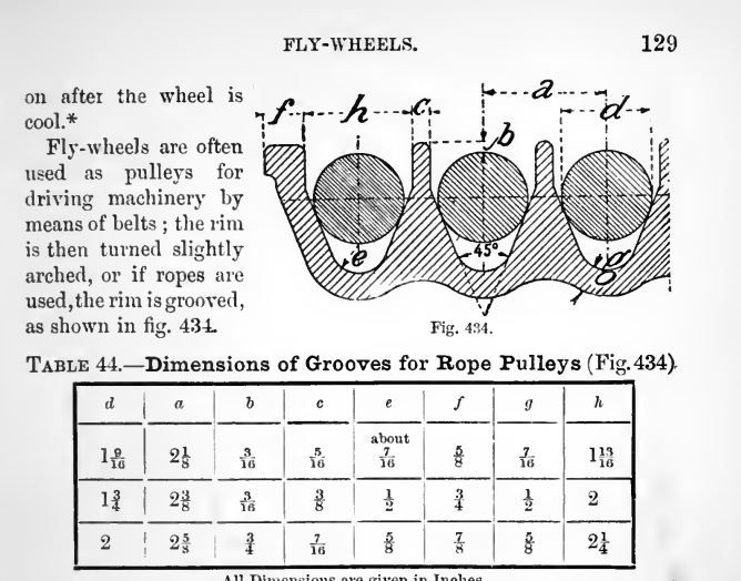

                            Talking of minimising risk of messing up a casting – I’ve been reading about the procedure for getting the rope grooves in the flywheel.
                            I can see me screwing this up, but I’ve seen some examples with a separate band – with the grooves – fitted to the o/d. I think I might do that, because I also like the look of a thin band of different material around the circumference, maybe slightly overhung with a chamfer on the inside?

                                  Unless it's cast material then a ring will not have the right 'colour' if it is a scale effect you are wanting. Personally I would not go down this route as that's a deep ring to get aligned over two flywheel widths. Not saying it can't be done but it has potential difficulties especially if it gets locked before fully in place.
                                  Grooves themselves are easy enough to form but it's much easier if you gash the grooves first with a narrow tool then use a form tool rather than try to do it all in one. The latter usually leads to chatter and needs very slow speed to possibly prevent it.
                                  I have a feeling that somewhere I may have the tool I ground for mine – if I can find it you can have it. I know I still have the form tools for the cross head spacers – so you might be in luck.

                                          All you need to know about rope grooves though as Ramon says those ribs between the grooves would not scale well and likely break up.

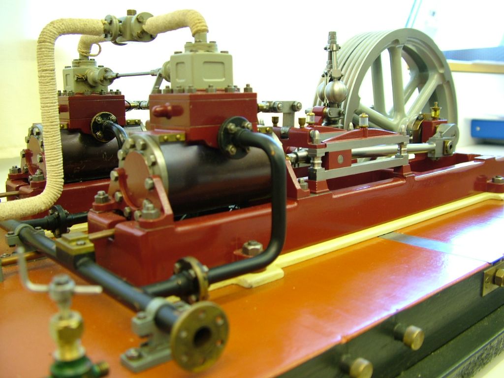

                                          It's a single Victoria that I am doing and will be quite close to how Mr Stuart intended, No photos or thread yet, I will wait for the change in forum software.
                                          I was talking of replicating the look of the traditional blued steel or "Russian Iron" used to clad cylinders, It's a blue brown much like the darkest of temper colours with a hint of the underlaying steel so would need to be done with a transparent acrylic which is probably more something I'm used to with artwork than model making where opaque colours tend to be used more even if diluted to washes.

                                            I thought the Princess Royal was more to scale with its 12 grooves? It does mention the flanges being very fragile, which is why they were omitted. The drawings show 40 degrees included angle, not 45, but minor detail.

                                              I'm not familiar with the PR layout – I was referring to the original Stuarts drawing. Twelve grooves would be much more in keeping.
                                              It appears there are several angles of rope groove depending on source. Spooners machine construction gives 40 degrees with flanges and 30 degrees for ropes up to 1" diameter without. Personally I'd go with the 40 degrees – 30 would look too fine and 45 may raise the chatter problem though doing each side of the groove separately would ease that issue.

                                                  Looking at full size the clading sheets are not always left with the blued finish, quite a few are painted in the same colour as the rest of the cast metal or even a contrast. So that is another option.

                                                    TBH I was going to keep the Meccano dark blue and satin black scheme from the 10V. Same blue for the Minnie. Yes, I know its not very adventurous, but I like the contrasts with steel and brass, and it would be a kind of signature finish for the three models I’ll end up with. I noticed a couple of other 10Vs in blue on the forum recently, I think one might have even been the exact same paint. Usually they’re green from what I’ve seen online and at the couple of shows I’ve been to.
