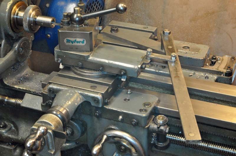

      Posted by Roderick Jenkins on 12/12/2017 15:32:32:
      This one was made by the previous owner of my lathe. I believe it is the Mason design as mentioned above. It works very well.
      HTH,
      Rod
      From another thread. Illustrates my garbled description above. I must get around to making on. Handy for graduating dials etc too with a couple of depth stops.

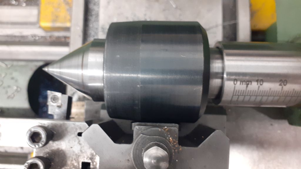

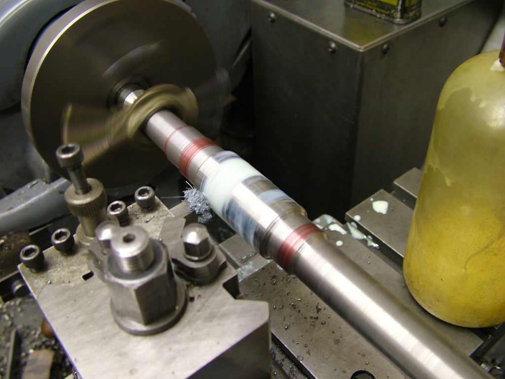

          So regarding the crankshaft. Following Ramon's advice, I had a go at grinding an HSS tool. It's not pretty:
          But somehow it did give a very good finish, at least until the 'step', when it chattered like mad. I tried increasing the relief at the sides, but to no avail. Also tried slowing the speed a bit, but again no luck:

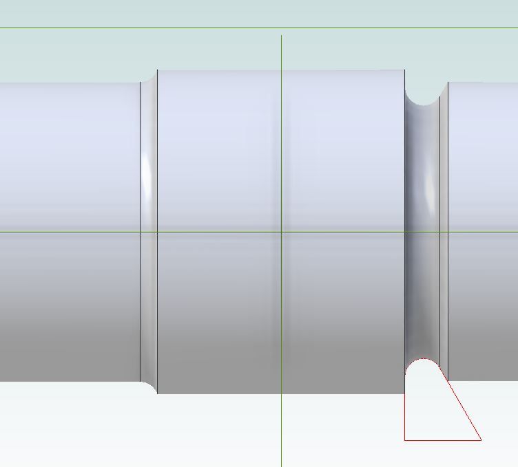

          Something I've never been totally comfortable with was turning to dimension in the Z-axis. Diameters aren't much problem, but specific lengths I've always struggled with in the absence of a DRO.
          This is the basic geometry of the shaft, not checked the dimensions, but they're about right:
          So, what's the procedure for getting accurate lengths, and the undercut bits?
          Do I somehow angle the tool so that the left edge is perpendicular to the Z-axis, turn to diameter, move along to a scribed mark, the feed inwards and hope for the best?
          Also, it was mentioned previously to work at the tailstock end, and turn the shaft to enable both ends to be finished. Presumably this is after the central portion is initially turned to size?
          When swapping the ends, is it OK to put the carrier on finish machined diameters (maybe with a thin aluminium packing piece), or should the bar be significantly over-long so that the carrier tightens onto a bit that's cut off later, when finishing to final length? I want to face off the centre drillings to leave clean faces for this one anyway.
          Thanks.
          #611136
          Ramon Wilson
            @ramonwilson3
            Doc,
            The edge faces of the tool need a reasonable back rake, the top rake is about 2-3 degrees, 5 at most, and there's no side rake on the top surface but you could put a little on if you are only cutting on the left hand side of the tool – mine has none so it cuts in both directions. Going right into a corner with all in contact puts a lot of cutting pressure on which quickly leads to chatter if the tool is not really sharp and the head stock a tad worn etc. Try coming up to the corner in several cuts inwards gradually creating the full form – that will improve things considerably. You do not need to undercut the shaft at all but set the leading edge of the cutter square to the shaft and let the tool create a radius.
            If you haven't got a dead stop for the saddle then create one by clamping a piece of bar on the bed and coming up to it for depth. Make a simple gauge for the amount of movement required to set the stop bar position.
            A method of stopping the saddle at a fixed position is a facility well worth having – once you have it you will quickly realise that. I use mine all the time using slip gauges to set the movement but as said a simple gauge can be quickly made.
            Personally I would not machine the centres off in case you need to remount it between centres. EG to polish a tight spot.  Use the smallest centre drill and by all means face the ends to leave a small diameter cone if desired – once you remove them you've lost that ability to set it up again – your choice, but if you do face them off and you do require to remount it you will soon see exactly why I'm saying that.
            Make the initial shaft to finished length plus a tiny amount for facing and use packing as you say to prevent the carrier from doing any damage.
            Best – R

              #611145
                If using that HSS tool I would also rotate the toolpost so that you are presenting the left cutting edge of the tool almost at right angles to the lathe axis but with a bit of clearance. Infact just like your carbide tooling does. That way you can also use it for facing a shoulder square and if fed in a little deeper than the diameter cut it will also do your undercut.
                As you have the tool at the moment you get a lot of contact along teh cutting edges and that is going to cause chatter, angled only the radius of the end will be cutting. I'm sure I have seem picture sof Ramon's tool mounted like this, he may be able to post one if not I'll dust off the HSS and take one.
                Rather than turn the smallest diameter first which leaves a big step get some ctr support and do the long length upto the central section this will mean that when you get to the step the edge of the tool won't be taking such a deep cut which will reduce the chance if chatter.
                Then do the next smallest dia and so on all will end with shallow steps.

                  What about using an HSS parting tool, ground with a radius, then do the undercuts to final depth (after roughing to the largest o/d?
                  Then work on the diameters knowing that the tool will run into the groove and the lengths are already correct?

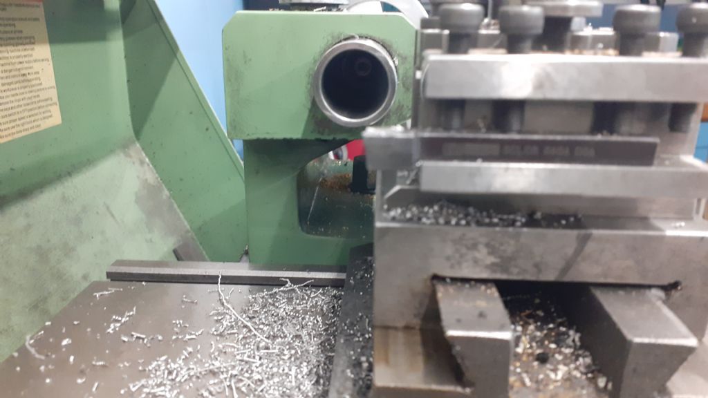

                      Topslide is set with a dti
                      BUT it is only used to advance the tool towards the the headstock to put on a cut or two which faces the shoulder to final distance from the end. Not used to turn the diameter that is done with carriage and power feed.
                      #611161
                      Ramon Wilson
                        @ramonwilson3
                        Doc,
                        I don't use the top slide for turning unless I'm turning a taper and certainly would not use it to turn parallel – just too much effort to get it set right only to lose it as soon as it needs moving. You can soon get bogged down in how to set the TS dead parallel which for this operation simply isn't required but, advice is what it is, you do the choosing.
                        I can't recall my ML7 but setting the topslide parallel interferes with the tailstock on the Super 7 when turning between centres giving restricted movement on the cross slide. My top slide is permanently set at 15 degrees for that very reason and only gets moved to change the angle if required
                        There really is no need to undercut the shaft, there's no justification for doing so besides it's not full size practice.
                        The tool you have ground is fine – you may just need to tweak it a bit to improve the cutting – part of the learning process in grinding tools by hand. Here's a short version of the one I posted previously roughing out the crankshaft for the Corliss engine – virtually the same as your shaft just larger

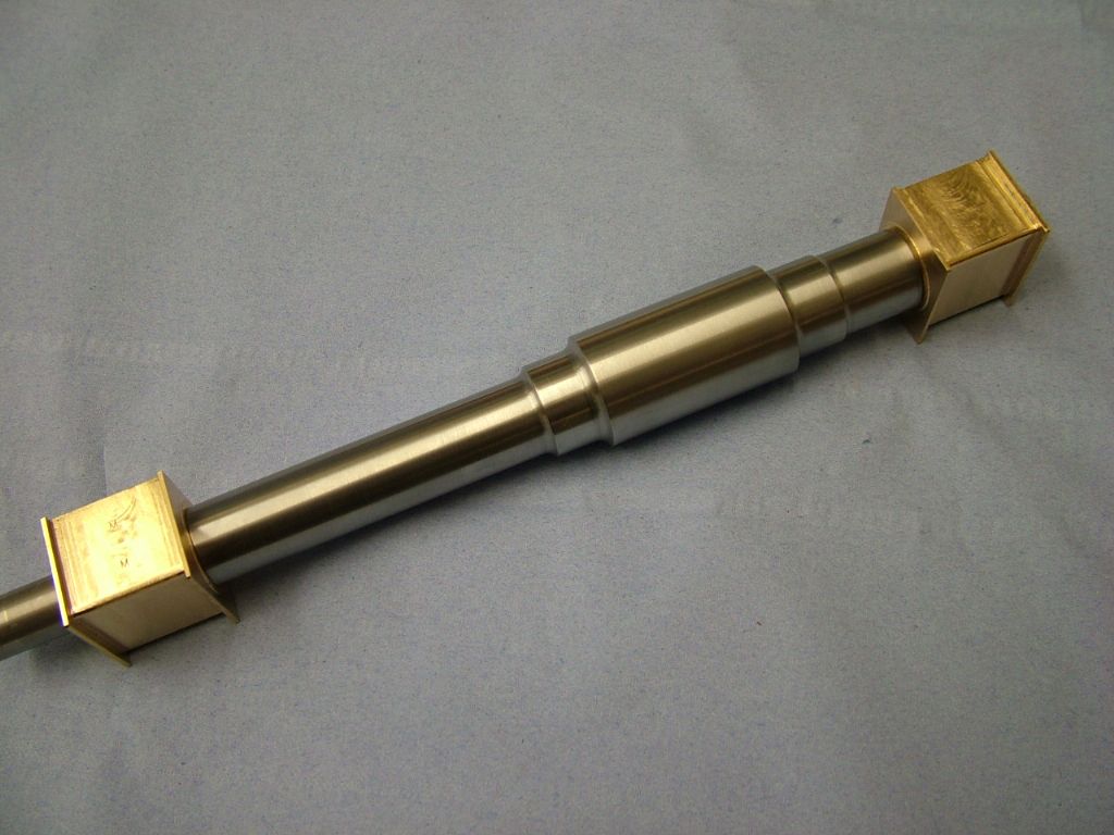

                        It was finished with the other, longer, tool shown previously. Note the radii – an undercut would be considered to reduce a crankshaft to a thinner diameter for absolutely no practical reasoncorliss project (66).jpg
                        If you have a dead stop then use it in this case. Carefully face a small length(s) of steel to the dimension(s) required and set the stop. With one hand on the hand wheel lift the self act lever a little before the stop is reached and finish off the last few thou by hand. A dead stop is not designed for running into under power! As Jason I have no DRO on the lathe – doing the above provides an accurate method by simple means.
                        As always though the advice is based bearing in mind on what kit you have and how I would tackle it as such. You do the choosing
                        Best R

                          As Ramon says it is not usual to undercut a shaft like this but I can see why the article suggested it and would likely do it myself if using the tool you have ground.
                          The step down in diameters is only 1mm per step, that is going to leave a shoulder of only 0.5mm, now given that the HSS tool looks like it may have a 0.75mm tip radius you are not going to get a flat face to the steps. Add to that any deburring of the mating parts and they are not going to locate along the shaft with any exactness Only way is to do the undercut the depth of which will be governed by the dia of the tool.
                          Easy to see that the "shoulder" on the left would not give very positive location but the one on the right gives a flat shoulder and provided you only deburr the mating part lightly will give a positive lengthways location to the part
                          Edited By JasonB on 25/08/2022 10:15:50

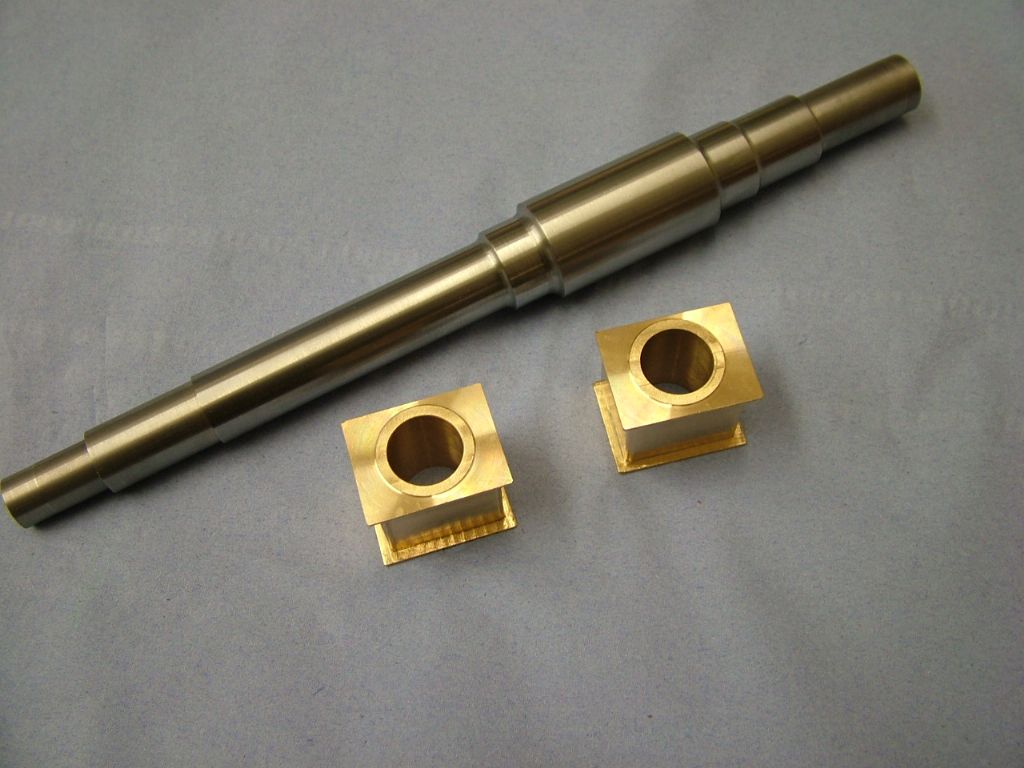

                          Ramon Wilson
                            @ramonwilson3
                            I would agree to a degree with Jason here Doc as I didn't take on board that the steps were so shallow.
                            Even so there is no need to undercut unless something is going to sit firmly against the shoulder in question – money and choice are the keywords but an exposed undercut in a shaft for no practical reason is not going to look right – well not in my book smiley
                            On the other hand if the shoulder is to locate something then yes an undercut would be needed if the step is minimal.

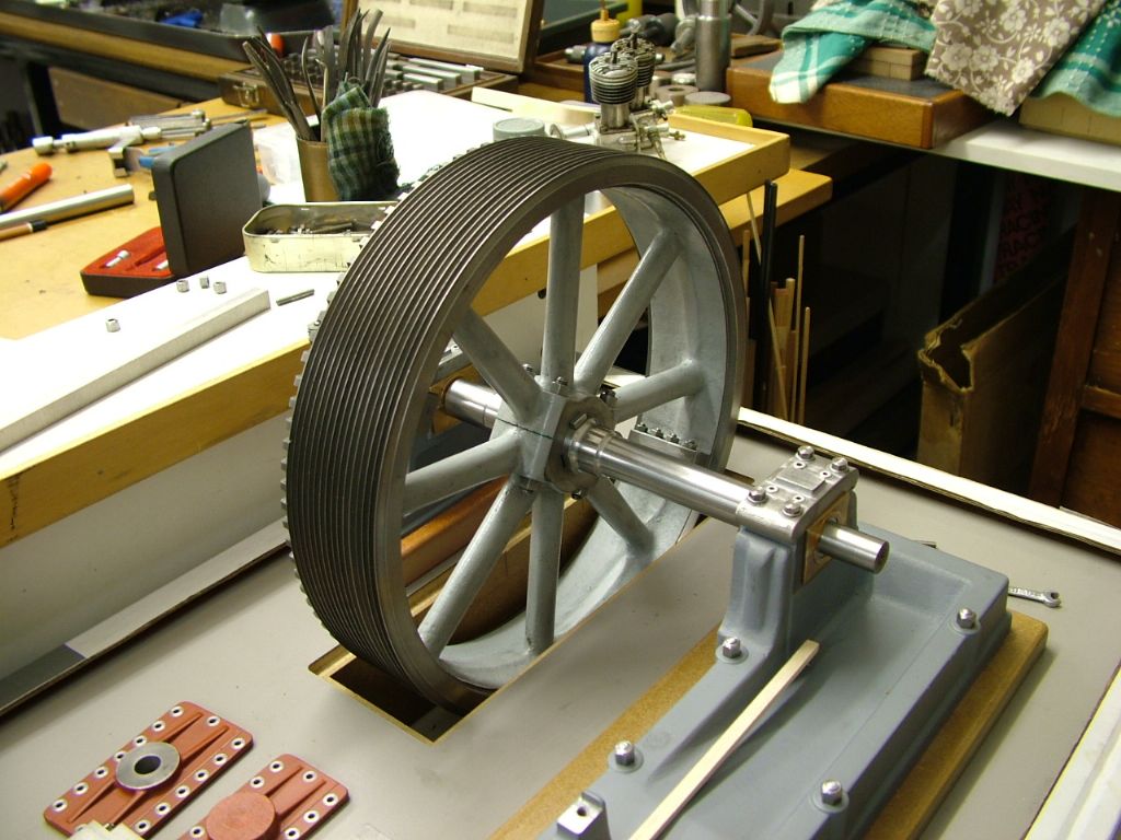

                              As an addition to the last post if you take a look at this image again you will see that where there is need for location – Crank web and bearing seats – the radius is reduced to virtually nothing and the mating parts lightly chamfered to accommodate any slight radius in the very corner – no undercuts required.
                              All other shoulders have a radius – why would there be a need to undercut such and besides it will probably lead to comments such as "What are those undercuts for ?" if you do – horses for course etc
                              Best – R

                                Ramon Wilson
                                  @ramonwilson3
                                  Yes I thought that was how the Warco tailstock was relieved, just like on a Colchester 2000 (and many others no doubt)
                                  As you say though the live centre major diameter can be an issue at times. I have a very nice but larger diameter Jones and Shipman that's rarely used due to that situation so my 'turn to' one most of the time is one of those 'Skoda' centres (remember that constant advert in ME ?) bought years ago that still does the business but I recently purchased one of those small diameter ones from Arc – a real asset for sure as it's been well used since.
                                  The only point that actually requires a step for location are the two faces between bearings and that for the crank webs. As you infer it's much better to be able to position the eccentrics from a lining up point of view so allowing that ability is much the better option
                                  #611204
                                    Interesting thoughts about bearing location there.
                                    As this is a twin with a crank either end just outside the bearings I would have thought that the large bearing surface between crank arm and bearing flange would be best to locate the shaft from sideways movement.
                                    If the inner step on the shaft were to be used on Doc's model there is very little area for the side of the bearing to run against and could possible wear quicker than if using the whole side of the bearing to locate things.
                                    #611209
                                    Ramon Wilson
                                      @ramonwilson3
                                      I suppose that depends on how the bearings are finished off – I don't see this as an issue as you can see the bearing face on the Corliss is just that circle on both sides so the bearing face area is the same either on crank or shaft.
                                      The important thing is that there is clearance on one side or the other so it doesn't matter which side as long as the crankshaft is captive and not allowed to float. Trying to bring both faces on each bearing to a smooth running fit risks the possibility of a tight fit but then the bearing could be tweaked on the faces if so.
                                      This really is a choice thing I guess but I prefer to use the inner faces to keep the shaft in place axially – after all if you don't have a second crank but a pedestal then that's all there is. dscn0966.jpg
                                      As you say Jason, all interesting thoughts throughout a build such as this especially from Doc's perspective
                                      Regards – R
