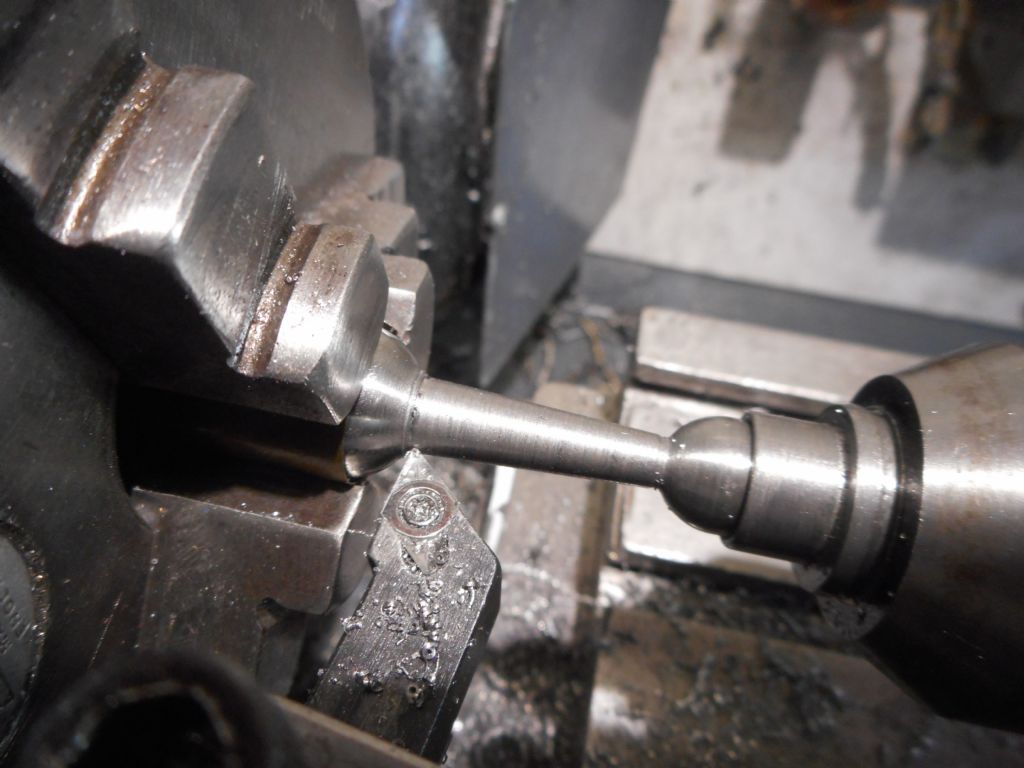

                        #611610
                          You can't turn to the end with a reverse ctr. or use them when the cranks are in place
                          Here are some 3mm dia valve stems being supported with a ctr drilled hole, hole must be 2mm across the top, less on the second image
                          Your picture looks like a 4mm main body with 1.6mm pilot.
                          If you come down to 1/8" imperial or 3.15mm metric then the pilot comes down to 3/64" or 1.25mm. There are smaller pilots available but I doubt they last very long, 0.025" being the smallest.
                          Edited By JasonB on 29/08/2022 07:30:54

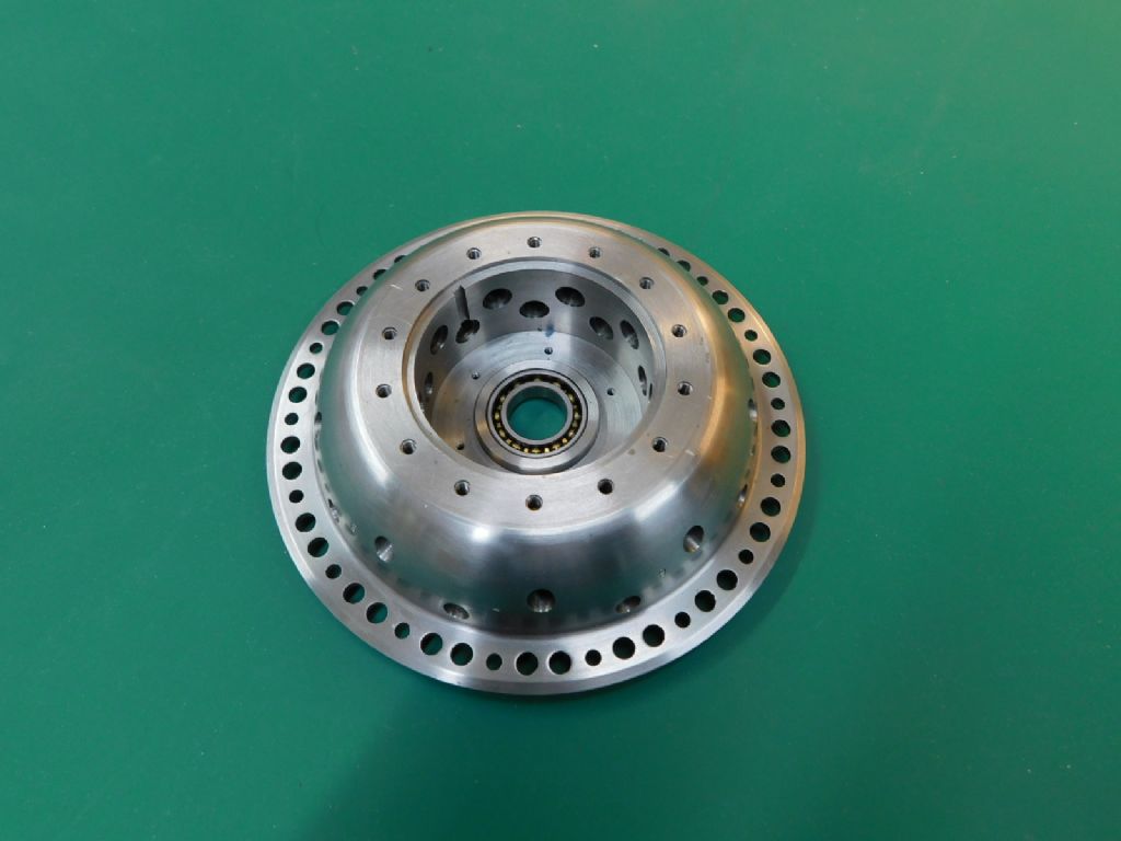

                                                Ramon Wilson
                                                  @ramonwilson3
                                                  Doc as I mentioned in my previous post En1a is a good steel combination in a running fit in bronze (or cast iron)
                                                  It's much easier to machine than En3 or GCQ (General Cutting Quality) which is probably what you have and which will be difficult to machine to a good finish. If the tool is right it will give you an extremely fine finish straight off the tool with fine cuts and can be polished up with fine grit (240) emery or wet and dry paper.
                                                  The tool you have ground is fundamentally a reasonable basic shape but it's the tip that does the work and that needs to be improved as I see it.
                                                  The rake on the top is too obtuse for steel so increase that back towards you and back towards the tailstock – a good 10-15 degrees and the tip needs a nice radius – I do mine not by rotating the tool itself against the wheel but rather by dragging the tool at the right (as in more or less correct) front and side back off angles around the corner of the wheel allowing the radius to form by the corner of the wheel. If you are struggling to perceive this then I'll take some pics for you tomorrow.
                                                  Re material this was made from En1a and done entirely with hand ground tools – yes it's been emeried but as you have already found the finish has to be there if tool marks aren't to be evident. No form tools were used on this, the radius created by a series of flats and scraping the high points between them

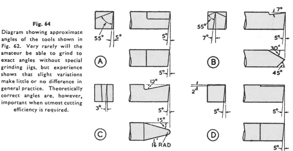

                                                    Hopper
                                                      @hopper
                                                      Posted by Dr_GMJN on 29/08/2022 19:19:30:
                                                      I tried grinding a right hand tool:
                                                      It's hard to tell from the pic but it looks like your tool could use a lot more angle on that top surface and maybe even a little more on the leading face. Following the advice of LH Sparey in "The Amateur's Lathe" I have found these small, not very rigid hobby lathes work best with much more of a cutting angle than usually recommended in more industrial circles.
                                                      Sparey recommends about 5 degrees of clearance on the leading face, then grind the top surface at about 30 degrees. Yes 30 degrees. This puts the knife in knife tool. So the included angle between the leading face and the top face is 55 degrees. He recommends checking this angle with the V notch in your 55-deg BSW screwcutting gauge. This angle results in a very sharp edge that cuts well — but will wear quicker than a more obtuse angled tool but seems to last ok in the home workshop.
                                                      To get a good finish it is essential to finish the tool off on a bench oil stone after grinding. The type of stone your Granny used to sharpen kitchen knives. Rub the flat surfaces on it until they are nice and flat and smooth and form a cutting edge that is sharp to the feel, like a knife. Then by rotating the tool bit as you rub it back and forth along the oil stone, put a small radius on the cutting tip, running all the way down that edge so basic cutting angles are maintained. Then stone the top surface of the toolbit to remove any burr.
                                                      And don't be shy about using a bit of emery cloth/paper and a drop or two of oil to remove the last half a thou and get the ultimate finish! By working evenly along the job you can still maintain diameter along the length within a few tenths if desired.
                                                      Also, the discoloration indicates you might be overheating your tool bit a little while grinding. Take it easy and dip in a tin of water regularly to stop the edge turning blue. Use a fine wheel if you have it for finishing. I have gone back to using 1/4" square toolbits on the Myford and packing them up, just because it takes waaaay less grinding time than the 3/8" bits that are a bit easier to use packing-wise.
                                                      See the knife tool A at the top left of the below diagram for the 55 deg included angle.
                                                      A) is a right hand knife tool
                                                      B) is a 'corner tool'
                                                      C) is a round nose tool and
                                                      D) is an example of a knife tool used for brass, you should have a round nosed and corner tool as well for brass (and CI)with the same reduced top rake.
