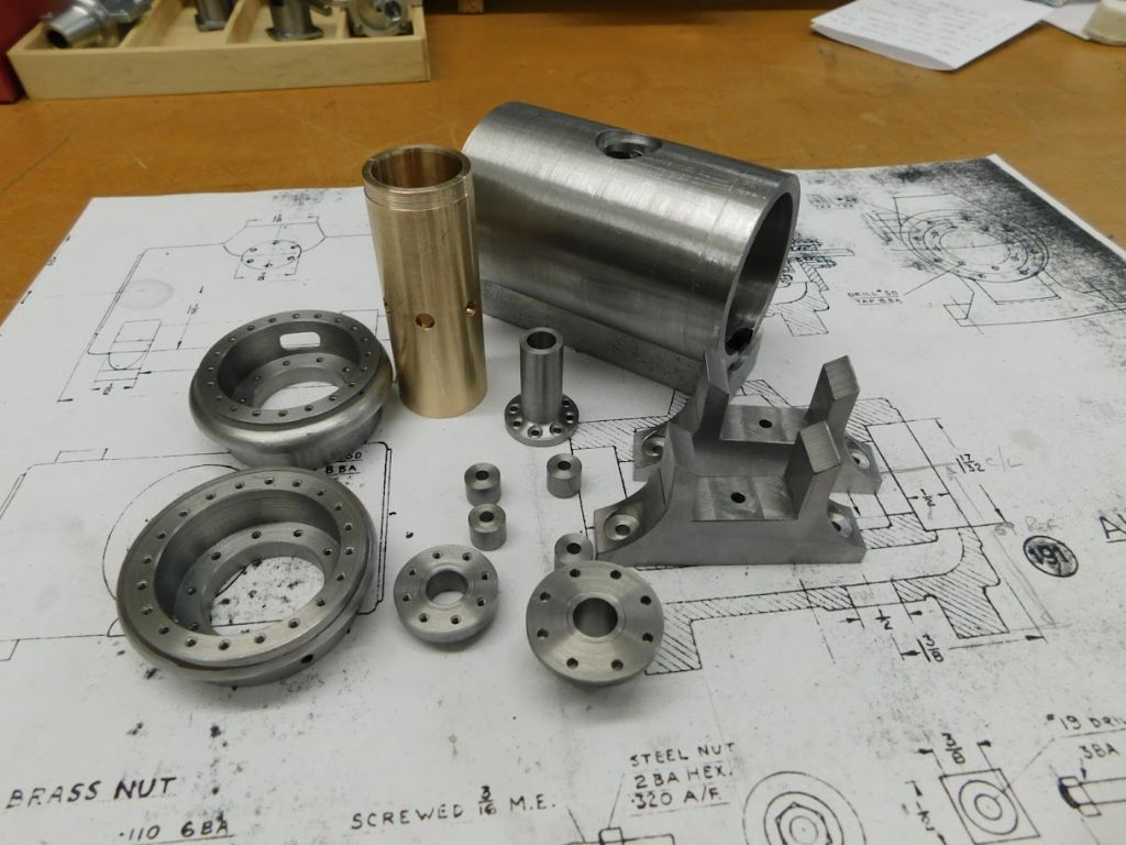

        Soft soldering part 2. As mentioned, I considered using Space Shuttle heat shield insulation to rest the parts on (to retain heat within the parts). I’ve had it for years and it’s pretty useless:
        Then looked at how much it goes for on EBay and thought again (apparently production of it ceased in 1993). Settled on pre-tinning each individual part held in air on a stand:
        Which worked:
        As per Ramon’s comment, needed to clamp the parts to solder them all together. If a normal clamp was used, when the solder melts, the whole thing would drop out of position. Rather than using piano wire, I spring-loaded a clamp:
        Then hung on the stand and sweated it all together:
        Initially used wood marked with diagonals to get the centre, but checking with dividers gave an offset, which I didn’t want:
        Remembering Jason’s comment, I used hot melt glue to put a piece of aluminium in the middle, and drilled the centre using the DROs in the mill. Then it was spot-on:
        Then centred in the 4-jaw Chuck using spreader plates:
        And gradually opened up to size. The initial cuts were very rough for some reason, almost as if the surface was hardened by the sweating/cooling process. After the third or fourth 0.0025” cut, it became smooth.
        Then un-soldered again:
        Seems a good fit for the first one. I suppose I could have turned a chamfer on one side rather than filing it to mate it to the cylinder flanges, but whatever:
        Still quite a bit to do, but so far so good this evening.

                    Carried on machining the other two feet, which was straightforward, then marked out for the pockets, which I did with a slot drill. I marked the extents of the rads w.r.t. the edges of the arc cut-out:
                    After cutting both pockets I double-checked the centres with the DRO, and they matched the base hole centres, so as per the drawings/instructions:
                    The result (still needs the flanks chamfering):
                    The question is (there’s always a question!):
                    The base holes are spaced at 44.46 mm, the pocket centres in the feet are the same. So, unless the feet are attached to the cylinder castings precisely such that the finished axis ends up dead in the middle (seems unlikely), then the feet hole centres will not match the pocket centres. There will be some lateral mismatch. I checked a 4BA hexagon, and it gives about 2mm gap on radius between the points and the pocket…I can’t bring the pockets any further in toward the castings otherwise they’ll break into the cut-out arc (the edges need still need filing slightly for a snug fit).
                    I think I’ll have to figure out some method of placing the un-bored cylinders onto the properly spaced feet before fixing them (ie using the centred wooden plugs).

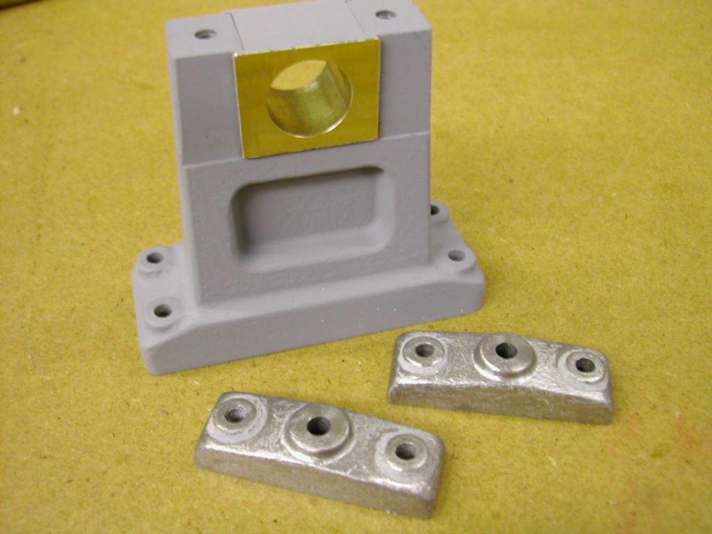

                                        So I machined the slots in the rest of the feet and drilled the mounting holes to be a close fit on the screws. Eventually I’ll open them up to 4mm as per the instructions, to give some wiggle room to adjust on assembly to the beds:
                                        Then, using the holes as datums, trimmed the feet to length, plus a fraction so I can finally machine them once the cylinders are bored:
                                        Then marked out for cutting the chamfers:
                                        It says in the article to file these, but it was easy enough to do them in the mill…or so I thought.
                                        …but of course, one slight grab with this mill, and all the careful work is undone:
                                        I really need to get a better machine. I know…bad workman and all that, but jeez. Anyway, here they are:
                                        Test fitted:
                                        Then started on grinding and filing a chamfer on one side of each foot, to clear the radius on the cylinders:
                                        And abraded the castings to suit, ready for bonding:
                                        They seem to fit well enough:
                                        A very basic height check seems to indicate all is well there:
                                        So that’s today’s progress:

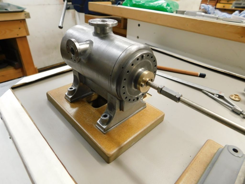

                                          I’ve re-thought the next stage: I’m going to re-fit the bases to the mill bed, align them perfectly, then use them as jigs in conjunction with the DROs and a pointer in the chuck to check the cylinder centre heights, longitudinal alignment and valve face height/level during the JB Welding process. This should get me well within 1mm of alignment once everything is set and bored. Of course final machining of the foot widths, feet pad undersides, valve face and cylinder ends will be done after boring, with the cylinder axis as the datum.
                                          So what to do about the damaged foot? I put JB Weld on a damaged corner of a valve face, and it chipped straight off during filing. Could soft solder a piece on, and re-machine? Could try Milliput? Or buy more steel and start again?
                                          Overall happy so far, considering the stuff I’ve machined is more cosmetic than needing ultimate accuracy…but that mill is driving me mad.

                                                Jason – you also mentioned rounding corners to simulate a cast geometry. I’m planning on slightly rounding the outsides of the chamfers, and the end corners of the feet pads.
                                                I will leave the insides of the pockets sharp(ish), because a) it’s difficult to round their edges without them looking sharp/pointed, and b) if they were cast, I’d probably have machined them anyway.
                                                OK on full size, perhaps it would have just been a local spot-face in there, but I’ll call it modeller’s license.
