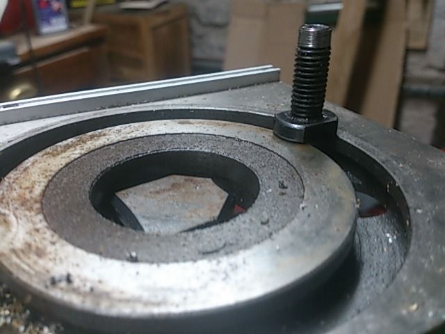

        I somehow stripped the thread on one of the two T-bolts which hold the topslide on my lathe:
        God knows how, I'm not a beefy bloke I and don't swing on the spanner, but it happened..
        The quickest and easiest way to make a replacement given the equipment and materiaI I have to hand would be to mill, drill and tap (M10x1.5) the head of the T-nut and screw a bit of HT studding inito it. Question is – would this work? The head bit is only 5.5 mm thick, so 4 (OK ,3.67) threads engaged. I read somewhere that you only need 3 threads, but i'm not convinced!
        Regards, Robin

          I would buy a suitable HT bolt and take an angle grinder to it.

            It is a quick and easy job to pull the cross slide off and make a correct tee bolt. Use EN24T if you have any or a Tensile bolt. The original most likely gave up from wear and tear, my lathe only has two bolts to hold the top slide on and I have added two tapped holes in the cross slide and made "L" shaped clamps to give a bit of extra security.

              My experience is like yours Robert, some of these bolts are made of soft material. I have made new bolts using HT bolts that I turn and mill, screwcut threads may not be as strong as rolled but I have had no problems.

                When one of my topslide T-bolt threads got too worn I made a couple of new ones from EN3:
                T_Nuts
                So far they've been fine. As far as I am aware the stripped bolt was original, in which case it was over 30 years old. I can't really see the need for fancy steel or HT bolts.

                  I would invest in a pair of new quality nuts while you are in there, too. Some of the nuts supplied with tooling are hardly fit to throw at the dog. ie: hole too big, not square to the thread, too few turns, and never mind which grade of coke tin they were melted down from.

                    Thanks for the advice. I was hoping that someone might say that there's no need for HT, and as Andrew has said it, and I have EN3 to hand, I have made up a new pair of bolts from that. They are actually more solid than the originals which had always felt a bit squishy between 'nipping up' and tight.

                      It looks like the nut was only just on the original T bolt. I would make the new ones a few threads longer, if there is clearance space to do so.

                                      Not teaching your granny at all Jon – I'm a rank amateur! However this had occurred to me, but there isn't enough room for a shoulder on the T nut if I stick to the M10 thread on the original, so it would just be a plate. Given that the plate can't be more than 5.5mm thick, and it's necessary to mangle the thread at the bottom to avoid the penetration problem described by Bandersnatch, it wouldn't work for this machine.
                                      Neil, I'd like to believe that the bolts were cunningly designed to fail before the T-slot, but given that this a generic 12×36 Chinese lathe I suspect that would be overly optimistic. It's more likely they are made from recycled bottle tops I think. The design of the cross slide / topslide is actually such that the top of the X-slide T slot is (in principle) held in compression, so presumably that reduces the risk of breaking it.
                                      I ended up jury-rigging the slide much as Howard suggested so I could turn new bolts from EN3, which seem fine so far.
