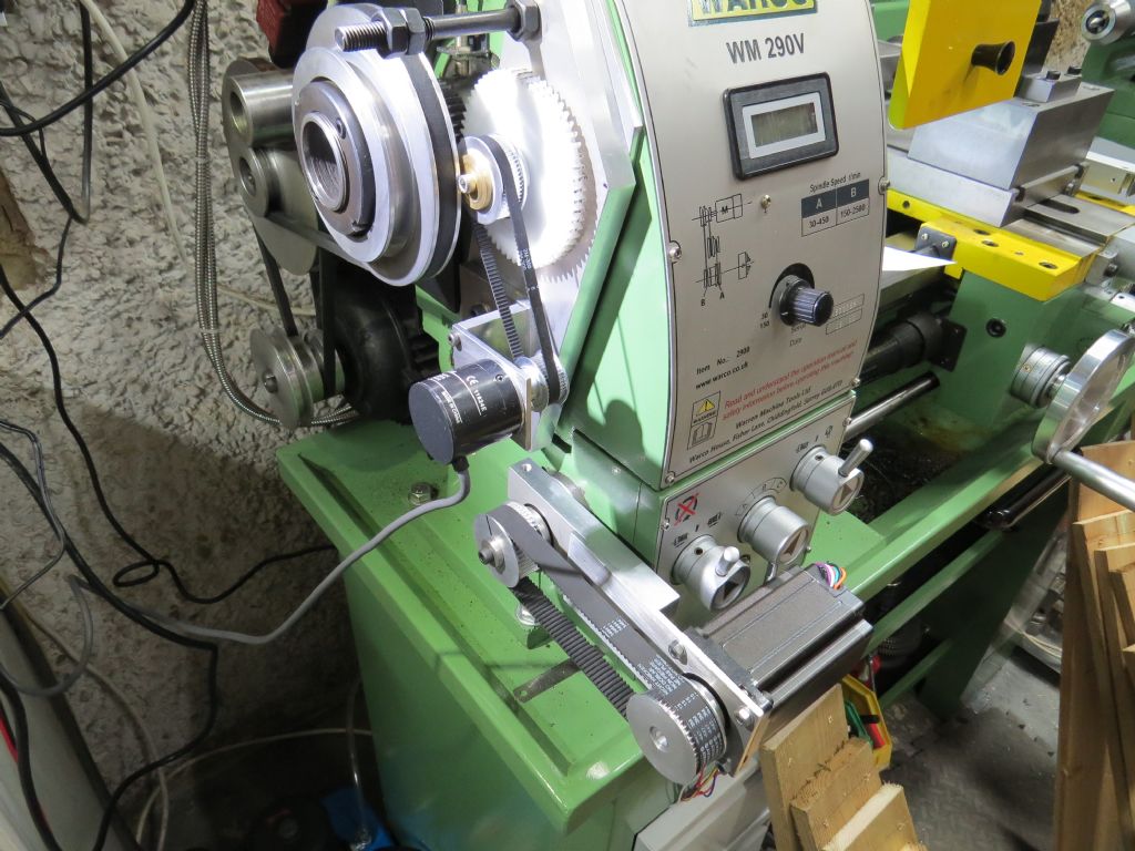

                Tony Pratt 1
                  @tonypratt1
                  I have just completed the first stage of an electronic lead screw build based wholly on the excellent You Tube channel run by Clough42.
                  All works as intended, fully capable running both metric & imperial feeds/threads on my metric lathe at the touch of a button, only problem is that the Nema24 stepper rated at 4 Nm is only giving 2.3 Nm so slightly underpowered, the supplier refunded the money & let me keep the motor.
                  Now going to trial for a while then tidy up the mechanical bits & box up the controls.
                  Tony

                        Posted by Tony Pratt 1 on 20/10/2019 12:21:57:
                        . . . . . . the Nema24 stepper rated at 4 Nm is only giving 2.3 Nm so slightly underpowered, the supplier refunded the money & let me keep the motor.
                        Tony
                        Could you increase the torque by gearing down the motor?

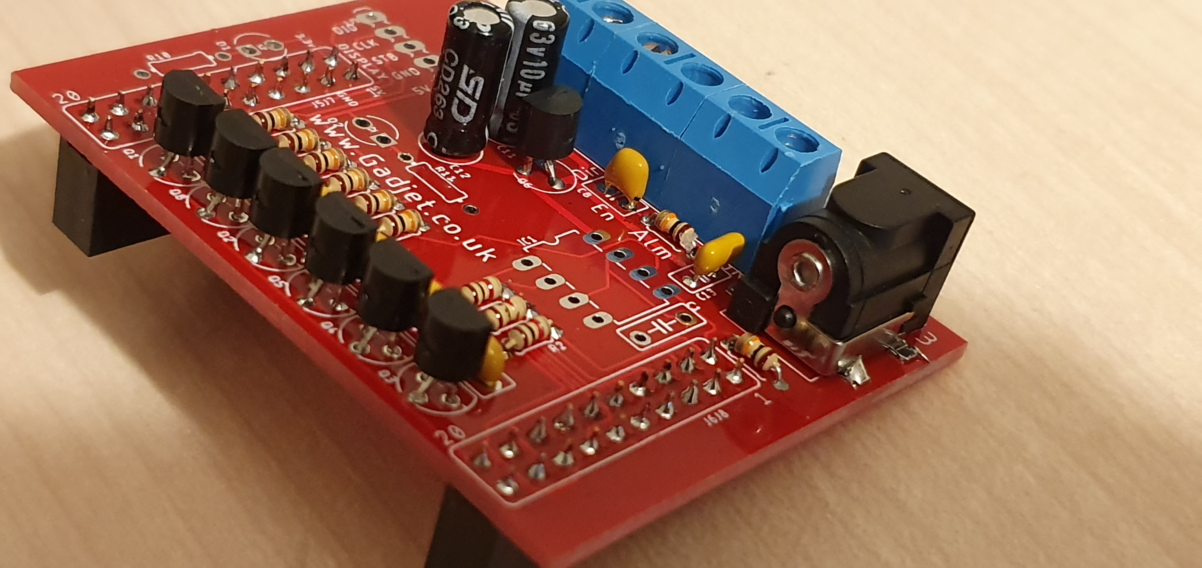

                          Posted by Phil Grant on 20/10/2019 09:58:34:
                          Another go for the images.
                          All the images are good for me now. PCB looks good. What is the power rating of the resistors you have used?

                              Posted by Brian Oldford on 20/10/2019 19:52:21:Posted by Phil Grant on 20/10/2019 09:58:34:
                              1/8W to get them small enough.

                                    Posted by Brian Oldford on 20/10/2019 19:50:18:
                                    Tony
                                    Certainly could, but call me old fashioned if the motor is advertised at 4 Nm I would expect to get that value, I'm now going with a Nema 23 again rated at 4 Nm from 'CNC4U', hopefully it will deliver the quoted power!
                                    Tony
                                          Tony, how are you measuring the power of your steppers, I have some I would like to verify before I put them to work.
                                          thanks
                                          Gray

                                              Posted by Gray on 21/10/2019 15:55:26:
                                              thanks
                                              Gray
                                              I connected a 12" bar/beam to the motor & energised it so the holding torque could be measured. 4 Nm = 2.95 foot lbs so in my estimation I should have been able to load my 12" beam with 2.95 lbs before the motor let go?
                                              There are various You Tube videos showing how to do it but I think the methodology is correct, any 'experts' are welcome to comment, also be aware how the motor is wired will affect the power.
                                              Tony
