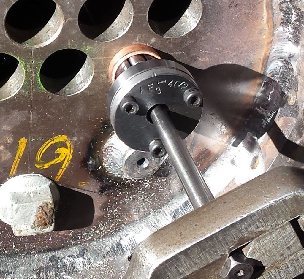

                                Paul Lousick
                                  @paullousick59116
                                  This is the type of tube expander which we use, both on full size boilers with 2" dia tubes and on my model with 1" diameter tubes. The expander consists of a number of conical rolls which are aligned inside a guide cage. The slots in the guide cage are angled slightly from the axis of tool (shown in the photo below). A tapered pin is inserted into a gap between the rolls and is rotated. The angular position of the slots in the cage causes the tapered pin to be drawn into the tool as it is being turned, causing the rolls to move outwards and expand tube. Normally by rotating the pin in a clockwise direction it is drawn in and by reversing the direction of rotation it is withdrawn. A massive force is exerted by the wedging action of the tapered pin. On full size boilers with 2" dia tubes, they can withstand 200 psi working pressure and 400 psi when being tested.

                                  Below: Expanding the tubes on my model engine

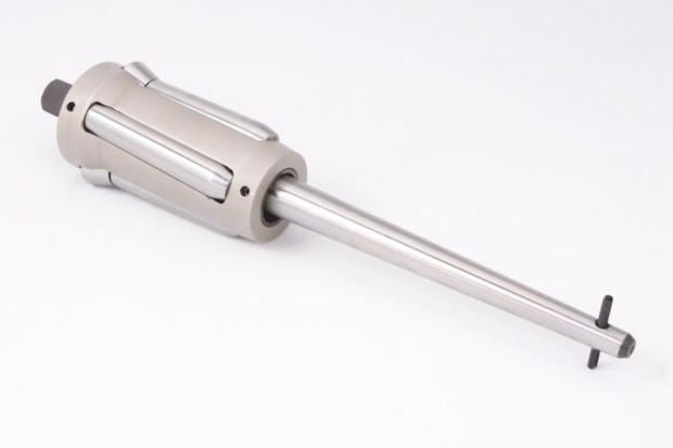

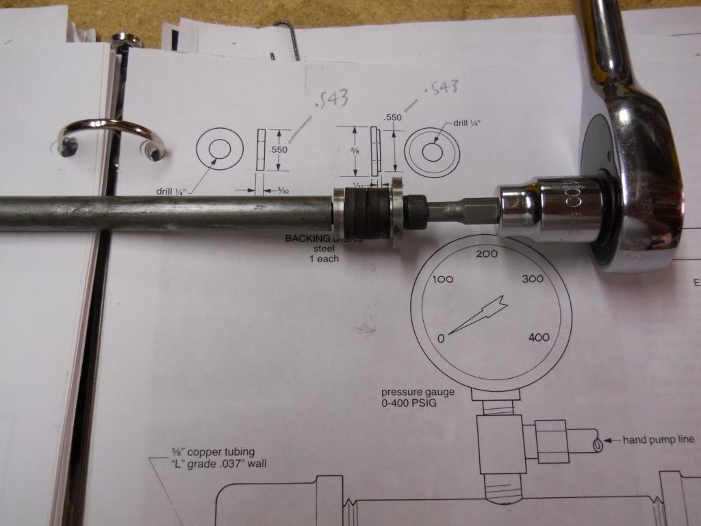

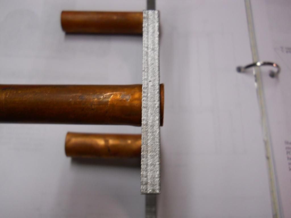

                                      Hi John Lintorn,
                                      Pics of full size expander and my model expander and a test piece done with it are below.
                                      tube-expander-fullsize-commercial.jpgtube-exp-tool-models.jpgtube-exp-models-testpiece.jpg
