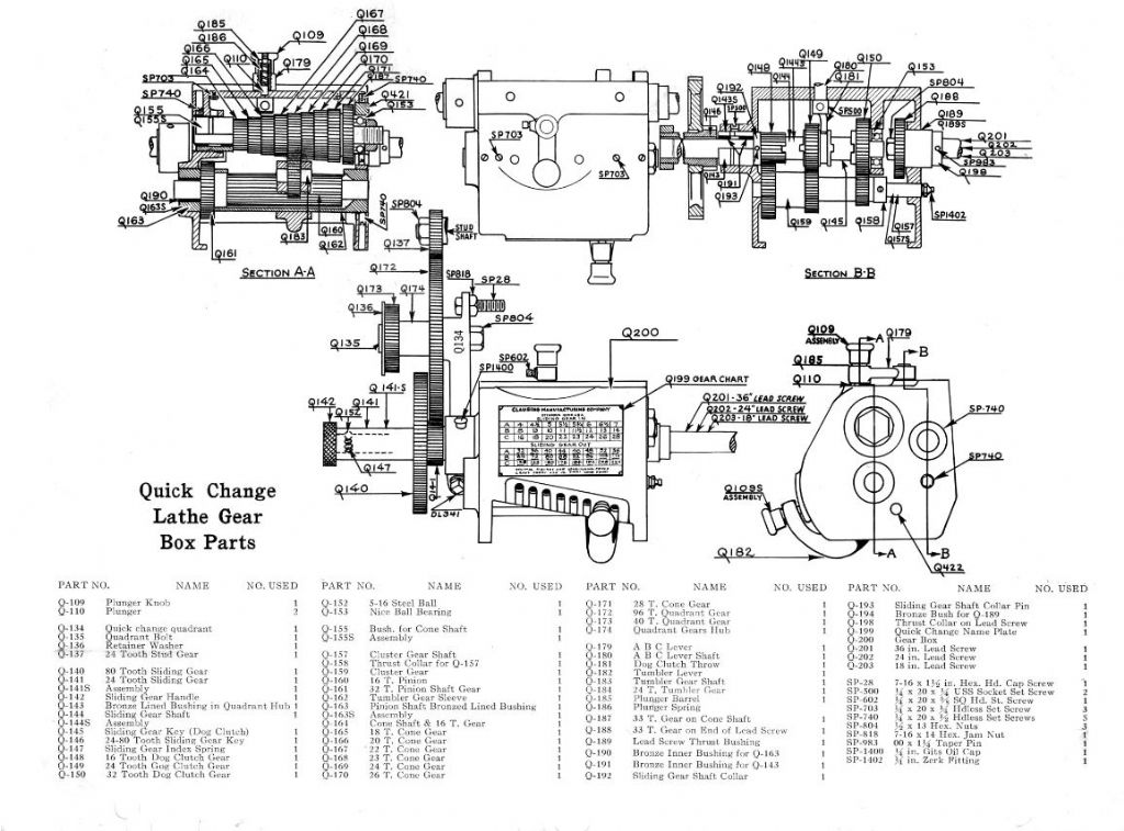

                      mark smith 20
                        @marksmith20
                        Sean,
                        This may be of some help hopefullysmiley

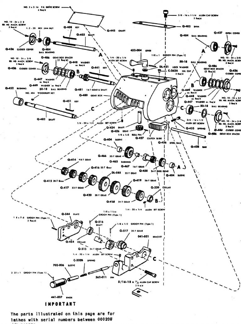

                        #258974
                        mark smith 20
                          @marksmith20
                          Sean, This one may be more like yours.Forgot to say they are both clausing gearboxes but they are likely similar to Fortis.

                            #258988
                            mark smith 20
                              @marksmith20
                              Sean, they are off vintage machinery. org , very useful when i was rebuilding my southbends. They have a great list of manufacturers with available literature to download or view for free. Not an awful lot of UK manufacturers info though.
                              The Clausing 100 series is probably most like the Fortis. The second gear box image i put on is in this first link at the end and its a large size, so printable.
                              **LINK**
                              **LINK**
                              **LINK**
