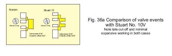

        Take a simple model steam engine with a flat sliding "D" valve and eccentric strap. Am I safe in assuming that the distance the valve centre line travels during its movement from one end of the cylinder to the other end is the same distance between the steam port centres? Or, is there more to it than that?
        I suppose its the same with a piston valve engine – yes?
        I've tried googling for some simple rule of thumb advice but without much success.

          Sub Mandrel
            @submandrel
            Hi Stuart,
            This is a diagram of the slide valve for an engine I designed, compared with the Stuart 10V.
            Click on it and it should give you enough of a guide to make functional slide valves (the port sizes are to scale)

            julian atkins
              @julianatkins58923
              Stuart,
              the general rule is that the steam port doesnt need to open fully, but the exhaust port must. in addition with stephensons valvegear one should not aim for equal opening of both steam ports, as there is a discrepancy between front and back port caused by the geometry of the gear. the valves should be set to give equal lead rather than equal port opening, and a check on equal cut offs is no bad thing either.
              i hope this helps.
