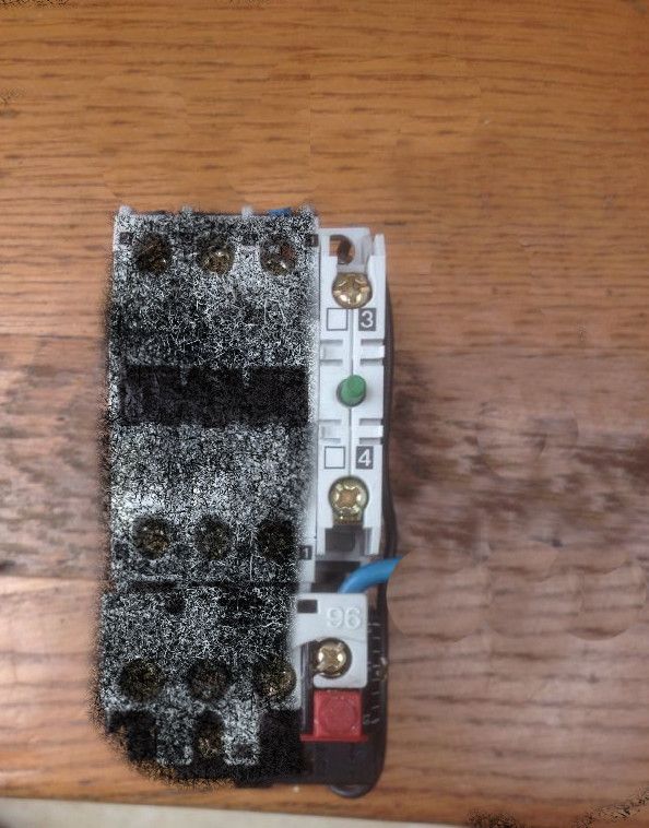

              img_2726.jpgSod I wired it as in your picture. Also A1 is connected to 1L1 and 5L5 is connected to 96 just above red button.There are no wires connected to 3 and 4 on the on the right hand side on off switch.img_2725.jpg

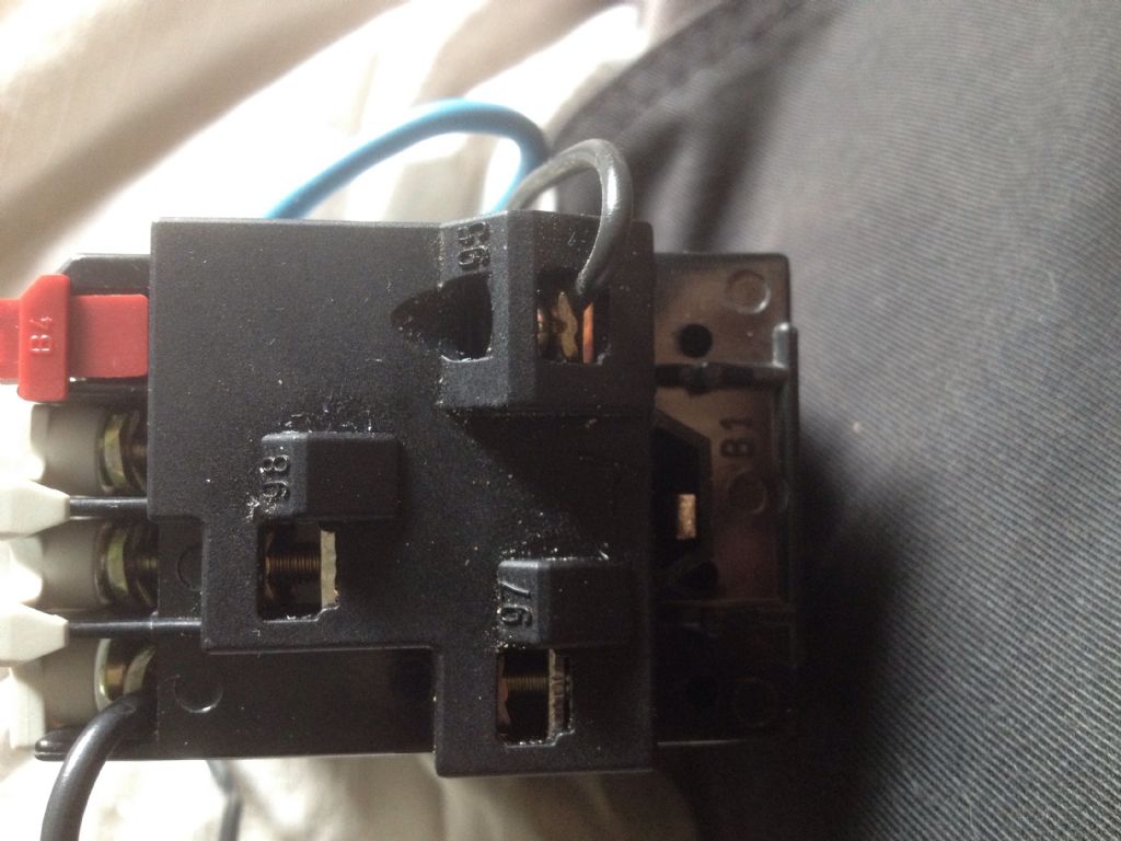

                95 and 96 are a normally closed switch inside the thermal cutout. It opens on overload, phase loss, or if the red button is pressed. (The red button may also be a reset, to be pushed after an overload?)

                  SORRY correction from last post 5L5 SHOULD HAVE BEEN 5L3.Hi Duncan,this is a pic of the underside 95 on the right is connected to A2 by that black wire.96 is connected to 5L3 by blue wire.img_2727.jpg

                    'Also A1 is connected to 1L1 and 5L5 is connected to 96 just above red button.'
                    That explains why the coil operates. It's connected directly across L and N. Good news because it makes sense even though it's not right.
                    With a lamp as the load, try this:
                    • Disconnect A2 at the 5L3 end and reconnect the wire to 95.
                    • Disconnect A1 at the 1L1 end and reconnect the wire to 5L3. A1 is now mains neutral.
                    • Confirm 96 is wired to the ON/OFF switch
                    • Confirm the ON/OFF switch has mains L on the other side, i.e is connected to 1L1
                    • Cross fingers, apply power, and press ON

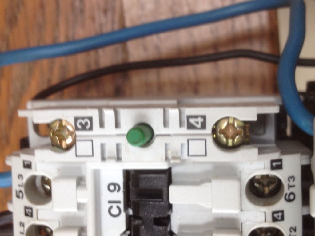

                    'There are no wires connected to 3 and 4 on the on the right hand side on off switch.'
                    3 and 4 are auxiliary contacts needed to latch the contactor on when the ON button is a momentary type (like a push switch that goes on when you press it and off as soon as you let go.) With luck you may not need 3 and 4 . It depends on whether or not your ON/OFF switch physically latches when pressed. Try it and see. If lamp only stays on whilst the ON button is held down, we will need to wire in 3 and 4.
                    Once the lamp is properly controlled by the ON/OFF switch, try connecting the motor. (There may be a problem in that department too, but let's get the contactor working properly before worrying about it.)

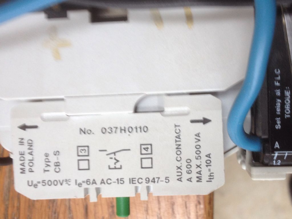

                          The overland unit you are using has a current range of 1.2A to 1.9A if the FLC (full load current) of the motor you are using is higher than this then you need a new overload unit. If you look at the rating plate on your motor is should specify the FLC of the motor, I suspect that if this was correctly sized for the 3 phase motor on the bandsaw and you have replaced with a same horsepower single phase then the FLC will be too high for that overload and that is why tripped.
