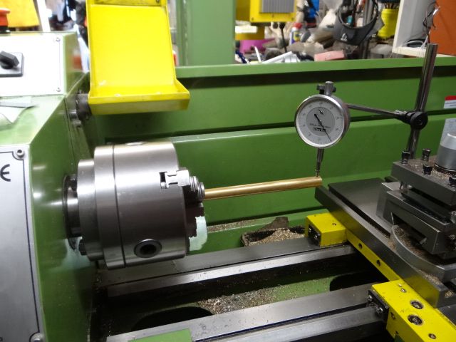

                #256609
                  I should be out cutting grass but if I dither about enough here it might rain and I won't have to do it.
                  I have a WM280, which is slightly lighter than a 290 and has a smaller headstock bore (26 rather than 38mm).
                  My test set-up in the picture. The brass bar is ½" diameter, and the dial indicator is 140mm away from the chuck jaws.
                  Results:
                  Pressing firmly with one hand on the dial-indicator end of the brass bar causes a 0.41mm deflection.
                  90kg sitting on the headstock – no measurable deflection.
                  Standing on the floor and attempting to twist the headstock – – no measurable deflection.
                  Leaning to press down as hard as possible on the chuck with my feet on the ground causes a 0.01 deflection.
                  Conclusions:
                  • ½" brass bar is obviously elastic
                  • My headstock doesn't move relative to the bed when sat on
                  • It's possible to get a deflection by pressing on the chuck that is probably a mix of spindle and chuck movement.
                  • 90kg! I need to go on a diet.
                  Possibly there's something odd with Dan's set-up, but we don't know how much force he's using, or what the lathe is stood on. I wouldn't worry too much unless the deflection was causing the lathe to produce poor work.
                  As it's still not raining I shall have to report for gardening duty, blast it,

                      You have the dti in the wrong plane. You need it at 90 degrees to that, in the horizontal plane and roughly on center with the axis (but not critically so). Then you will get a reading if you push.

                        only had time for one test today (will do more tomorrow), so repeated the one in Jason's video – I get maybe .025mm, so about 3 times Jason's result – although I am 100kg, so maybe that explains everything
                        Dave – Did you try with the indicator horizontal on the bar ? I get nothing either with it vertical and pushing down on the headstock, but I get .03 or so pushing horizontally on the headstock with the indicator horizontal – which probably says something about the fit of the headstock on the bed.
                        I am also fairly sure the ways are twisting a bit, as the amount of deflection varies with how far the mag base is from the headstock.
                        For those asking whether it matters, does the lathe turn ok etc, yes, mostly. I have had parting problems, which were mostly down to the belt slipping or lack of torque in high range, but may have been worsened by lack of rigidity. Similarly, I don't ask all that much of the lathe – hard to say whether Jason's or Dave's would take a bigger cut with less complaint – and I agree it probably doesn't matter if it mostly does what I need. Still, I think we would all like to get the most out our machines if possible.
                        Anyhow, video of my version of Jason's setup below:

                          Posted by Mark C on 18/09/2016 19:36:20:
                          Dave,
                          Mark
                          and Dan:
                          "Dave – Did you try with the indicator horizontal on the bar ? I get nothing either with it vertical and pushing down on the headstock, but I get .03 or so pushing horizontally on the headstock with the indicator horizontal – which probably says something about the fit of the headstock on the bed. "
                          Doh! I'll do again it properly and report back.
                          I made a mess of cutting the grass too: it looks like a drunk did it, which I wasn't honest.
                          Cheers,
                          #256686
                            Ok, repeated the test and confirm that I get about 0.03 horizontal deflection with the DTI 140mm out along the brass bar. I had to push the headstock as hard as I could to get that. My lathe isn't bolted down and I managed to move the lathe and stand slightly doing the test – over 300kg I would guess.
                            Being lazy and unfit I now feel like I moved Mark's 4 tons of hardcore.
                            I've not noticed any problems using the lathe and wouldn't have realised that the deflection was possible without trying the experiment.
