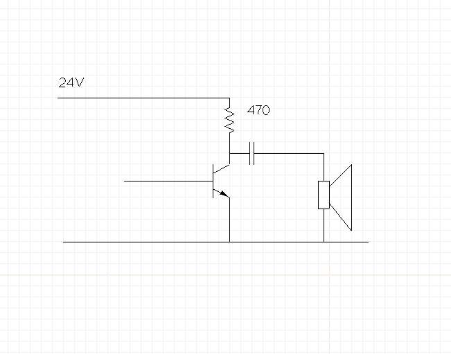

                On Neil Wyatt Said:
                A 24V square wave will put about 18watts into an 8 ohm speaker. …
                Is it me?  I reckon 72W from W=V*V/R
                Maybe Duncan has a 72W amplifier, but I took him to mean he had a 24V rail, with a resistor being grounded by a transistor driven by an arduino.
                Screenshot from 2023-12-21 22-19-26
                For a 1W 8 ohm speaker, I reckon a 2W 470ohm dropper resistor , capacitor what I said above.

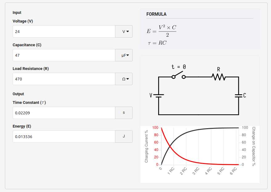

                      #700868
                        On duncan webster 1 Said:
                        If the speaker was in series with a transistor across the 24v Dave’s sum falls down as its only conducting half time, so 36W
                        Time is a vital factor in Duncan’s question, so all our guesstimates are a bit suspect.   Also, we’ve all made assumptions, with Neil assuming a 24Vrms amplifier, whereas I assumed a 24Vdc rail.   Both wrong, Duncan now says it’s a 5V rail!
                        Anyway, consider what happens in my circuit above.
                        • the rail holds steady at 24V (unless the power supply is rubbish!)
                        • when the transistor switch is OFF, the capacitor charges via the 470ohm resistor and the speaker.  Doesn’t charge instantly, because the 470ohm resistor inhibits current flow, as does the speaker, a bit.   The speaker’s cone moves OUT in time with the current flowing in the capacitor as it charges up.
                        • when the transistor is switched ON, the capacitor discharges through the 8ohm speaker.  Current flow in the speaker is reversed, and the cone pulls IN.   The 470ohm resistor does nothing beyond wasting a few DC watts.  Instead the time taken to discharge the capacitor is proportional to its value and the 8ohm inductance of the speaker.  My earlier post calculated the capacitor needed to resonate with the speaker, more explanation below.  For this I took time into account, hence 2πf in the formula; C varies with frequency.
                        • The amount of power that can be delivered to the 1W rated speaker is limited by the 470 ohm resistor.  The circuit doesn’t apply the full power available from the 24V rail to the speaker.
                        There’s a Resistor/Capacitor time constant calculator here.  At 24V, 470ohm and 47µF it says:
                        Screenshot from 2023-12-22 10-17-19
                        Note the graph shows that the charge current flowing in the speaker isn’t a square wave. The sharp rise is converted into a rounded curve by the RC time constant.   Not a sine wave, but far from square.
                        Different maths applies when the transistor switches ON and shorts the capacitor to ground.     This speaker coil is an inductor, not a resistor, and inductors also have a time constant.   Inductors and capacitors both store energy, but they do so in the opposite sense.  Thus, when a capacitor discharges into an inductor, it charges the inductor.  Then the current flow reverses and the inductor discharges into the capacitor.  The LC time constant is resonant at some frequency, so LC circuits oscillate at a particular frequency, and the output is a sine wave.
                        My circuit is akin to banging a drum.  The transistor switching OFF sends a rounded pulse of energy into the speaker cone.  Shortly after, switching ON causes the LC combination to oscillate.
                        If the speaker was a perfect inductance, the LC combination would oscillate for many cycles, and the output would be a sine wave.  Speakers are far from being a perfect inductance though. Some energy is lost as heat due to wiring resistance, and a massive amount due to stirring air with the cone.  The speaker is more motor than inductive load, mechanically converting electrical energy into sound.  Accelerating the cone and pumping air also take time, making the exact waveform hard to predict accurately.  Something like this though:
                        http://www.mathforengineers.com/transients-in-electrical-circuits/response-to-square-wave-T=10RC.png
                        Much closer to a sine wave than square.  In terms of power consumption the waveform is roughly 50% duty cycle.  Duncan’s idea of using Pulse Width Modulation is interesting.  PWM produces a rectangular wave with a duty cycle anywhere between  05 and 100%, his choice.   In effect, PWM allows the drum to be beaten more or less heavily, altering volume and the wave shape.
                        Maths and theory applied competently get circuit values in the right ball-park.   In this case, I’d experiment for best results.  For example, the speaker will be most efficient when the electrical resonance is tuned to its mechanical resonance.  However, this could be too much for the construction, as when opera singers shatter wine glasses!  A cheap speaker rated for 1W with a normal audio spectrum, might not be able to sustain that promise at resonance.  (More expensive speakers are designed to avoid resonances within their operating range because resonances disturb music lovers.  Done by reducing speaker efficiency, which is why I suggested a ceramic disc.  They go for maximum efficiency at a particular tone, producing a nasty waveform that’s very loud!
                        Beware: I often get maths wrong, and haven’t tested my conclusions by wiring one up!

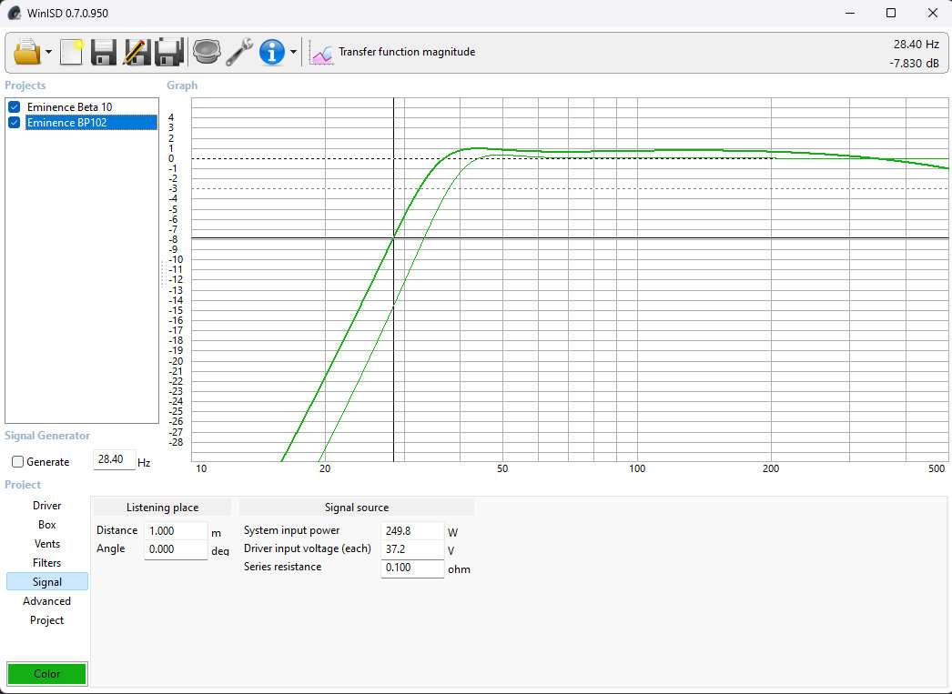

                                #700910
                                  I’ve been majorly misinterpreted!
                                  I suggest Dave you look at en.wikipedia.org/wiki/Thiele/Small_parameters and download WinISD.
                                  For most speakers, the resonant frequency is effectively their low-frequency cut-off, below which the speaker becomes less efficient. You can’t avoid the resonance of the driver, it’s an inherent property of the driver. What you do is tune the enclosure (either by choosing a specific volume or making it into a tuned cavity by using one or more ports) to flatten out the resonant peak into an extended bass response. The ‘shape’ of the curve will depend on intended use, as for some applications a bit of a ‘hump’ at the bottom of the range is useful, or you can trade extended response for reduced efficiency.
                                  Below in the blue example the resonance at 600Hz could cause problems (Qtc is the inverse of the damping ratio i.e. a measure of resonance).
                                  The green line is an ‘ideal’ response for a flat response speaker.
                                  The red line is over-extended so you don’t get any useful extension compared to the green line.
                                  As a bass player, I’m very into what happens with bass cabs. It’s incredible what you can get these days compared to forty years ago!
                                  For the last couple of years I’ve been using one of these at-212-slim. This sounds amazing with music played through it, although it does have a very slight ‘mid scoop’.
                                  For interest, here’s a comparison I made between two speakers, you can see that the more efficient speaker with better response below 40Hz starts to drop off around 500Hz (but only -2dB as the x axis is stretched a bit).
                                  temp
