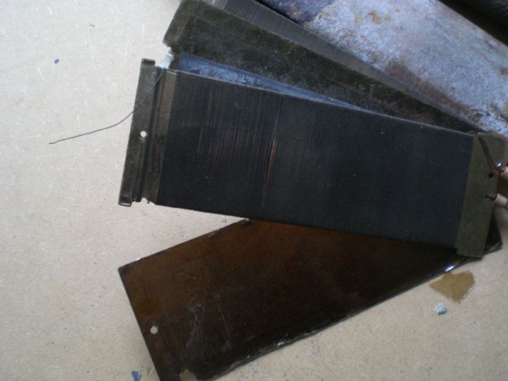

                                Posted by Pete Rimmer on 14/02/2020 18:15:18:
                                Posted by mick H on 10/02/2020 09:48:51:
                                My usual soldering iron failed over the weekend so I dug out a Henly Solon 25W iron which I bought as used/new some years ago. Sadly this also failed after about 10 minutes work on electronic components. When I stripped it down the heating element seemed to have suffered a partial disintegration. Working on the principle that I have never had anything but a positive response from the members of this site, I thought it worth asking whether Solon spares are available at possibly some remote outpost ?
                                Mick
                                I think that the old Solon elements were insulated with asbestos, so you might want to take care with the debris of a disintegrated one.
                                Hi, I didn't find any asbestos in this old 250W Solon iron. The element is wound on Mica sheet and Mica sheets separate the two elements from each other with two narrower thin iron plates in the middle and Mica sheets insulated the elements on the outside, the whole assemble then fitted into the slot of the copper bit.
                                The outside Mica sheets just fell to bits during disassemble. Wont bother to try and fix this one, but might mount the copper bit onto a piece of steel and heat it in a flame, maybe one day.
                                Regards Nick.
