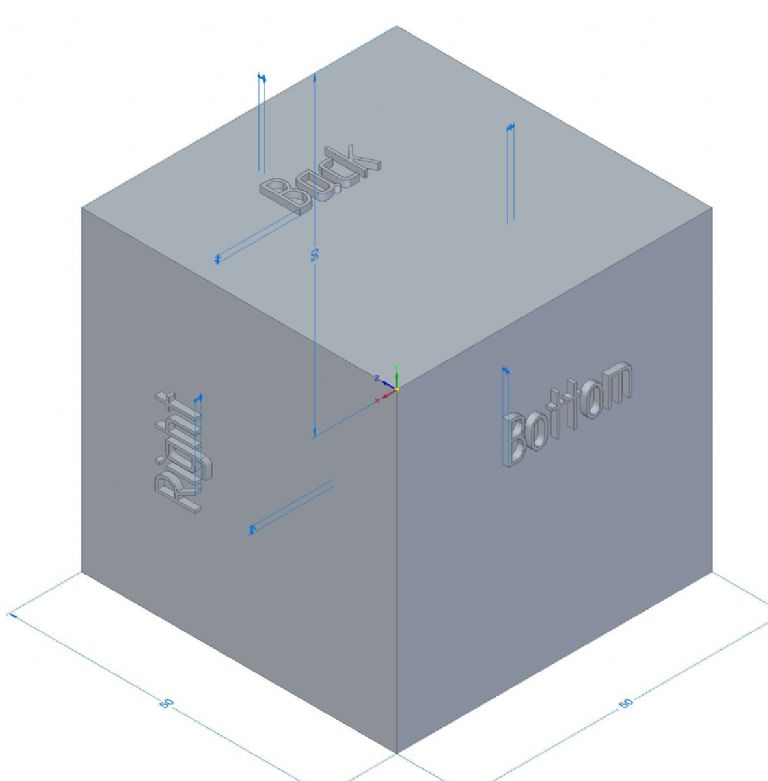

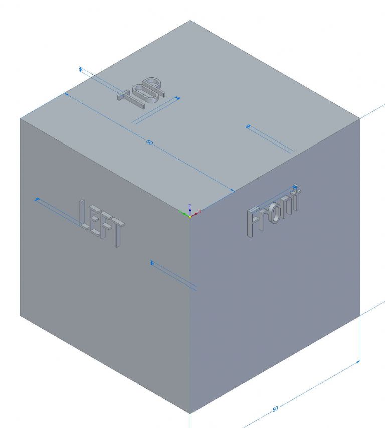

                                Perhaps off-topic, but i wonder can anyone help me with Text in Solid Edge Community edition.
                                I can place text on a surface or on one of the primary surface planes or I can create a new plane for the text and project to the surface . But if i put text onto the back of the surface or plane the text is a mirror and back to front. I can find no way to either orientate to the back of a plane or to change the direction of the text.
                                Not sure if I am explaining myself very well, but, for example, I can put text onto the top surface of an object but if I try to place the same text on the bottom it is still orientated as for the top and I end up with text which is back to front.
                                i am using Solid Edge Community edition 2020 ( which doesn't expire) and Windows 11
                                Any help appreciated. I have looked at YouTube videos but they don't seem to deal with this problem.

                                  Can you post some screen shots and description Gerard?
                                  I can't recreate this effect with CE2023 (which I've just installed), and don't recall 2022 behaving as you describe either. But the product may have changed since your 2020 version, or I'm doing something different. I can write a text object to any face, and it's the right way round. I can then Quickpick the text as a Sketch and move or rotate it with the wheel tool.

                                    Below is print output of the sketch in SE. I selected to add text but it positions the text on the 'other side' of the plane and the text becomes a mirror image.

                                      I have played around with a simple cube and can add the text correctly.
                                      So it appears to be a problem with the particular sketch.
                                      I need to go back and do a little more experimenting

                                            My successful experiment was with a cube just like yours, so it seems to work at least on a simple object.
                                            You may be right that there's a problem with your sketch: it is possible to create damaged geometries that behave oddly. I did it yesterday with a dubious extrude, and had to go back a few steps to fix it.
                                            Or maybe the way SE selects faces is the problem. SE doesn't just go for the one on top. Instead, whenever there are a number of nearby possibilities, SE presents a list, and the operator has to choose the one he wants. It's not always obvious. Possibly the back face was selected at this stage?

                                              Agree with Dave that you effectively have the back face selected when inserting the text.
                                              Being a powerful full on industrial CAD I suspect Solid Edge has a way of overlaying a transparent or semi transparent version on the front face of a feature you intend to apply to the back. A handy way to highlight inadvertent punch through or position interference issues. That sort of thing that can be very hard to spot when manually flipping back and forth.
                                              Guaranteed major league confusion if you aren't up to speed with what's going on. CAD programmer rules state that such things should be invoked by an inconspicuous button hidden in an unexpected menu.

                                                Dave, your suggestion that the problem is the way that SE selects the face . Selecting anywhere on the curved cisrcular face created the problem but selecting on the boss at the bottom ( the elevated part containing the two hexagon holes) allowed the correct orientation.
                                                Thanks for taking time to help,
