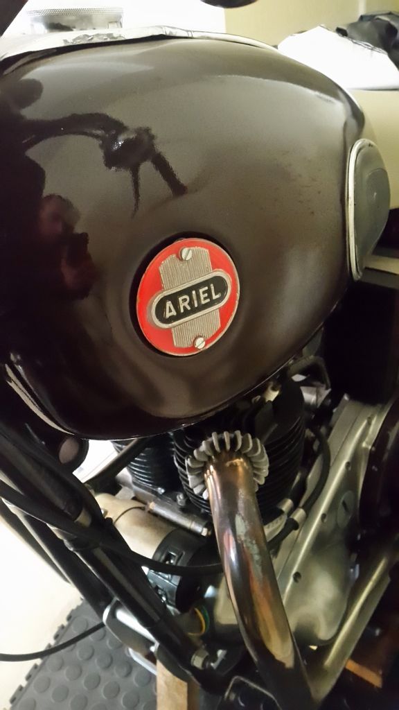

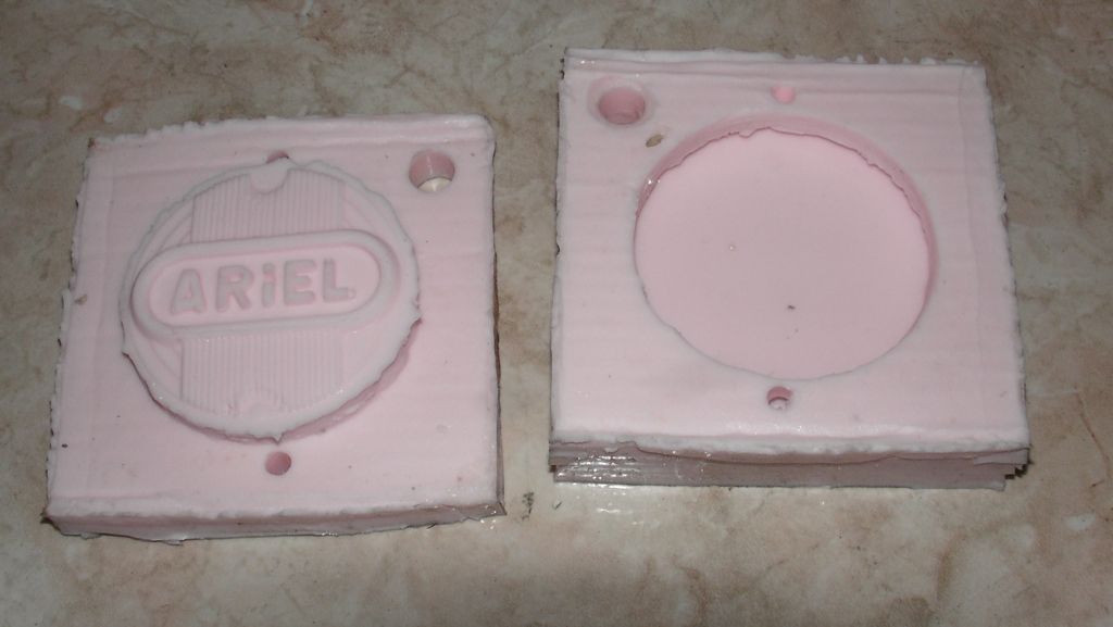

                                        Luker
                                          @luker
                                          Hi Chas,
                                          I honestly don’t know if acetone works on other printer filaments, never tried. In my humble opinion and from my personal experiments fume polishing has less effect on the vertical edges of a print which is where it’s needed most.
                                          The spray is not for porosity it’s to seal the print. If you have hundreds of lines thermally joined there might be places where they don’t join properly. When dipping the pattern the slurry fills these areas causing poor surface quality. If you’re using printed patters for investment moulding the foundry should do a vacuum test. An easy way for you to check is to submerge the pattern in some warm water and check for any bubbles as the air inside the pattern expands.
                                          I think you misunderstand Jason and I RE the flexible (silicone) moulds. The end result is a wax pattern you give to the foundry. A positive is printed using 3D printing (or a sample), the silicone is poured around this (a negative mould), and finally you can pour wax into this mould. I unfortunately don’t have pictures of this exactly but I have used this process to make badges for one of my vintages, the underlining concept should be clear from the pics… Incidentally you don’t need to buy potting silicone, calking silicone with corn starch mixed in and a little terps as thinning agent will also work if you want to experiment a little. Tricks for mixing and releasing agents are in the article…

                                            Chas what you say is a little confusing. In the opening post you say you are having waxes printed and want to improve the WAX surface. Yet in the second reply you say you are taking hard moulds off of presumably solid prints and then casting waxes from those. The two surface treatments will differ depending on if it it wax or a plastic you are wanting to improve the surface of.
                                            Also how do your foundry handle the waxes? if they are being made into a "tree" with wax runners than any non wax surface treatment may affect how they are melted onto the tree.
                                            The other advantage of casting the waxes in a silicon mould is you can pull complex shapes from the silicon that would otherwise need draft angles etc on a solid mould.
