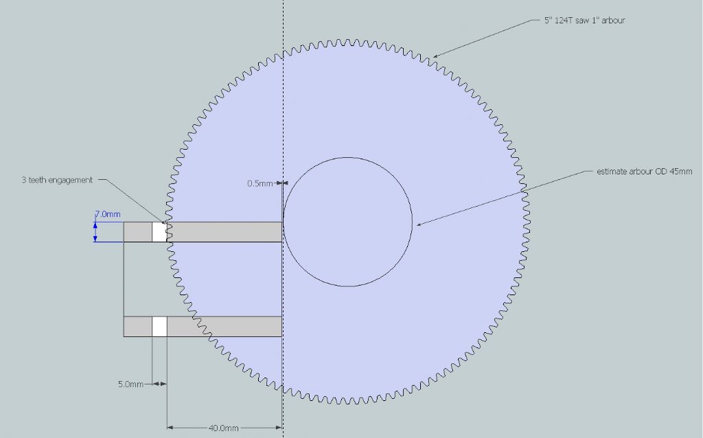

        I need help selecting the right slitting saw for the right material and the right machine.
        I have a WM18 mill and want to cut slots 1mm wide in a hollow bolt with 7mm wall thickness. I'm not sure that the bolt material is but I will take it to be some type of high tensile stainless steel material. ( I'll try to find it's specs if its important)
        I would like to know what type of slitting saw as in diameter, no of teeth, material etc I should use keeping in mind the type of machine I have (speed and feed limitations etc to prevent stalling the machine or burning the cutter)

                  What I want to do is cut along the length, the whole depth i.e 7mm, but short of cutting the whole length. Sort of like a collet. I'll finish the end of the cut by drilling a hole. The material spec is SAE AMS 5935.
                  I'm not sure how well the WM18 can handle low speeds, it does have a low gear range. I would like some advice on what type of saw to get. The fixed parameter is the thickness of 1mm, but with regards to diameter, number of teeth or material I'm at a loss.

                            Thanks Jason, the bolt is 55mm in length by 40mm outer dia (26mm inside dia) with a flange at one end. I want to cut 6 slits 40mm down it's length.
                            I'll try to do some calculations and a drawing to see if I'm reasoning things the right way.
                            The material although tough is approachable by both a file and a hacksaw blade, so I think it's not hardened.
                            PS. What's the O/D of the 1" arbour?

                              A 5'' saw will just pass by a whisker (if my estimate of 45mm od of the 1'' arbour is correct). On e-bay I have seen solid carbide saws if this does not work.

                                The trouble with getting larger diameters of saws is the speed of rotation needs to drop. I would be worried about running an 80mm saw above 30rpm. As for solid carbide saws, they are expensive and very easy to break. Remember that to hold a saw with a 22mm bore requires an arbor of a greater diameter, so you loose cutting depth. There are lots of saws on ebay, some have greater tooth counts, which would be an advantage.
                                Thanks to ChrisB for the diagram, it makes understanding the problems much easier.

                                          Posted by ChrisB on 13/08/2019 09:47:16:
                                          There is very little advantage and lots of disadvantages cutting it the way you show.
                                          Right now, the teeth are cutting almost vertically. It might pay you to reduce the depth of cut so the lowest tooth on the saw just breaks through the wall of the tube. In this way, the teeth are cutting much closer to horizontally and the length of cut is at its maximum.
                                          If you have some spare material, or similar material, turn up a close fitting plug for the bore and low-strength loctite it in. This will greatly increase the rigidity of the part and stop it flexing and trapping the saw as more cuts are put into it. Slitting saws do not like vibration. With the plug, and semi-horizontal cutting, you might be able to sneak a centre and tailstock support in. Even if not, support the outboard end with a jack.
                                          Consider the pros and cons of conventional versus climb cutting here. Conventional will try to lift the part off the table, but you are always driving the work into the saw. Climb will push it down onto the table but the saw will try to self-feed.
                                          Me, I'd grind the set off a hacksaw blade, sandwich it between two parallel guides and be done with it. Was it Sir Tubal or Uncle George who ground teeth in a feeler gauge to cut a very narrow slot?

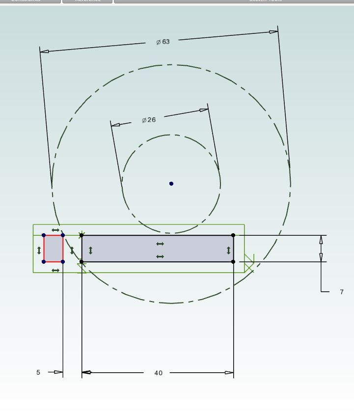

                                            You could actually do it with a 63mm saw on a 1" OD arbor and still be able to get your stress relief holes in if you cut each slot individually feeding along the bolts length.

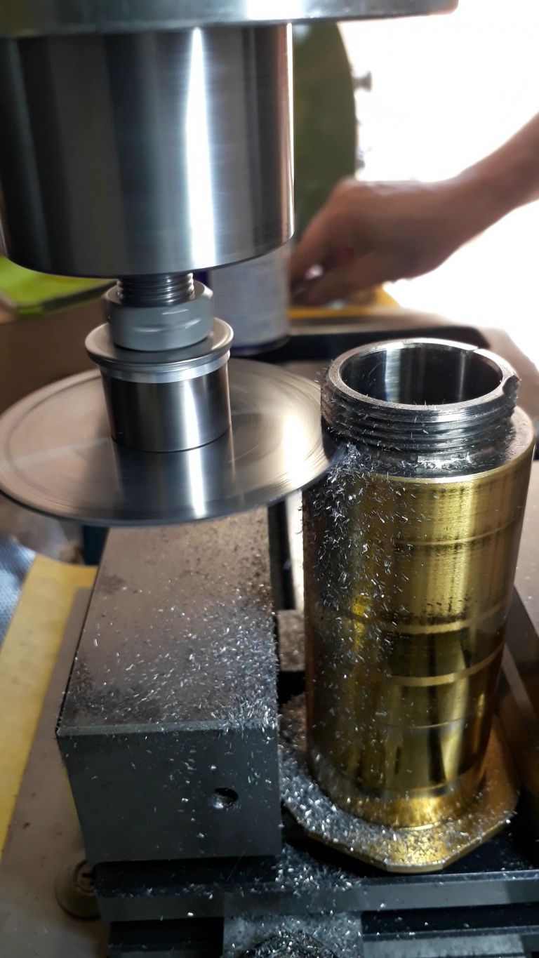

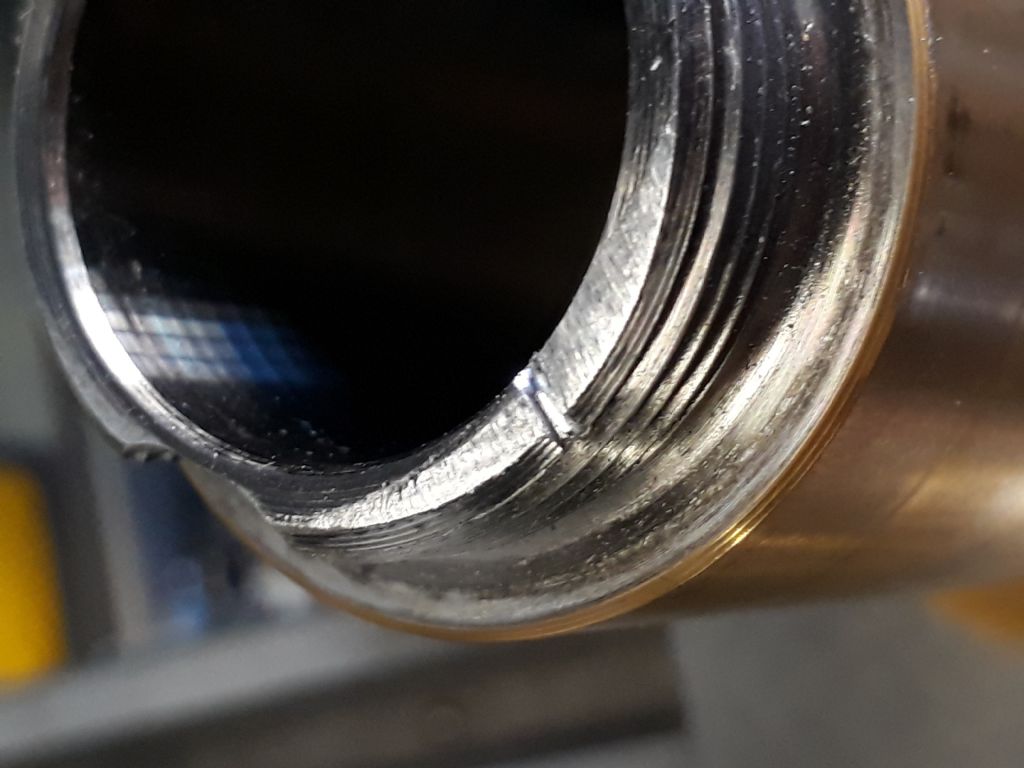

                                              Received three solid carbide slitting saws I bid on last week. A bargain for £15.
                                              Made a 16mm arbor for the 63mm saw and tested the saw on the bolt I want to cut. Set the machine on low gear at 150rpm feeding slowly at roughly 0.25mm/sec with a 2mm depth of cut. All went well cutter cuts nicely and all teeth were still there after the test cuts.
