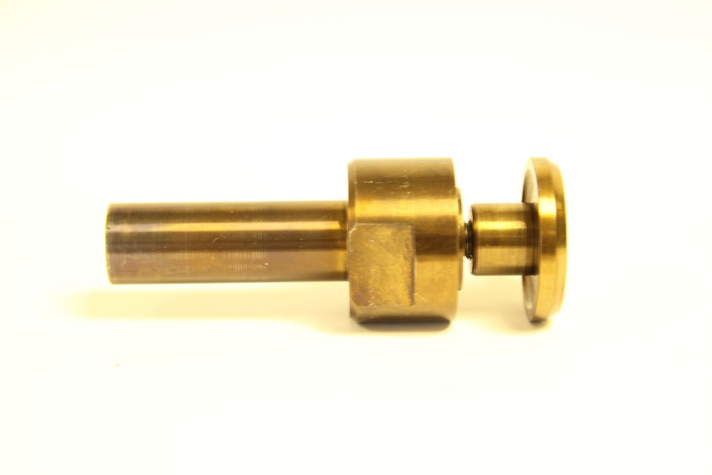

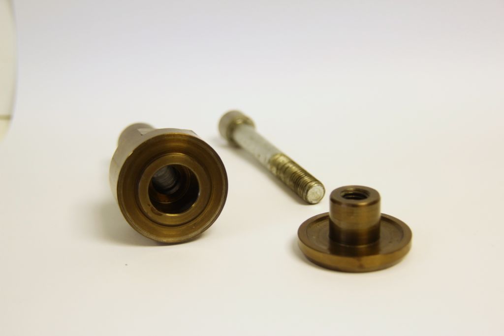

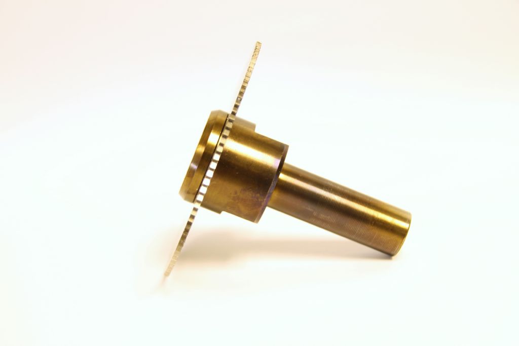

      img_2122.jpgimg_2124.jpgA recent enquiry regarding slitting saw holders prompted me to post my design for such a device. I developed this holder about 15 years ago, it works well and I have also made a couple that have been used successfully in a production environment. If you make this,you will have really useful bit of kit. It is self tightening but a key could be added if you had to reverse the cutter direction,(I never needed a key). I had drawings, but can't get them onto my new system so I offer photos and explanation as a substitute.
      The main body diameter is 39mm. and the shank dia is 20mm. this is to accommodate the M10 x 85 cap-head screw that clamps the flanged nut from the back, enabling close proximity to the work-piece. The locating spigot is 25.35 dia x 1.5mm.with a minimal u/cut. Overall length of body 32.5mm and the shank length is 60mm. fFats are machined on the body (34 a/f)to assist with tightening. The body is bored to 19.05mm x 27.5 deep.
      The flanged nut is 39mm dia.x 5.5mm thick and the body is turned to 19.00mm dia x 22 long. the flange is under cut 1.5mm deep.
      The general concept can,of course,be modified to suit. Replacing with ​an M8 cap-head screw would enable a smaller dia shank, for instance.img_2121.jpg

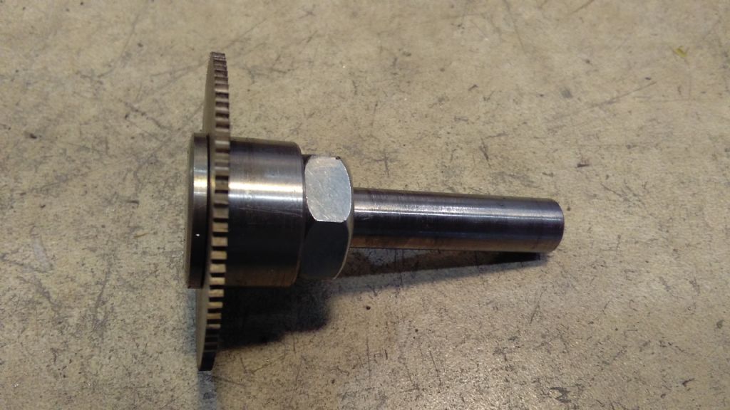

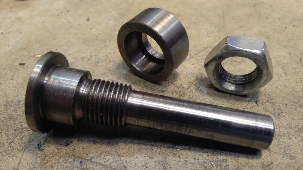

                        My version of a slitting saw arbor is similar, but different!

                                Both seem nice designs. I presume the clamping force for the saw must be as far outward as possible ? In the first design I see some recesses but not in the second. Is it flat?
                                #345329
                                Nigel Taylor 2
                                  @nigeltaylor2
                                  I've not found a problem of the nut undoing, and, yes, the clamping face is flat.

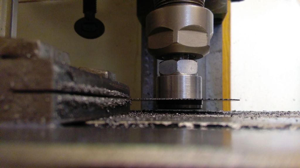

                                  When I got a set of slitting saws and an arbor, I found the arbor made positioning the workpiece awkward. I also thought it looked clumsy so I designed and made a low-profile version. My slitting saws are 5/8 inch internal diameter, so that is the size of the bottom portion. The flange is 7/8 inch diameter and 3/32 inch thick. The collar is bored out to 5/8 inch with a stepped diameter. The smaller end is a close fit over the thread. I choose to use a ½ inch UNF nut, partly because I liked the finer pitch compared to using M12 and also to try screwcutting an ‘imperial’ (American) thread on a metric lathe using just the standard changewheels. The shank is 10mm diameter, to suit an ER20 collet. This picture shows the arbor in use. When I made it, I slightly undercut the ‘corner’ by mistake, so I have to use a spacer when using very thin saws. However, my arbor design meant I could clamp the 12mm square piece directly to the mill table to cut the slit in it.arbour photo 3.jpg

                                    Posted by Nigel Taylor 2 on 10/03/2018 12:27:35:
                                    Thanks for the info Nigel, now on the list of projects, it has to be much better than the multi-diameter one I use at the moment.
