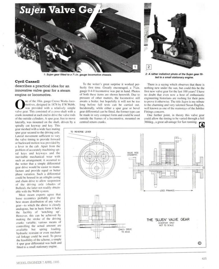

                  duncan webster 1
                    @duncanwebster1
                    You could look at SUJEN valve gear. It's a bit like slip eccentric, but you can power it from forward to reverse. Despite it's inventors claims it cannot deliver variable cut off. It was described in ME, I've tried googling to no avail. The eccentric is driven by a train of gears and you can change the angle of advance by moving the idler gears.
                    #259627
                    Ady1
                      @ady1
                      Heres a SUJEN article from 1996 (ME 3990)
