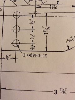

      image1 (1).jpgHello,
      I was wondering if somone could help me out on this.
      I'ts been many years since i have read a drawing of this type, as you can see from the image i wan't to know what 3 x .189 holes means? i understand that 3 x stands for the amout of holes but i don't undertsand what the .189 means?
      I am use to working in imperial but can't remember seeing this.
      Thank you very much!
      Cheers
      Rob

        #175882
        Speedy Builder5
          @speedybuilder5
          3 Holes each hole 0.189 inches in diameter. This would be a number 12 drill (Nearest fractional drill is 3/16 inch diameter). I am guessing that the holes are either for 2Ba bolts or (perhaps 3/16 BSF – which are not quite so readily available).

          Bikepete
            @bikepete
            Presumably just 0.189 of an inch, i.e. just under 1/5 of an inch. So just the decimal way, rather than fractional, of expressing the size in inches.
            A quick lookup e.g. here suggests a 4.8mm or No. 12 drill would be used to make that size of hole.

            stevetee
              @stevetee
              A long time since I worked in Engineering , but .189 is 1 1/2 thou larger than 3/16" . So a 3/16 rivet or screw would go through the hole, but it would be quite a tight ( transitional) fit. Does that make any sense.
              Where I worked it would have been represented as 3/16+.0015 , probably with some limits applied . From what I remember if just the size in fractions was given it would be plus or minus .005 , the .198 would represent a dimension with a tight tolerance on it.

                Raymond Hodges
                  @raymondhodges20973
                  its also 4.80mm

                      What I don't understand is why the holes aren't marked 3 x No. 12
                      #175908
                      Bodgit Fixit and Run
                        @bodgitfixitandrun
                        Posted by Neil Wyatt on 13/01/2015 18:02:38:
                        Could be that they realised that someone might not know what a No. 12 was, unless they were ordering a chinese takeaway? angel 2
