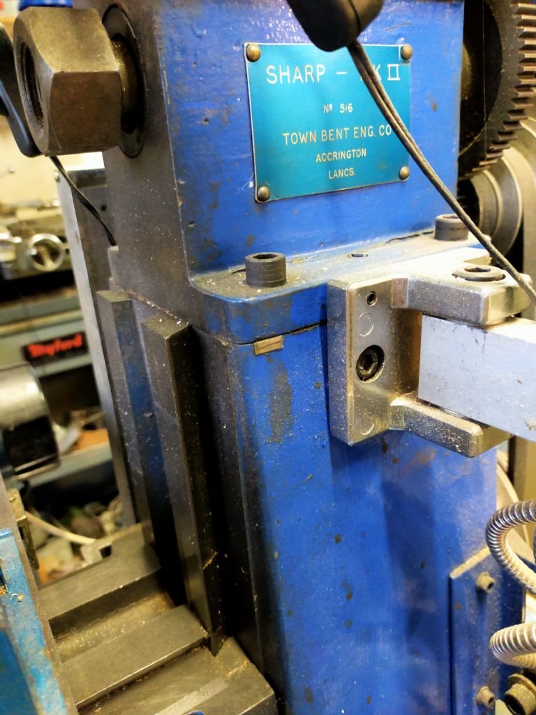

      I know some of you have Sharp mk2 milling machines made by Town Bent Engineering.
      Having cleaned and got my new purchase running, I now want to set it up and test it.
      It appears to me that the only way of locking the head in its vertical position is by knocking its tapered pin in to lock the head to the body and then clamping up the split body clamps onto the main support shaft. On mine the tapered pin has a depth nut and a black knob on it which on the right hand side of the head.
      Am I right in thinking that once that tapered pin is home the head is set and trammed to the table.
      I can see no other ways of locking head.
      I ask as my milling table seems to have a small lean to the right of vertical.
      Help please!
      Roger.

          I would put a test indicator in the vertical spindle and check it in 4 positions to make sure it is true to the bed.
          I’’;f you have one, use a parallel on the mill bed rather than run it across the tee slots or you might ruin the test indicator.
          I don’t have one of these mills but suggest the locking not is actually used to extract the taper pin.

              As David says, the nut is used to extract the taper pin. I gently tap mine home. The tram can be adjusted if necessary with shims at the column split. I've had a small piece in mine for the last thirty years.

                Thanks for your reply.
                I have done the dti check that's how I know the bed isn't true to the vertical head.
                Unlike other mills, the sharp mk2 doesn't have an adjustable system with locking bolts.
                It just has this locating pin system.
                Hence my request for help from other Sharp Mk2 users.
                I don't want to touch the bed until I know the head locking system is correct.
                Roger.

                  Thanks Rod.
                  I didn't think of that shim idea.
                  So in short – the tapered pin does locate the head and stop it moving.
                  I looks to me as if the table has been badly stoned as it has low spots in places and high stops in others.
                  Your shim idea wouldn't sort that out but would improve the over all level.

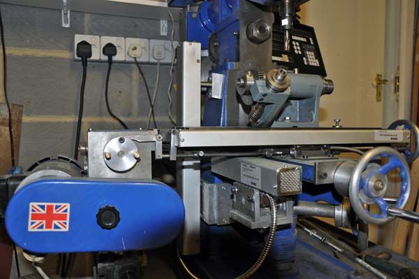

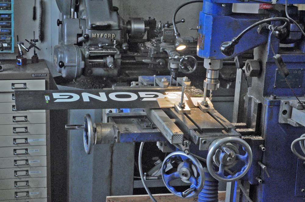

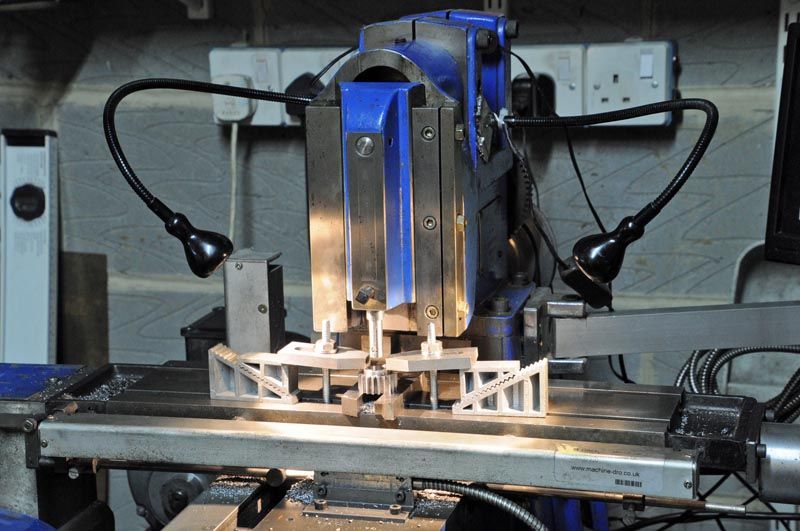

                                Posted by Darren Elmslie on 10/01/2023 19:24:22:
                                I've been considering one of these myself for the occasional, light model engineering work I’d require of it.
                                The size and interoperability with my existing Myford tooling are the main appeals, given it gets favourable reports by owners.
                                The one I’m considering at the moment is a Mk2 (I haven’t really heard any mention of the Mk1 though to be honest!) However some picture have a front and rear greasing nipple on the side for the bearings on the horizontal shaft whereas some photos show a single, central nipple. Does anyone happen to know if these differences signify earlier or later versions – perhaps the earlier or Mk1 models had a single nipple whilst the Mk2 had a pair? Logic would suggest a greasing point on each bearing would be an improvement which was made?
                                Rod – I'd be very interested to see some more photos of yours, including the 3-axis DRO if you ever get the time? That must make a decent machine into a real little gem.
                                Kind regards
                                Darren
                                Here's a random selection of photos of the mill taken from my various albums. I bought mine new from Town Bent and included the slotter and power feed. I have changed the drive to VFD with 2 pulley speeds which eliminates the rather noisy intermediate pulley. The DRO was fitted a few years ago and I had to sacrifice the stops on the X axis to fit the scale. Any more details that you need let me know and I'll take some more relevant photos.
                                Cheers,
                                Rod

                                Darren Elmslie
                                  @darrenelmslie40596
                                  Brilliant, Cheers Rod, much obliged. Looks as though yours also has the fore-and-aft grease points.
                                  Like the work light additions you've made to it

                                                  @rogerdavis4
                                                  Rod.
                                                  I see you have fitted a dro / scales on your Sharp mk2, I was thinking about fitting one.
                                                  I've looked to find more pictures of your sharp mk2 which appears to be the one produced after mine (515).
                                                  Have you any close up pictures of your scale fittings points together with any tips on fitting.
                                                  Roger
