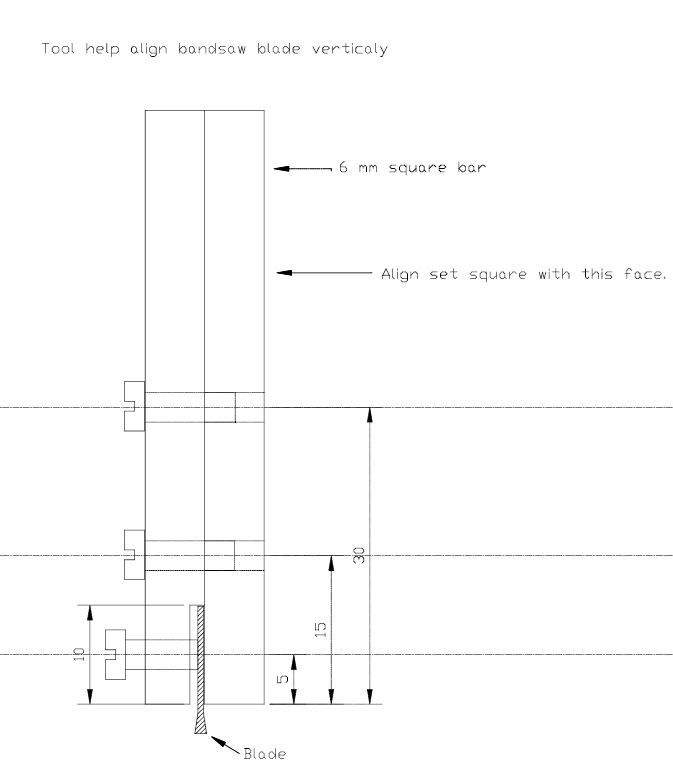

                  This is not related to blade tracking but it may help you to set it up to cut square in the vertical plane. This is a very simple tool I made from some 1/4" square bar. It clamps onto the blade to allow it to be aligned with a set square held against the base.blade setting tool.jpg
                  Les.

                    Thanks for that. I have a very early version with imperial threads and despite looking through the manual twice I couldn't find anything on setting the bearings.
                    the tool is a good idea, I'll make one later!
