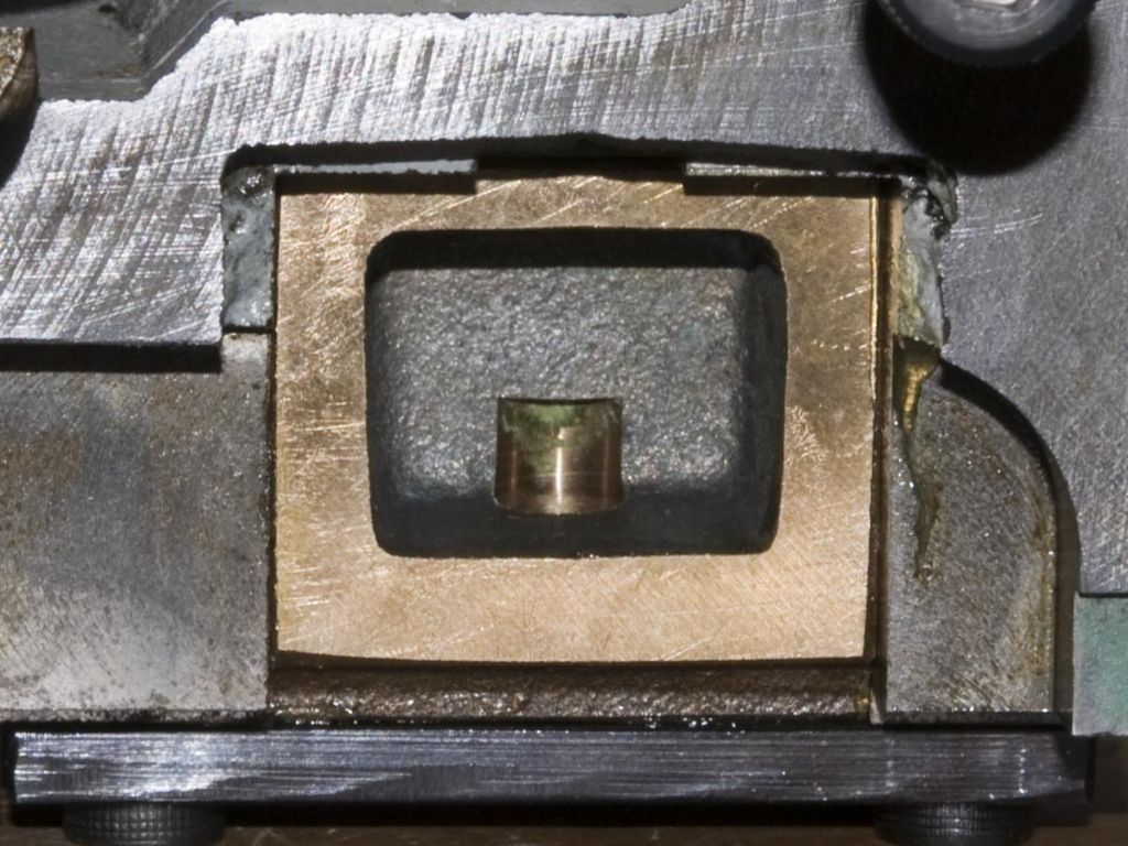

      (2) There is what looks like a small oil reservoir on top of the leadscrew nut. I don't think that it can be a reservoir because (a) there is no obvious way of filling it save for removing the apron, and (b) any oil would flow straight out.

              There is an oil bath in the apron that lubricates the power feed gears. There is a plug for draining the oil at the bottom of the apron and access to add oil at the top.

                      Yes, thank you, I know about that, but why does the leadscrew nut have what looks like a reservoir? It cannot be one because the oil would simply run out. Odd!

                          Not sure what that recess in the lead screw nut is. To be honest I have never actually dismantled my apron. To lubricate the lead screw when screwcutting I just apply a very occasional squirt of oil direct to the lead screw.
