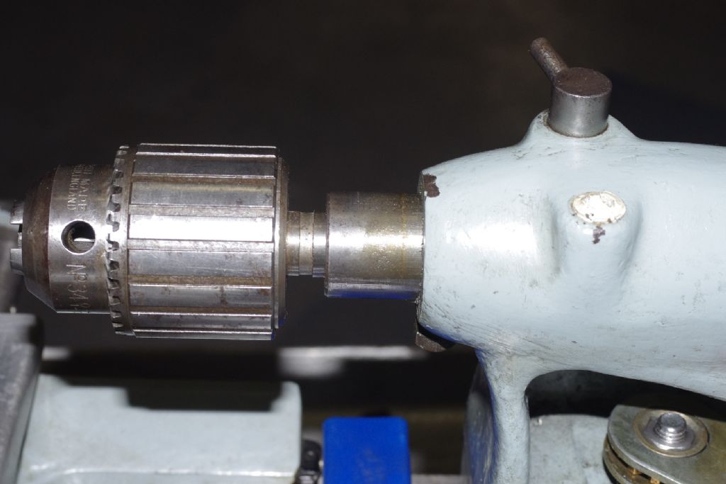

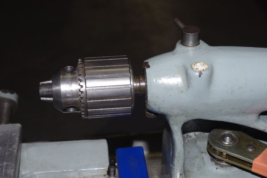

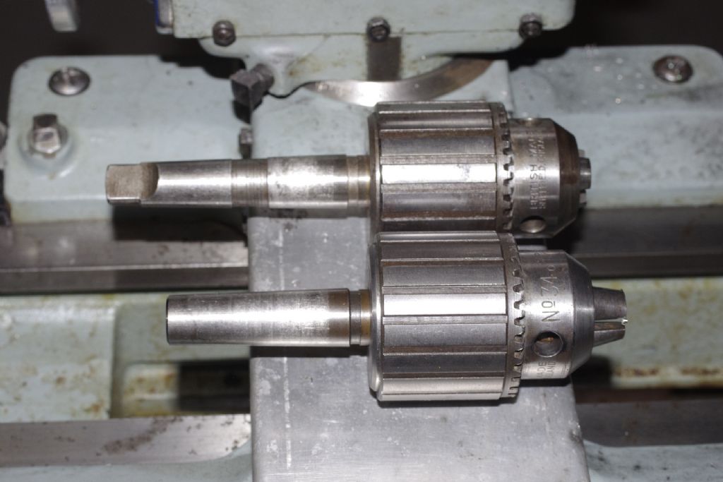

      _igp3102.jpg_igp3101.jpg_igp3100.jpg_igp3099.jpgA common drawback with smaller lathes is the length of the Morse taper if it has a tang. The tang was intended to be used for extraction with a wedge through a cross slot, but not all lathe tailstocks utilise this feature. Self extraction is common and both my 7 x 12 Chinese and the Atlas 12 x 24 at the museum have it and this limits the stroke of the quill by 1". Only an inch, but a handicap when the between centres is only 12" and even the Atlas only has 2" movement when it has 3" of graduations. The ansver is to shorten the MT by removing the tang and turning the end to allow just enough to break the taper. I have shortened both Chinese and genuine Jacobs MT's and drilled the ends. There will be some pictures when I get them added to my album.

                The tangless arbor is the best of all worlds use with a drawbar, with a screwed in tang for the drill press, and a screwed in plug for self extractors. The first picture is of the 5/16" Kawasaki chuck used on my 7 X 12, the hole allows a greater length of MT while extracting about 1 1/2 turns before the leadscrew bottoms. The end for the Atlas is flat because the end of the leadscrew fills the small end of the MT socket. I already had the tanged arbors

                            If anyone is thinking of shortening their arbor to gain centre distance and quill stroke, here is the method I used. Hold the front of the chuck and use a centre to support the tang end. Using a carbide insert, turn the end down about 0.020", 0.5mm, having already decided exactly where the new end should be. Then you should be able to use a hacksaw to cut the end off, parting is not recommended as the work is not supported well enough. You may be able to face off the end if the lathe chuck gives enough support, otherwise grind, linish or file the end flat.
