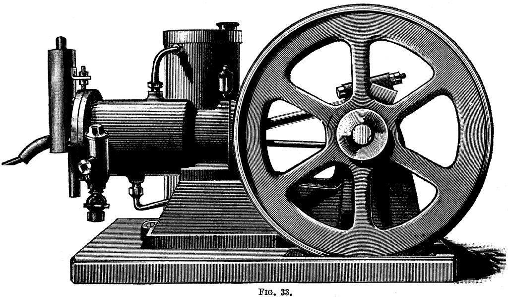

      Introduction: The Boy's Own Paper published five articles in 1895 describing the construction of a horizontal gas engine. It is said that this design provided the inspiration for the first Petter gas engine. I discovered the articles during the seventies, and have finally found time to study them. I hope, if possible, to build an engine.
      The Engine: This is a single cylinder four-stroke of 1 1/2" bore and 2 7/8"stroke , with hot tube ignition and a built in water jacket. It is set up to run on town gas, but for country dwellers there is also an evaporator to make your own gas from gasoline. It can be made entirely on a 3 1/2" gap-bed lathe with backgear. A small planing machine would also be useful, as would an overhead milling attachment for gear cutting in the lathe…
      A full set of castings is available from Jackson & Co. of High Street, Brentford, price £2 10s, and a full size drawing for a further 5s.
      Progress so far: I have disentangled the labyrinthine Victorian prose, but the woodcuts, though they are many, have defeated me. They are distinctly not to scale and yield conflicting results when stepping off with dividers from known dimensions.For example, the flywheel appears to be somewhere between 10" and 14" in diameter when scaled up from the views I have. Jackson & Co. seem to have moved without leaving a forwarding address, so at present I am faced with making a 'recreation in the style of' rather than an authentic reproduction.
      My Quest: is to track down a surviving example, a set of castings, or (a chance in a million) the full size drawing so I can get some accurate dimensions. My guess is that a number of castings were bought and started, very few were finished, and there may be one copy of the drawing surviving in a pile of papers somewhere. I'd gladly give 7/6d for a copy! Identifying the engine wouldn't be easy because as far as I can tell there were no identifying marks on the castings.
      My Request: I have corresponded with Geoff Challinor of the Anson Engine Museum, who has heard of it but never seen one. So, any information, suggestions of places I might look, more people I might ask, piles of paper I might search through… anything will be welcome.

                        Well over 650 viewings of this thread so far, but no sightings of the elusive machine. I'm not really surprised, but I'll keep looking. People have been very helpful, and some have heard of the Boy's Own Model Gas Engine but never seen one. The search continues. It has been suggested to me that there may have been an article in a magazine, possibly 'Stationary Engine', which talked about the Boy's Own Engine. Any ideas?
                        Looking for Jackson's in Brentford High Street has not so much drawn a blank as thrown up a puzzle, as Jackson's never were at 363, so the dream of a copy in the firm's archives crumbles to dust (it's astonishing how many nineteenth century firms are still in existence).
                        Next thing is to try to track down the family of H.F. Hobden, the author of the articles. He was obviously a very competent engineer and a regular contributor to the Boy's Own Paper, so a proud family may have a copy in the family archives waiting to be discovered. The likeliest thing is that there is a completed example sitting in a collection somewhere, but nobody knows what it is.
                        In parallel with these searches I have started 'reverse engineering' the design from the BOP articles, with the intention of making patterns, getting castings, and making an engine. It is very challenging to obtain dimensions from woodcut illustrations which were described by the author as 'not to scale' . However, I have some of the critical dimensions from the text, and the rest should be able to follow. I'll keep you informed.

                              The OP says: at present I am faced with making a 'recreation in the style of' rather than an authentic reproduction
                              Can I suggest that this would be entirely in the way that the original Boys would have approached it. In my limited experience such articles rarely 'worked' in any exact sense, so anyone that persevered would find details which had to be guessed. I had a book called 'Build your own motorcycle' from 1905 which included advice such as 'Get the local blacksmith to make your connecting rod …' and showed a sketch of what was required. And when it came to ignition it was entirely void of useful information. I lent the book to an engineer and never saw it again.
                              Except that most of the Boys would have thought 'Jolly interesting' and done nothing more. I expect that Jackson & Co went out of business because of the stock of castings which nobody ever ordered.
                              And anyway, how many of the original Boys will be around to point out any alleged deviations in your version?
                              Finally, when you get that far, the 'petrol' which was used in those days was much more volatile than the modern stuff; I think 'petroleum ether' is more like what you need. And good luck with evaporating that in your cosy wooden shed…
