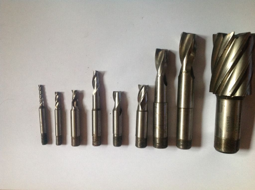

      All my end mills are getting blunt so I scoured ebay for some new ones to find that the majority for sale are straight shank. I like the security that the screwed shank gives – they're not going to work themselves out of the chuck and deepen the cut. But are they now obsolete? Does everyone now use ER collets to hold end mills?

                  They are still quite available here in NZ, bought a couple of slot drills yesterday, there were three brands of standard length, I bought the cheapest Sonta from South Africa, and a long series one by Trubor UK, in both types the local Patience & Nicholson ones were quite a bit dearer.

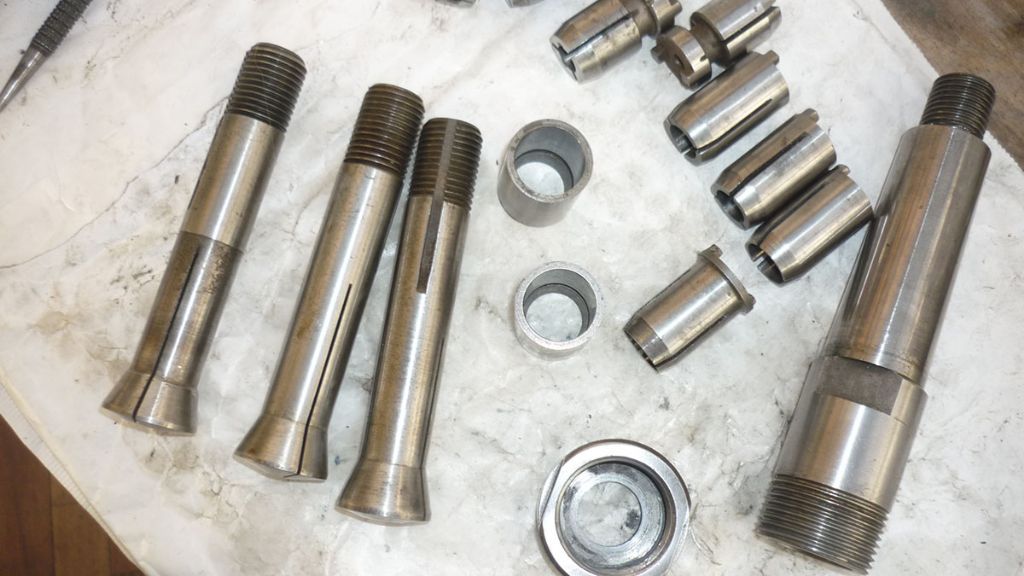

                    Im busy looking for screw shank mills to fit a Clarkson older` type c `chuck that came with my mill.
                    I have a question, does the screw size of the cutter = the shank size.
                    For instance i have 1/4",3/8", 1/2" and 5/8" collets which are unmarked. Would a 15/32 " screwed shank cutter fit in the 1/2" collet (i.e screw in?) or do you need a 15/32" collet?
                    Edited By mark smith 20 on 01/11/2016 12:21:01
                    #264170
                    Mike Poole
                      @mikepoole82104

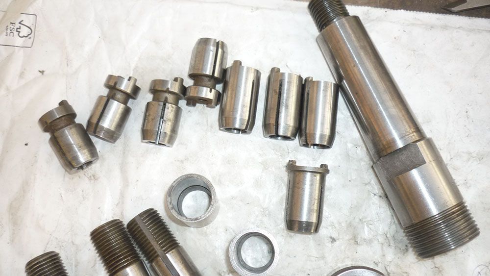

                      I think those are the standard Clarkson collets, sizes that fall between those collets are on one of the standard shanks. Metric cutters are on metric shanks and will require metric collets that usually have a line machined around the driving flange. The metric collets are 6, 10, 12 and 16 for the small collet chuck.
                      Mike
                      #264173
                      mark smith 20
                        @marksmith20
                        Hi Michael so a 15/32" shank cutter should fit in the 1/2" clarkson `c type collet?
                        The collets are the type with two prongs at the back. Ive never came across this type of clarkson before .
                        I have 3 original collets, the long ones in the photo,which came with the mill in 1/4",1/2" and 5/8" sizes , i assume these take either screwed or plain shank cutters but they have to be the correct exact size??p1300138.jpg

                          I would expect it to be mounted on a 1/2" shank so yes it would.

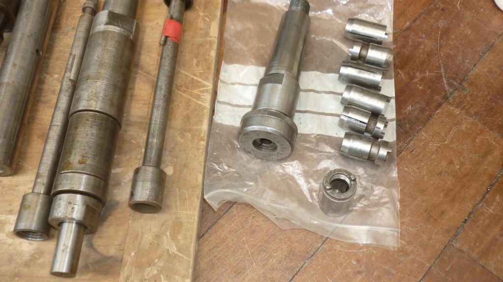

                          Nobby
                            @nobby
                            Hi Otley & Guys
                            To use plain cutters in an Autolock Slice the end of a old cutter and make what we called a dummy centre
                            Please see photo> Screw into collect fit in holder a tighten up Try it
                            Nobby

                              Here is a selection on cutters on shanks different from the cutter size, as you see some are larger than the shank. Clarkson Autolock chucks of all types use the same basic collet sizes but the actual collet design did change with the different models.

                                The three long collets are nothing to do with the clarkson system but as you say they will take the screwed shank type of cutter as long as it is a fit for the collet. The screwed shank will be of no benefit but will not be a problem as long as the collet has a good length of plain shank to grip.
