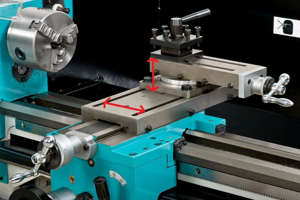

        A bit of an odd request.
        Would an SC4 owner be kind enough to tell me the distance between the T slots on the top of the carriage, and the approximate stack height from the top of the carriage to the top of the compound slide.
        I just need to get an idea of the size of the chunk of iron required to replace the compound slide.
        Many thanks
        #414876
          A 'Gibraltar' base for the toolpost?
          Slots are 76mm between centres (could be intended to be 3" but I measured 76.1).
          Stack height is 42.74mm
          Threading for the standard toolpost is, from memory, M12

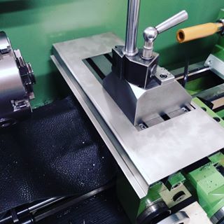

          #414924
          Stuart
            @stuart18648
            Thank a lot for that Neil.
            Hopefully it should be similar to Stefan Gotteswinter's creation.
