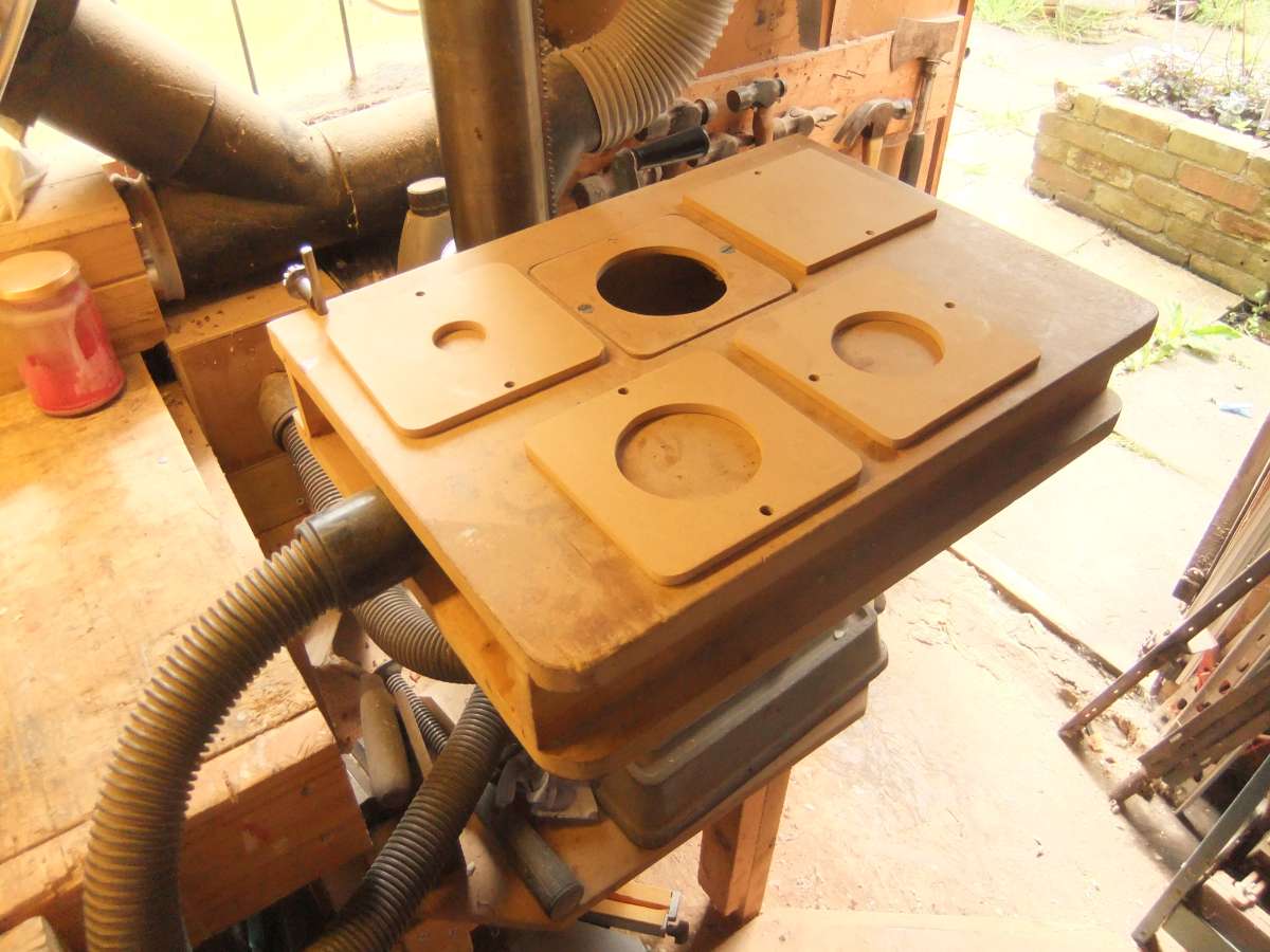

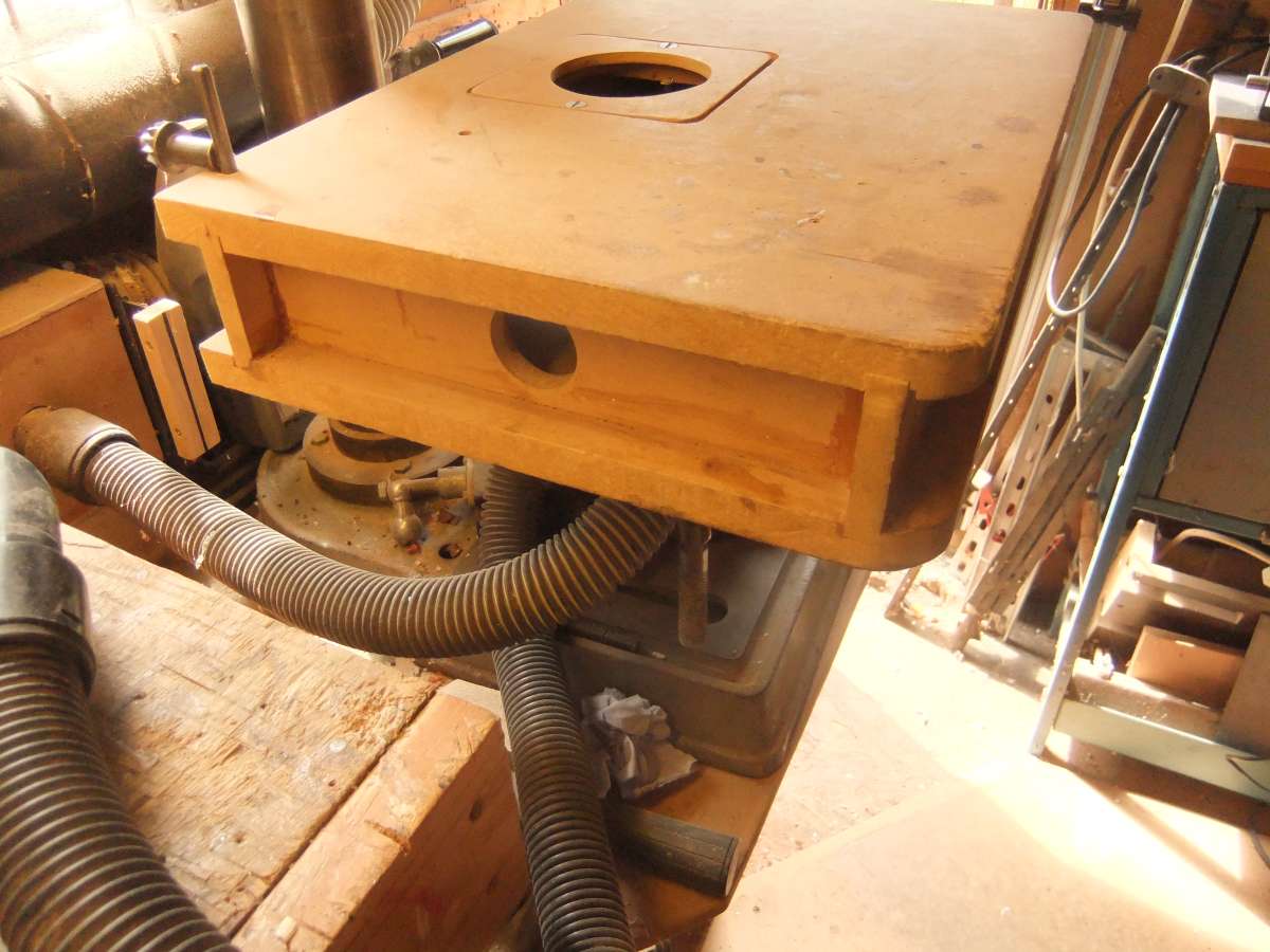

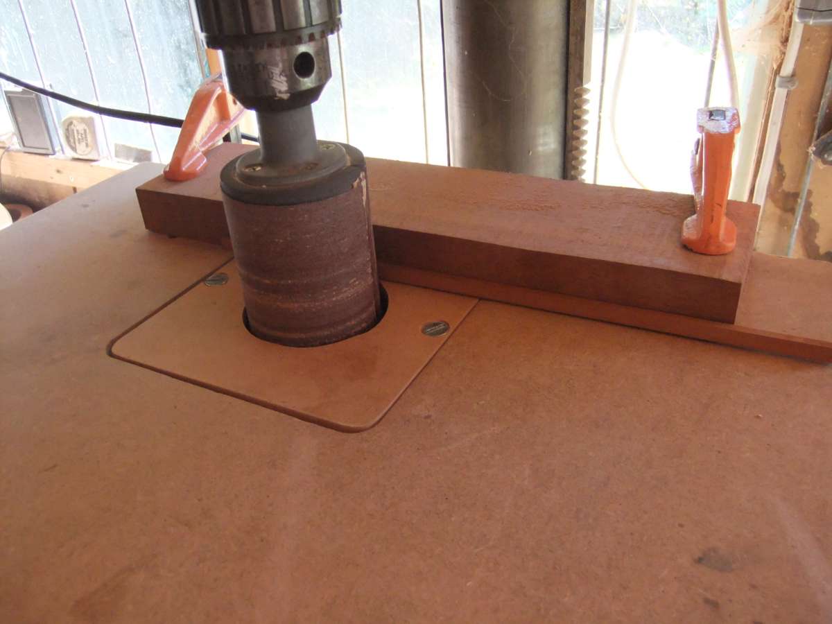

                      Dalboy
                        @dalboy
                        I made this in 2016 for my drum sanders I use in the drill press with interchangeable sized holes for the different drums I have. For a fence I just clamp a straight piece to it. Not only for sanding odd shapes but using it as a sander thicknesser for smaller pieces of wood. Complete with dust extraction, I can raise the table, so the drum goes in allowing me to use all the paper from top to bottom of the drum.
                        DSCF6174DSCF6176
                        Just found a picture of use as a thicknesser
                        DSCF1953

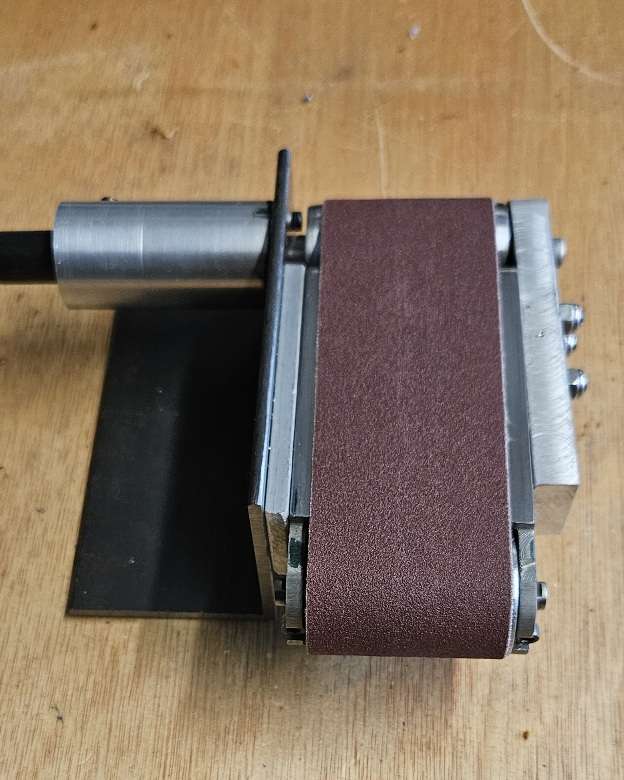

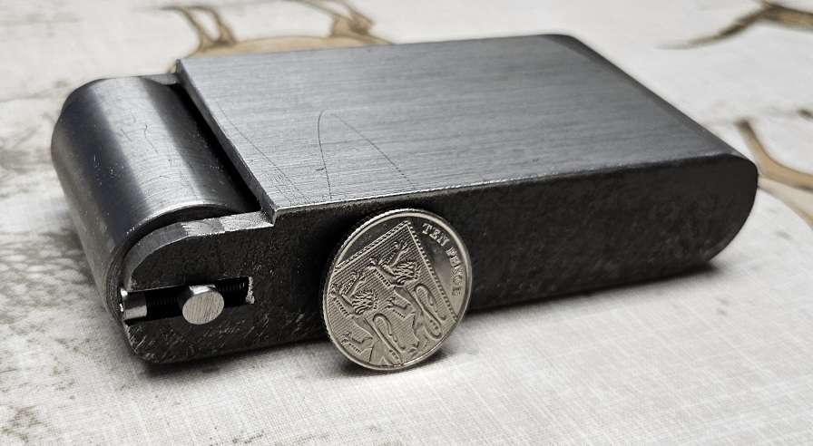

                                  Plasma
                                    @plasma
                                    Like many I don’t think the quill of a pillar drill is suitable for sanding. I would be loath to tie up the pillar drill to do bobbin sanding, if I was that much into woodwork I would look at a dedicated machine.
                                    I did build a miniature linisher recently, I liked the look of the Proxxon machine but thought it was expensive for what it was.
                                    So I bought the belts for their sander and made a bench mounted linishing deck.
                                    Power comes from my Foredom bench polisher via a flexible drive.
                                    20240329_18413720240410_135955
