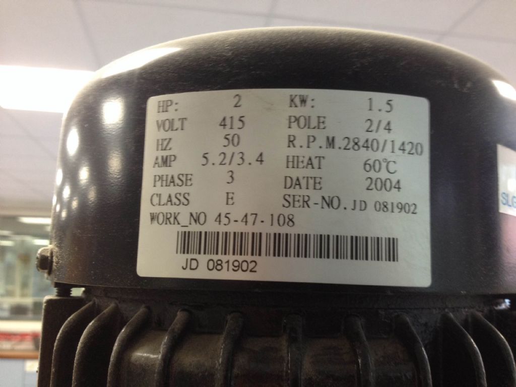

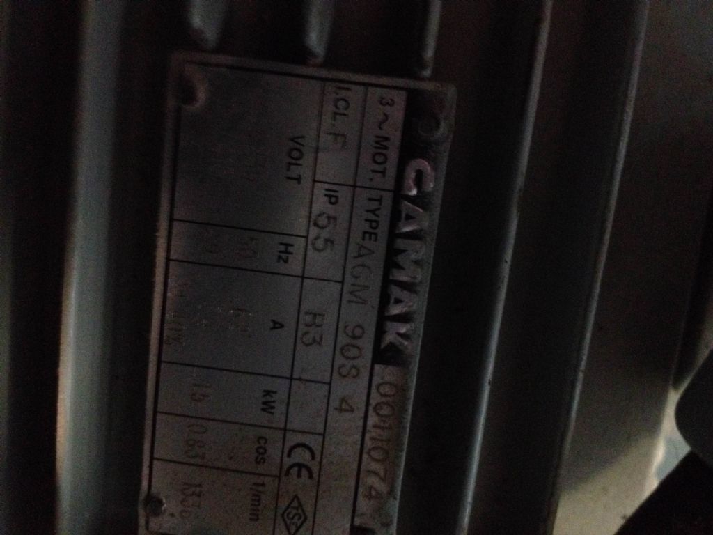

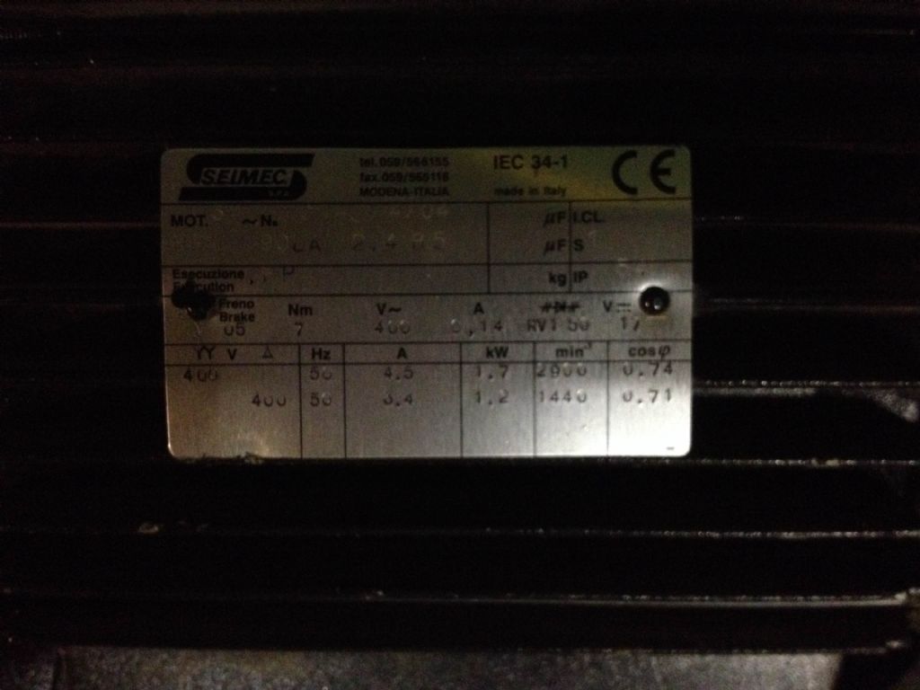

                            bandsaw.jpglathe.jpgI know very little about VFDs so any help choosing and setting up would be great.Here are the three motor plates Mill,lathe and bandsaw.The mill and lathe are thr most important I was hoping I could slow the bandsaw down with the VFD but I could change it to single phase.So is it possible to run these three machines with the one VFD without any problems,only one at a time of course.Sorry the pics arn't great.

                                          One of your motor plates only shows 400v, one shows 400 for both star and delta which is unusual and may be a misstamp, and the other is unreadable. There could be problems here. as you need a 220v delta configuration for a low cost VFD.
                                          However the less exotic old blue Transwave boxes do produce 40ov.
