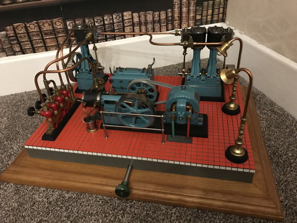

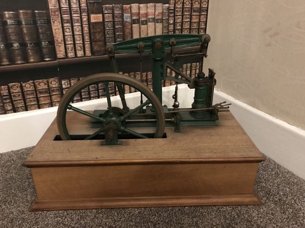

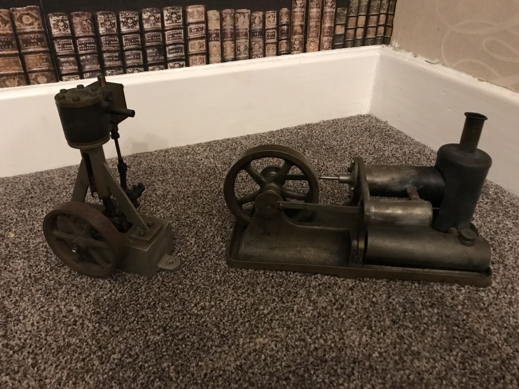

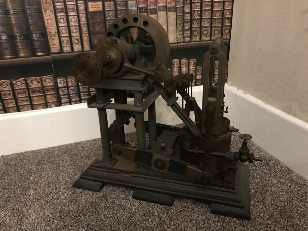

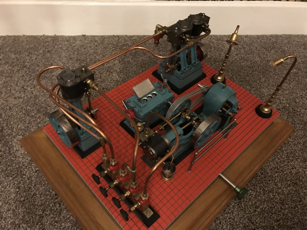

                    Here's some engines for those interested. The one on the right is a hot air engine, so i can run this straight away, the others i will need to get some kind of compressor. I'm hoping an AS06 airbrush compressor would be enough.
                    My favourite piece is this power plant model, the central engine is hooked up to a dynamo that powers the lights.
                    some bigger engine, not sure what sort of air pressure i could need to get them running, and advice about getting them running well and preventing damage would be gratefully received.
                    #393582
                      Last one looks like a "Sanderson" beam engine and the next to last a Clarkson "Steeple" engine.
                      If well made and free turning none of the engines will need much in the way of pressure, volume is generally whats needed. The steam plant will need more pressure as the engine will be under load driving the dynamo as well as needing more volume as the engine will need to be run at a reasonably fast speed to generate.

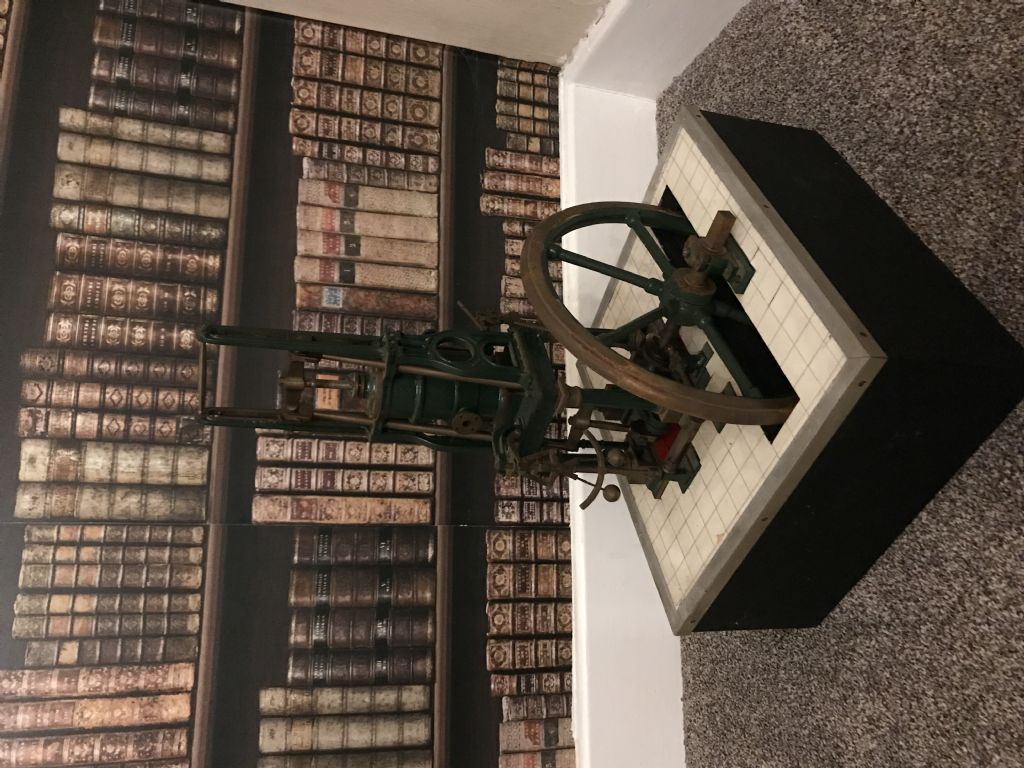

                          I think the item at the back counts the rotations of the wheel that drives the generator. The lid of the box lifts up to show the current rotation count. (See pic) The elastic chords that connect the wheel to the generator have perished with age. You used to be able to turn the key at the front of the mounting base manually to rotate the engines flywheel. Does anyone know where I could get replacements?6c3db4fd-90c4-445c-93b4-32a894daf12c.jpeg
                          Edited By Ceteri on 29/01/2019 22:04:21
                          #393635
                          Dennis R
                            @dennisr
                            Replace the drive cords with O-ring cord which can be bought by the metre.
                            Cut to length, scarf joint and stick with super glue. Works very well to drive models.
