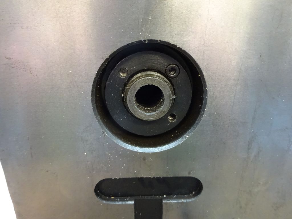

      Hi i have just bought a new rotary table from a reputable company. Iv just got it out of the box and im sure it should move more freely than this. What do you think ? should i contact them and ask questions ?

          Are the locking 'devices' free or tight?
          #249573
          Michael Garbutt 1
            @michaelgarbutt1
            They are free. I have removed them altogether even . Its even the same when the worm drive is disengaged from the table. the table will move freely but the handle/shaft is as tight as

              I have that model & it was tight until I got the hang of the locking mechanism. Sitting in my armchair i cannot recall exactly how I freed it but it now runs smoothly after i fiddled with the locking mechanisms. I think one was not actually releasing. Try tapping the head of the release screw when it is slackened off. From memory it was all gummed up with dried oil or protective grease. I washed it all in turps.
              #249588
                My table appears to be the same as yours and it's fine.
                The problem may be the position of the black lever coaxial with the dials. On mine full right disengages the drive and full left engages it. There's a point just before full left where the drive engages but the table is very stiff. The lever feels as if it's hit the end-stop but it's fibbing. Your video shows the lever just about in the position where my table stiffens up. Try pushing the lever harder to the left.
                Fingers crossed,
                #249589
                Michael Garbutt 1
                  @michaelgarbutt1
                  I know what wrong with it now . And its nothing to do with locking leavers or anything like that . The shaft with the screw on must be bent or ground incorrectly . its binding inside the outer part.

                                        Having just had mine apart (see other RT thread) you may want to check that the preload on the thrust bearing is not too high.
                                        If you look from below there is likely to be a collar that screws on to set the preload, loosen the cap head spreader screw and use two pins in teh holes to unscrew the collar a little and see if that eases things. If so nip it up to give a good feel and then tighten the spreader screw again.
                                        #250121
                                        KWIL
                                          @kwil
                                          Never did like that method of locking the collar. If the collar is a sloppy fit when loosened, the cap head spreader screw tends to cause axial movement on one side, (ie tilt), pressing the thrust bearing unevenly.
                                          #250157
                                            It was quite a good fit, had to use the pin spanner to wind it back on and the slot is off centre so it bends the thin side where the head is away
