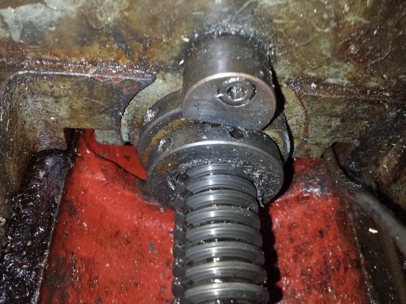

        Continued with the cleaning of the knee. First job was to remove the handle and mic ring etc from the knee feed screw. After the huge effort it took to get the saddle feed handle and leadscrew out I have to say i wasn't looking forward to it!
        In the end it took about 5 mins smiley. Whereas the other mic ring was rusted solid this one was nicely greased up. Took out the mic ring locking screw and the ring just popped off.
        The collet the ring sits on had the same set up as the saddle, one obvious grub screw, a tapered pin and one less obvious grub screw under the ball bearing on the mic ring lock.
        After removing these the collet ring itself came off really easily and then the Hoffman bearing and the 2 machine screws holding the spacer ring onto the knee could be taken off.
        I had already unscrewed the knee pillar from the riser screw so now the complete leadscrew/gears/riser came out as one unit after removing a couple of machine screws that held it to the knee.
        The motor for the knee is a later addition. The bevel gear on the end of the leadscrew is held on with a tapered pin, once this is removed the leadscrew pulls out of the carrier.

                                                      Hey Harry, info on spindle brake as promised.
                                                      The brake sits on top of the pulley housing and acts on the top of the spindle.
                                                      The lever operates a set of expanding shoes via a cam on the end of the lever
                                                      The brake shoes act on the inside of a drum
                                                      and when it is all assembled the drum sits kinda like this
                                                      So the drum is locked to the spindle and rotates and when the lever is pushed over the shoes expand onto the drum and hence brake the spindle.
                                                      Hope that makes sense
