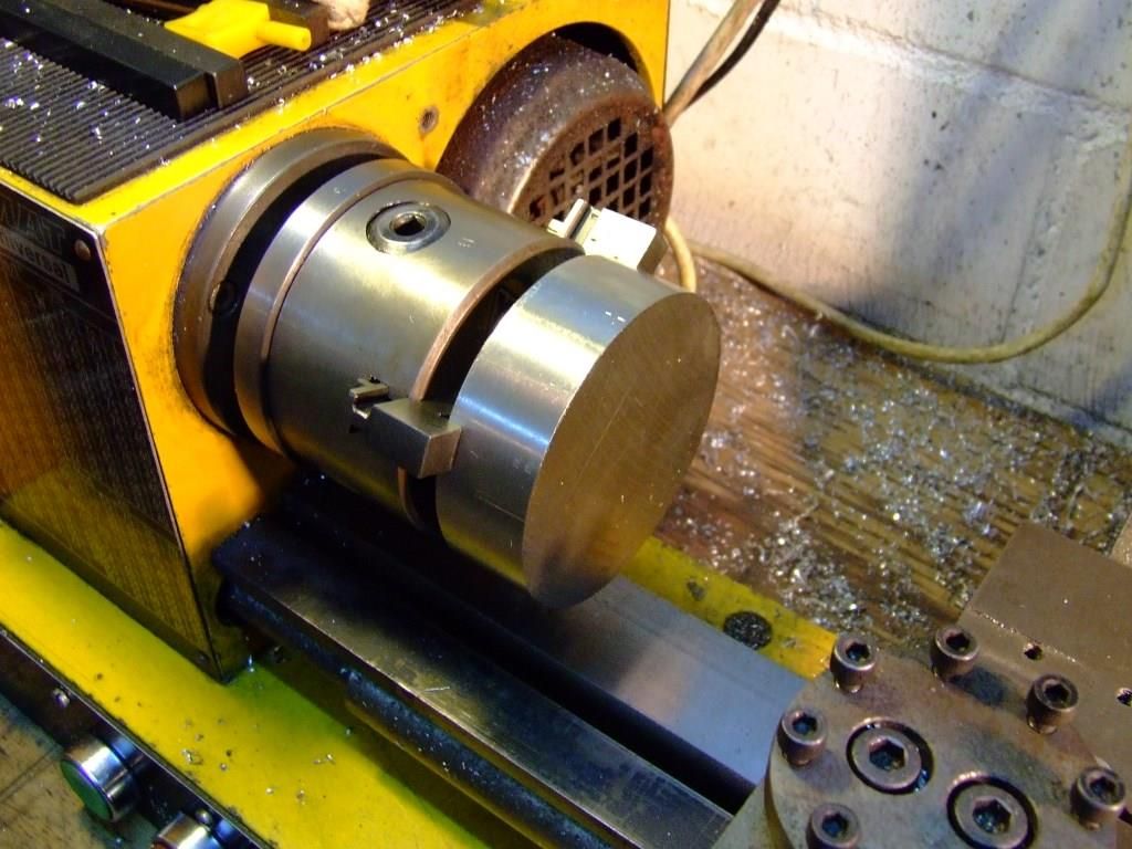

                    Going bigger than 80mm may not bring you much. Unless you have a low speed attachment the minimum speed is 250 rpm. Clearance over the bed is 65mm so you will need to check the clearance of the jaws. This is an 80mm blank held in the standard 80mm chuck.
