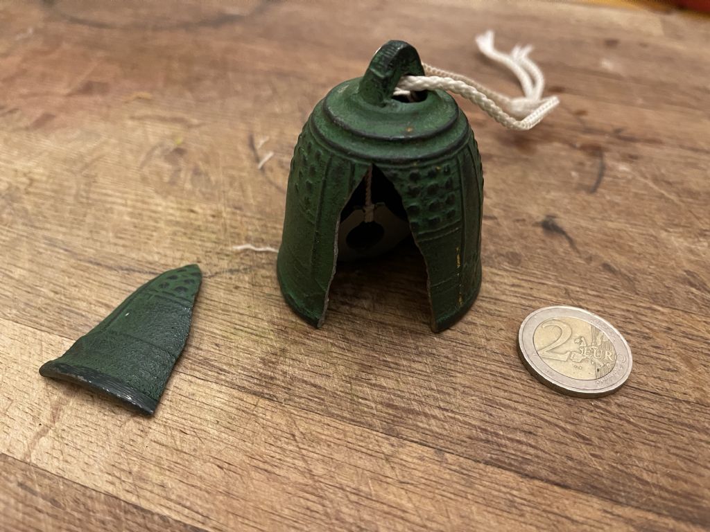

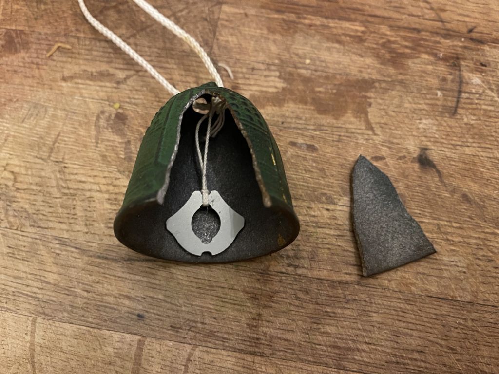

      The photos show a small and delicately cast bell in cast iron which didn’t survive being dropped onto the tiled floor.
      I have been asked if I can fix it and before attacking it, I wondered if the panel had some advice (even if it was don’t bother!).
      I doubt that it will ring again with the same sound but something better than the dull noise would be good.
      Looking closely, it appears that a crack was already in existence and the fall simply finished the job. One side of the break is mildly corroded, the other bright.
      I was contemplating cleaning and attempting a silver solder or braze joint from the inside to limit the visible repairs but not sure what the effects of serious heat will be on such a delicate casting with a 2mm or so wall.
      any thoughts gratefully received.

                          If you are going to attempt silver solder or braze, you need to heat to red heat, let it cool and then give the mating surfaces a good brush with a fine wire brush to remove surface carbon, then proceed with the braze or whatever.
                          However, I would advise the 'owner' that it could be a complete failure and worse off than in its present state should the process fail.

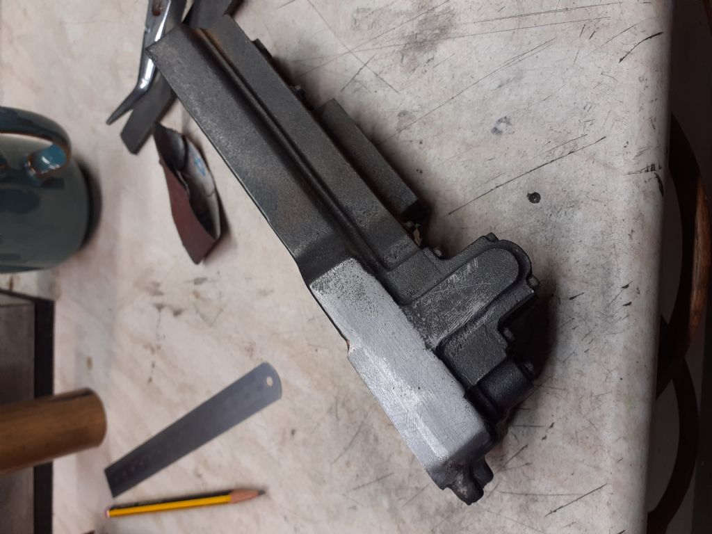

                            This is a repair using bronze brazing rod on a cast base of a steam engine.
                            It was heated a bright red heat and used Sifbronze flux. It was filed up afterwards and you couldn't see the repair after painting.
                            David

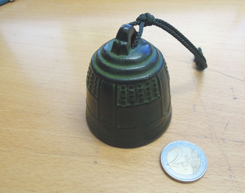

                                                  I thought I recognised that !
                                                  It's a miniature replica of a bell in the temple at Kamakura, Japan. I purchased mine in 1985 on my first trip to Tokyo. Mine is currently in regular service. It gets rung out of the kitchen window when I'm in the workshop and a meal is ready. Contrary to expectations, it does have a very clear and loud ring, hence its current employment.
                                                  You never know, they might still be in production…..
                                                    Ours came as a trio from Kyoto about 10 years ago, the other two also ring true with a delightful sound, hence the desire to make an attempt at more than a cosmetic repair.
                                                    Interesting that the finish on yours has lasted a number of years, not sure what it is but I think it’s chemical.

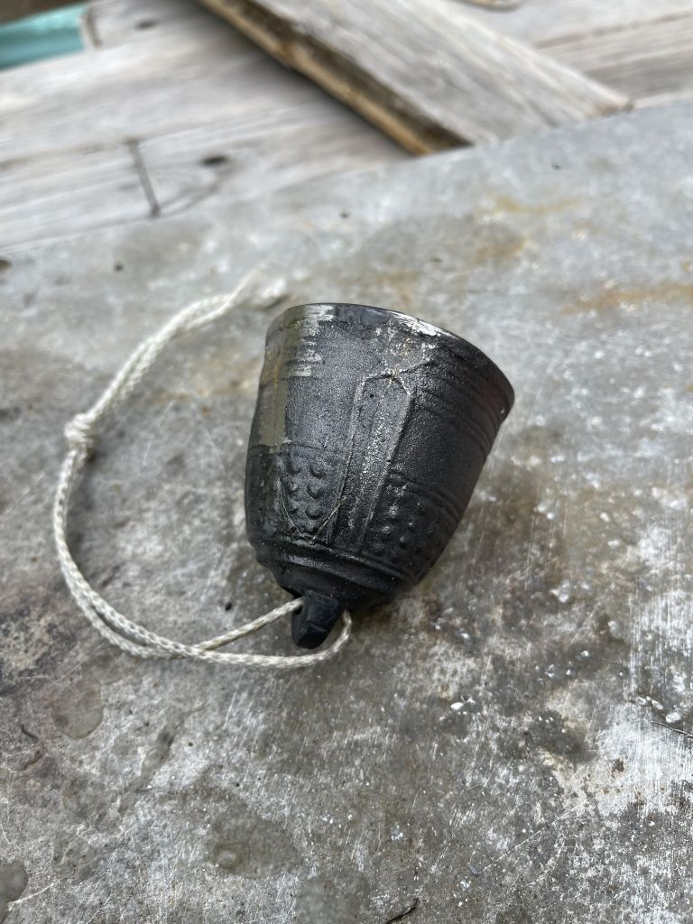

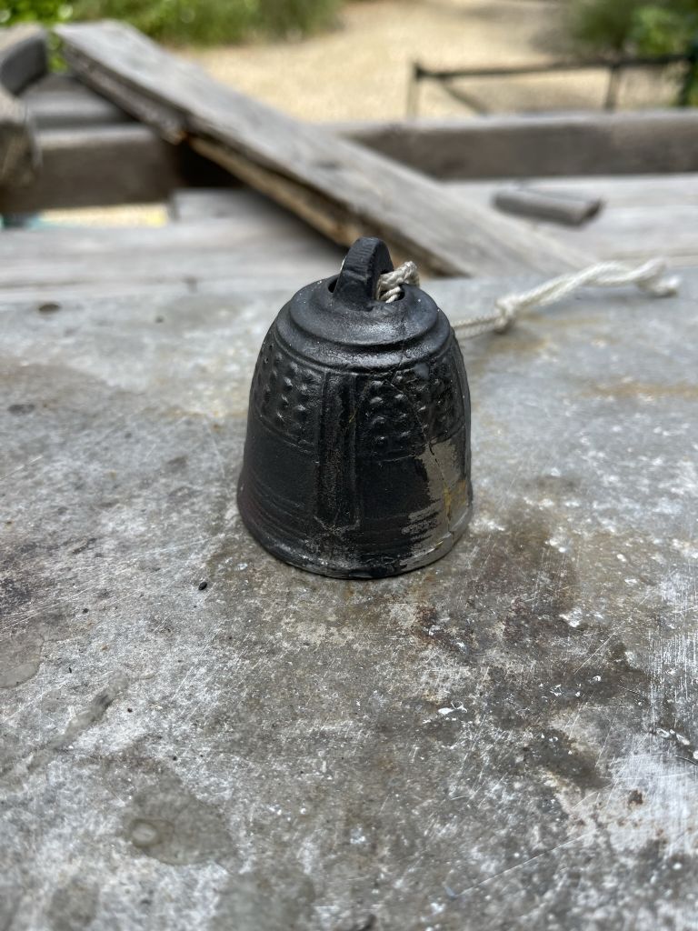

                                                      So an update to anyone following this thread.
                                                      Thanks to a very kind offer, I was sent some coated SiF Bronze to use for my attempts at a repair.
                                                      The excellent advice in this thread and privately suggested heating the bell to red, cooling and then mechanically brushing the joint surfaces – that was achieved successfully. I then used a Dremel with a tungsten burr to further clean and to make a V-groove on the inside of the bell to allow the braze to flow.
                                                      I then clipped the two pieces together and applied some Tenacity N°1 flux. The two parts were held together by thye spring tension in the bell itself (spoiler alert!).
                                                      The next step was heating and applying the Sif Bronze to the interior and allowing to cool. I was pleasantly surprised at how it flowed nicely into the inside groove although my technique leaves much to be desired I suspect!
                                                      Significant effort was then required to clean it up. Sadly, the two parts slipped slightly so one joint is near perfect and almost invisible, the other side has a small step – maybe next time I should bind with iron wire or similar.
                                                      I struggled to remove the two fluxes and eventually mechanically ground them from the inside and picked bits off from the outside.
                                                      Finally, the best part of all is that IT RINGS!! Proof of the pudding is in a 20 second YouTube video for anyone interested at (https://youtube.com/shorts/hAzSyVrEpdk?feature=share) Ringing Bell
                                                      Finally, finally….does anybody have any ideas about how to replace the verdigris finish on the bell – I am pretty sure it was a chemical effect rather than paint and all I can find on the web seem to refer to paint substitute finishes. Answers on a postcard please – or better still, here!
