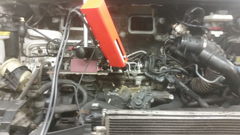

                                    I Use the following and find them the best options after 30+ years of trying
                                    These are available form many different manufactures.
                                    but this is the best….
                                    A portable spark erroder unit, this has saved many an engine which would otherwise be scrap, In this picture I am spark erroding a snapped off easyout from a snapped of Glow plug
                                    We didn't snap them it was a job to correct work carried out by a well known car parts store……
                                    Edited By Antony Powell on 06/05/2017 08:04:47

                                        Posted by Antony Powell on 06/05/2017 08:04:16:
                                        Got the bigger brother to that one. Awesome machine.
                                        Biggest job it has had to do was remove the rusted in allen screws from the bed of a 72" Lumsden grinder.
                                        These are big vertical face grinders and the bed consists of many triangular segments that contain the coils for the magnetic table with the top surface being held on by a zillion allen screws. Because these run continuously under coolant when the coils short out it's a major job to replace them.
                                        The small machine like the one in the picture takes about 20 minutes to remove a M10 allen screw. The larger machine takes about 5 – 7 minutes.
                                        From memory, total time to remove all the screws was about 4 days

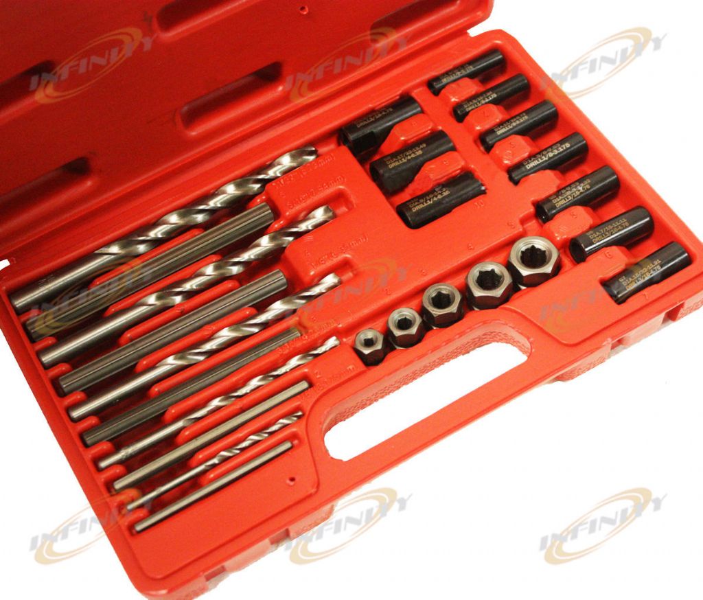

                                                      Back in the dark ages when I did not have much of a kit of tools I used this method:
                                                      I used a portable drill to drill through the stud/bolt. I enlarged the hole until threads were just beginning to show on one side of the hole. m Of course the hole was off center. I ground a broken hacksaw blade so it could enter the hole. I made 3 or 4 cuts with the hacksaw blade until threads were just visible in each cut. The last step was to use a sharp punch to knock out each of the segments of the bolt.
