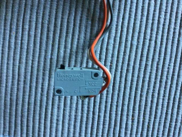

              John Doe 2
                @johndoe2
                Might be simpler and easier to have a standard microswitch mounted between the tracks, operated by some sort of sprung lever fixed to the underside of the train.
                The type of switch I have in mind are those in a plastic oblong case about 28mm x 16mm and 10mm thick, made by Honeywell for central heating valves, with a plastic button that operates the switch, (see below). You can get ones with a metal lever on top which pushes down on the button.
                Or even better, file a shallow slot out of the top of one rail and fix the microswitch outside of the track with its operating lever over that slot, in such a way that the train wheels will pass over unhindered, but will push down the lever and close the switch when it passes over. Microswitches of this type are available to switch several amps, so should be able to switch signalling without needing extra relays etc. which a reed switch probably would.
                This idea will work for any engine, since they won’t need modifying. And be much easier than messing about with magnets and clearances; trying to get the magnet aligned to switch the reed reliably. And having to do that on all the engines.

                  duncan webster 1
                    @duncanwebster1
                    Thanks for the replies, I’m sufficiently encouraged to do some experiments with reeds and Hall effect. The magnet will be on the driving trolley, so I don’t need to equip all locos.
                    I’ve discounted opto beam interrupt as it could get triggered by something other than a train.
                    I’ve no doubt that on a dry day the microswitch idea could be made to work, but keeping the rain out would not be easy. I only need to switch 0.5 mA, as the signal logic is driven by a processor. I think I’ll put a 555 or similar very close to the sensor to extend the pulse, as a very short pulse fed into a longish twin core might get mopped up by the capacitance?
