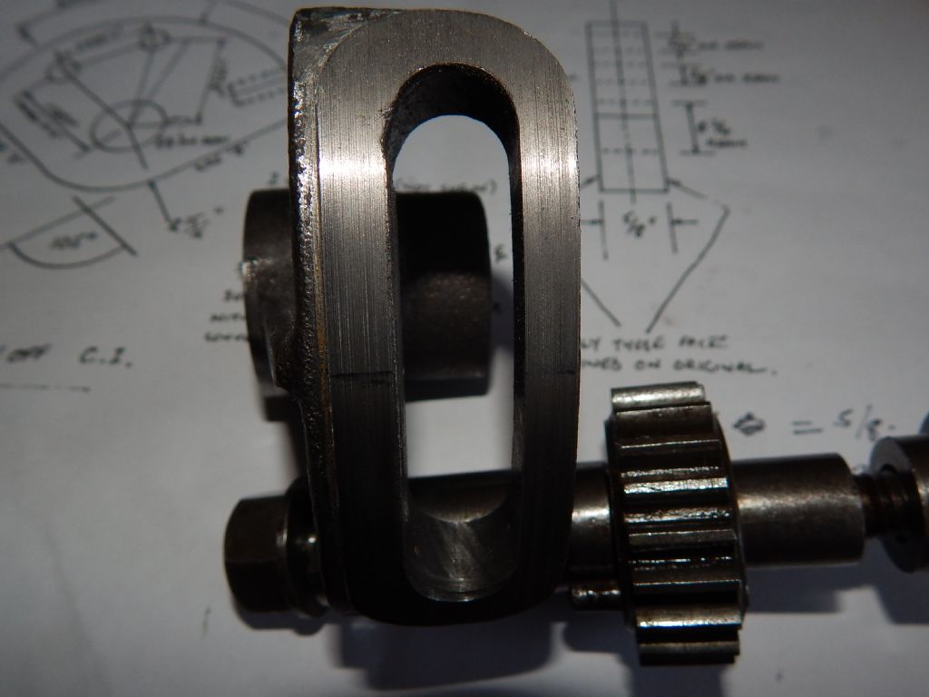

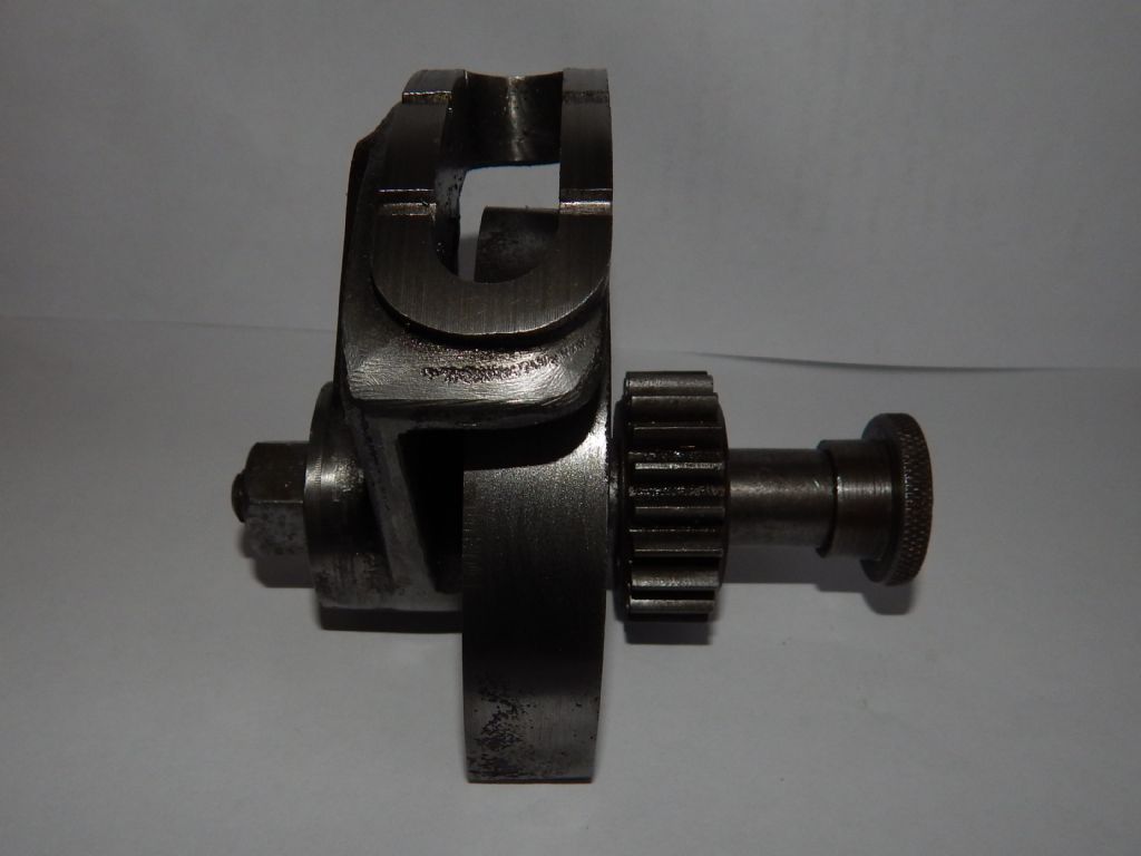

      Hi Bodger , Kieth ,
      Have made a bit more progress with the main casting today . I had been thinking about this for several days and decided to see if I could find something the same size as the existing curve on the side which was correct. The wonderful man who cast these items confessed he was not able to cast this side as he needed more experience, well don't we all as i could not cast this at all.
      Well the good news is that its exactly the same same size as a new £1.00 coin and this can be used to draw a line around. I gently  nicked it back from this line with an angle grinder. Go Carefully. Then finished with a small file. This is the result.

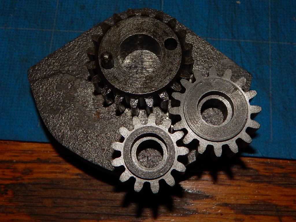

          Yes Bodge there are some wonderful people out there and when you sit and make this stuff yourself it gives you a new feeling of what the original people making these items were doing . It is fabulous to have groups like this . Am hopefully going to cut slots next which is a bit of a challenge as have been told that the 1/8" Fluted mills just destroy themselves when you try to use them . I am hoping I can achieve these with a rotating saw on an abhor . Will post more when I have this done.
          I have had a test layout with the gears marking out the positions . But the rough surface is just too bumpy to give an accurate placement. It is noticeable that the tolerances here are very precise as the gears are quite near to the wall of the quadrant casing. I hope when they are machined this will be better.

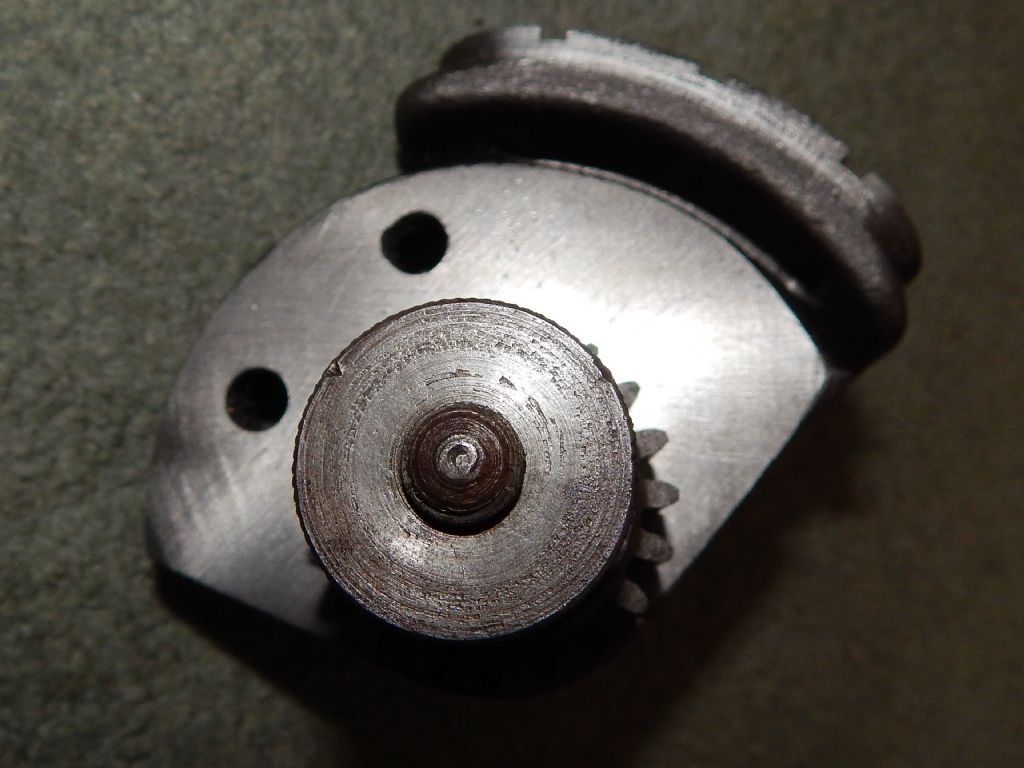

                                      Well retrieved Quadrant my friend had managed to re-drill out the cobalt drill was pleased but the hole through drill skidding still is on reverse. Have checked out with gears and think centre one needs moving over from the drawing sent to me by Geoff and Keith to allow gears to mesh correctly. Am going to drill top gear out much larger and fit a larger base into the quadrant this will meant the gear will have to go on from front . Will probably use a washer and Circlip to fix it unless anyone else has a better idea. I Cut back extra material from main casting but need to get my expanding abhor to finish this part off. Am still amazed he managed to drill out drill his equipment must be rock solid compared to mine Dont te holes but going to make bigger
                                      #238941
                                      Martin Newbold
                                        @martinnewbold
                                        holes cut but top needs drilling outSo far its coming ok

                                            Am going to make stud for second size gear first and see if this fits on the lower gear. Then check small gear position and re drill accordingly larger. I will then decide to make the smaller gear a fitment from the back and secure with washer and a Cir-clip or something on front else if someone recommends something better.

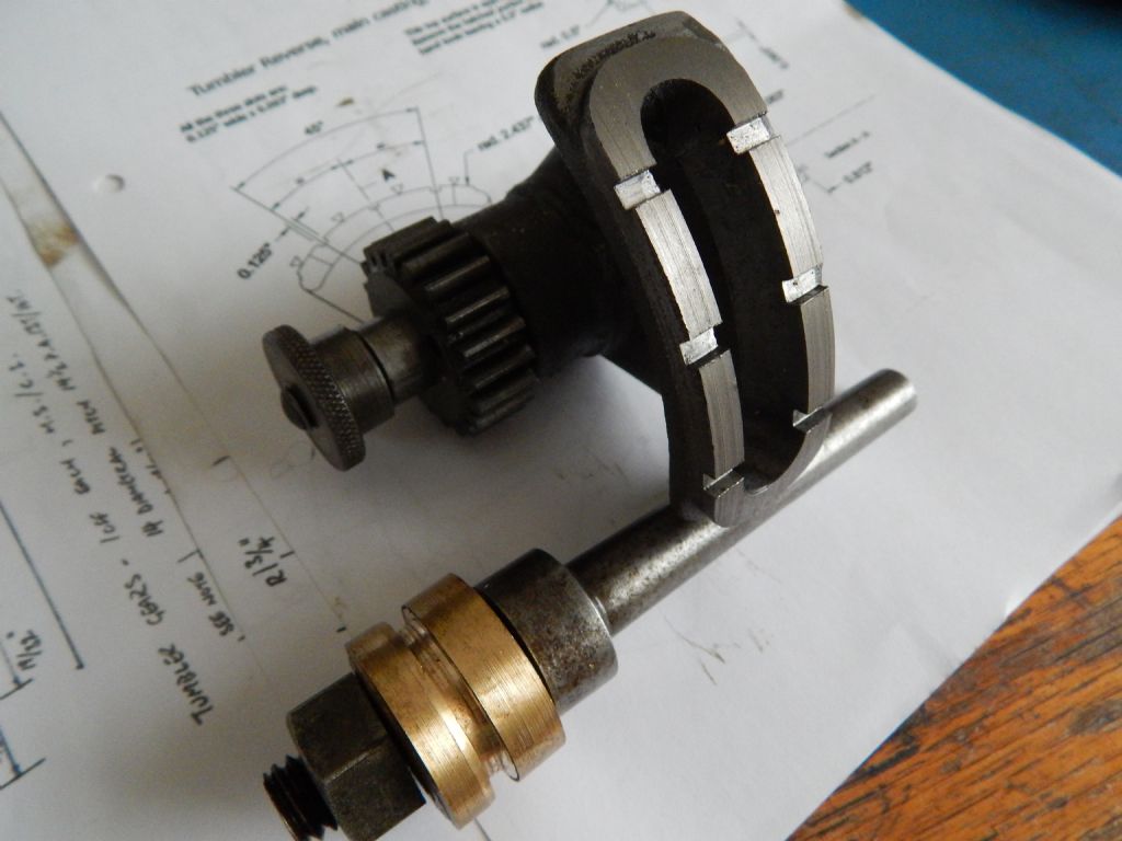

                                                      This is how far other cog is out.This is how far hole is out from diagrams
