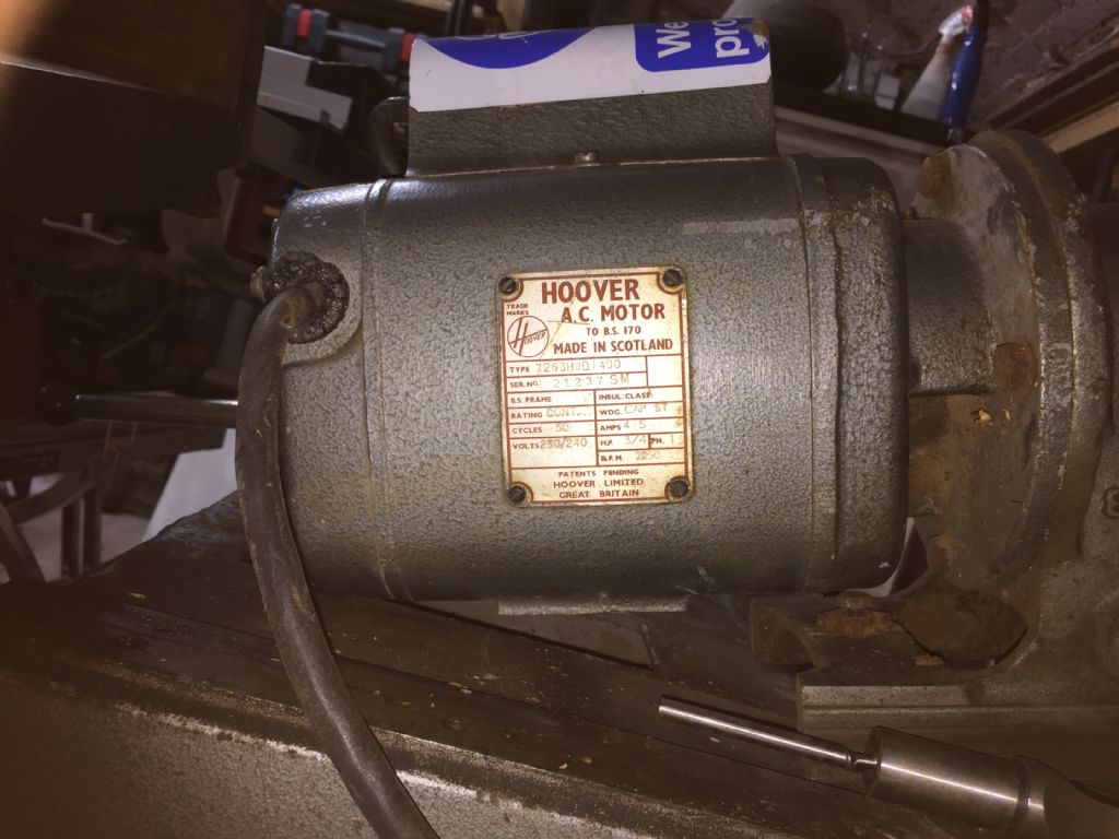

        I've bought an old machine (a Multico mortiser) which had been sitting unused in various sheds for an unknown length of time. I think it probably dates from the 60's or 70's. This is the motor:
        I'm a bit reluctant to power it up without checking it's safe – especially as the grommet where the power cord enters is badly perished. Are there any basic electrical checks I can make (given I have only a multimeter) as it is, or would it be advisable to strip it down and have a shufty inside before firing it up?
        It's 240V single phase 2850 rmp cap start according to plate.
        Ta, Robin

          Does it turn? Is it lubed? Does the earth show continuity? Anything obviously loose? Is it a fully enclosed motor?
          Bolt or nail it down, stand well clear and flip the switch. It will likely run OK. Then stand it on something insulated and check for volts from frame to earth, while running, before grabbing hold of it!
          Replacing the grommet is pence. A new lead might be a good idea.
          Alternatively, get an electrician to check it over.

            I would carefully have a look at the wires from the windings to the terminal block, the insulation is often perished and very fragile on a motor of this vintage. Sleeving the tails is probably the easiest way to make the motor safe without disturbing the windings. A meggar is the tool you really need to check you have no earth faults or shorts between windings. A bridge meggar would tell you the accurate value of the winding resistance but unless you have the spec for the windings resistance there is not much point in testing it. If the tails can be checked and if necessary repaired and it meggars clear of earth you may as well switch it on and see if it runs. If it has a centrifugal switch for starting then check it works properly when the motor is up to speed.

              Thanks. Motor spins freely by hand, no slop or bad noises. Earth to live/neutral > 40Mohm, earth to case 0.9 ohm, live to neutral about 3 ohms all measured from plug pins with a (1.5V!) multimeter. I don't have access to a megga – I guess I have to get inside and check visually.

                If there is any possibility it's been wet it might be worth blowing warm air through it for a few hours to dry it out before you connect it to the mains. If you're dismantling it leave the stator in the airing cupboard for a few days.

                    Yes Emgee, from the plug. The last person who used the machine had disconnected the NVR box from from the motor and wired the plug direct to the motor. With red/black wire, so a while ago!

                      If you know an electrician get him to test the windings with his 500 volt INSULATION tester, it might be a Megger.There are other makes of insulation testers around. Insulation testing with a multimeter isn't good enough, they usually only have 9 volts and the motor needs 500 volts DC. Insulation testing is the electrical equivalent to boiler pressure testing looking for possible leaks. If after Insulation testing and all is OK I suggest you leave well alone, its all to easy to break one of those fine wires and not being knowledgeable enough on motor repair to fix it. John

                                            Robin, as a qualified electrical engineer and certified PAT tester I would make the following comments, based on the IEE Code of Practice 3rd edition (there is a 4th edition but it won't be different in substance).
                                            It is acceptable to do your earth continuity test with a current as low as 20 to 200 mA. This is described as a 'soft test'. The acceptable resistance is 0.1 ohms PLUS "the resistance of the protective conductor of the supply cord". (The pass/fail threshold in most PAT testing kit is a generic number set for average conditions.) Obviously you will want to clean and check any connections, including inside the plug (a check which many technicians omit) and remove any oxidation on the plug pins which can cause a high reading. You should also wiggle the cord about while testing to check for broken conductors. I would be perfectly happy to accept the reading of an ordinary multimeter on this. Incidentally, a smear of petroleum jelly can work wonders on poor contacts. Ordinary grease is not recommended because it can be acidic, though it has never caused me any problems.
                                            As for the insulation resistance, in PAT terms yours is a Class 1 equipment. Yes, the test should be carried out at 500 volts, but again for my own purposes I would be happy to accept the reading from a multimeter. The minimum acceptable insulation resistance for this class of equipment is 1.0 megohm, and your reading shows well above this.
                                            From your description I would have no hesitation in plugging it in and letting it run. I would run it unloaded for a couple of hours and measure insulation resistance again. If there was any moisture in the windings, the resistance will increase as the motor warms through from the inside. I recently treated a 1920s repulsion motor this way and the insulation resistance increased from 0.7 to 37 megohms after several hours' running, converting a fail to a solid pass.
                                            Electricity is only dangerous if it gets in the wrong places. Don't touch exposed metalwork while testing, make sure your hands are dry and you're standing on a dry floor, keep one hand in your pocket while things are live (so there's no possibility of a return path through your heart).
                                            What I have said is what I would accept for my own purposes, not what I would do for equipment to be used in public places. Remember that my advice is worth exactly as much as you paid for it. Be sensible.

                                                George, many thanks for your comments – on the basis of what you said (while completely accepting responsibility for my own actions!) I just checked the connections in the mains plug then fired it up (from a safe distance!). Ran sweet as nut. I was probably worrying about nothing, but the ratty appearance of the external wiring alarmed me. I'll redo the wiring as far as the terminal block within the motor housing though.
                                                Martin, – sorry if I wasn't clear about what I'm doing in my previous posts – the motor came as an original part of a old mortising machine which I'm trying to restore for my own use. It wouldn't be straightforward to replace it with a modern motor I think, Anyhow, seems like it's going to be OK. I paid 75 quid for the machine, bit of a gamble, but it looks like it's going to to pay off.
