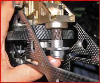

            Initially when I saw these last two pictures the reason for not wanting to start again with another pair of gears became more understandable. I then realised that they are not pictures of the actual posters helicopter.
            The upper bracket seems to be just a bearing housing as it does not look large enough to mount a motor, whether electric or IC.
            It was not clear from the original enquiry but I now assume that the motor is fitted with the shaft pointing upwards with the pinion supported at both ends. In which case this topic has gone round in circles somewhat but it does boil down to finding some way of opening the pinion bore!
            Out of interest, what are the drilled flange on the aluminium pulley boss for? maybe the clutch?

                  Although the pictures, one of which I have not seen before, well done with your search, are not my machine, it is the same model. A JR Sylphide 50.
                  1 There is a flat ground along almost the entire length of the shaft – this is one reason why I did not think the emery cloth idea would work very well, as has been stated, the shaft needs a good fit.
                  2 It is entirely normal to fasten the pinion to the shaft with a single loctited grub screw,
                  3 The little wings are used to hold magnets that a governor sensor would pick up, I do not need these. This part is not designed for this mod, but was useful as it worked. Unfortunately it is no longer available.
                  4 The only way I have to measure is standard calipers, and I get inconsistent readings, so to be honest I am not entirely sure what the ID is. I will have to go to a friends house who has a full set of numbered drill bits and see how close I get.
                  5. Finding a pair of gears is out of the question. There is a tail drive gear attached to the main gear and this all sits in a hub containing a one way bearing to allow autorotations.
                  6. The upper support bracket, gold anodised, has two bearings. The bottom larger bearing has a 9mm ID and the wider end of the pinion is loctited into it.
                  7 The upper bearing would have previously centred the IC engine starter shaft, ID 5mm. I had intended changing this for a 6mm ID bearing which would centre and support the motor shaft at its upper extremity.
                  It is not strictly necessary for the shaft to pass through the pinion. This seemed a good idea as it would ensure the motor etc were precisely aligned and would allow the motor shaft to be supported at its upper end to increase the life of the motor bearings.
                  I think I need to try and ream out the pinion, I’m sure it can’t be too hard, after all it runs against a plastic gear.
