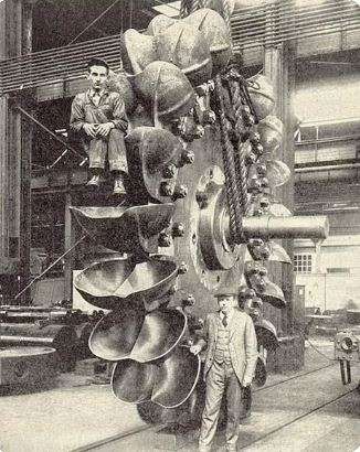

                                                  This popped up on Pinterest this morning, you would need a reasonable bit of rainfall for that one
                                                  water wheel
