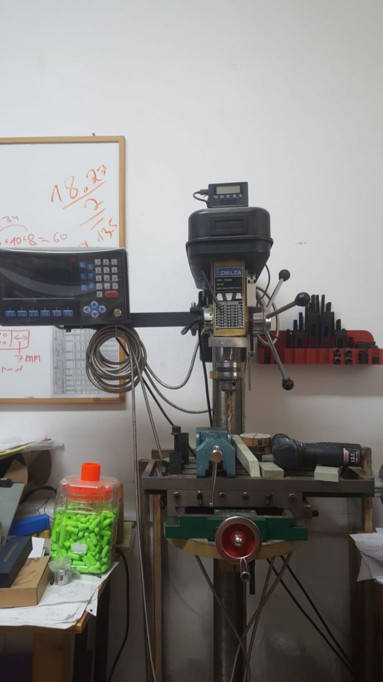

      Dave, thank you comment this is exactly the point.
      "I wonder if there's a misunderstanding about how accuracy is achieved with these hobby tools? It's not done by dialing in dimensions and expecting the cutter to be spot on under all circumstances across the full range of travel. Rather the operator becomes skilled in getting the best out of the machine, allowing for shortcomings rather than expecting them to be eliminated by the manufacturer. Even if the Seig passed all the DTI tests, it's too lightly built to be highly accurate – even monster machines bend slightly when cutting."
      We "material engineers" normally speak in microns and below. My press drill (modified) was in the range of 0.1-0.3 mm, and I believed that if I spent x8 more money I don't only get better dedicated quill and rigid column but also improve on the accuracy. According to videos I have seen online they always talk in terms of 0.001" or 0.02 mm so I believed that I will improve my accuracy it 1-2 orders.

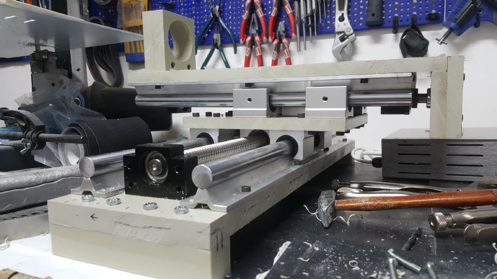

      In terms of what I want to build, my first project is to finally finish a CNC machine out of Aluminum (or from polypropylene and then cnc the Aluminum). when I built the model, many times I had two different parts with holes and I hoped that they will match but they didn’t, so I always had to choose a few holes and widen them up. I used a DRO and an edge finder and the deviations came from the press drill quill which has an enormous play.
      In term of what I want to build after words, this is a difficult question, I build with my imagination and my imagination is limited to the tools that I have. The more possibilities the more Ideas come to mind… Now that I will be able to actually mill many ideas will follow, but at the moment I start from the simple things – will it allow me to make 90 degree edge spot on? Will I be able to get holes on a single plate 500mmx160mm spot on? Will I be able to make face mill surfaces spot on? One project that I had in the past involved making a vacuum chamber, If I had a mill I could have made many parts myself… especially the tunnels for the Teflon strips.

          Good looking workshop Nir!
          Your pillar drill should allow a simple practical demo of what I mean by 'technique'.
          The drill's fitted with a milling-style table and vice allowing work to be held rigidly in position, but the combination doesn't deliver accuracy. It's because the pillar drill is designed to push down and isn't rigid side-to-side. In particular the spindle bearings are often sloppy. If when the drill starts cutting the spinning axis is misaligned with the work, the spindle moves and bends the drill slightly and the hole wanders off.
          Rather than hold the work rigidly, sloppy pillar drills work better if the job is held loosely enough on the table to float into the spinning axis. My pillar drill (much inferior to yours) works well using old-school methods:
          1. Mark the hole position accurately by scribing lines on the job (need to establish a reference point).
          2. Centre punch the crossing point, inspect with a magnifier and adjust it's exact position by a second or third sideways punchings intended to drift into centre.
          3. Hold the job in a machine vice bolted to the table such that it can't pull up, but slack enough to slide sideways.
          4. Put a drill in the chuck and stick a dressmakers pin to the end of the drill with modelling clay, point down. Power up, say 500 rpm. Use a pencil or steel rule to nudge the spinning needle point until it stays centred. It indicates the spindles rotating axis. Power off.
          5. Position the job so the needle point is exactly over the centre-punch. (Magnifying glass may help)
          6. Remove needle, start drill and feed into the work. As the drill engages with the punched hole, allow the work to move into alignment with the spinning drill if it needs to.
          The method relies on a spinning spindle taking up a particular axis, and then aligning the axis with an accurate point on the job. It doesn't depend on the pillar drill being a precision tool because measuring is independent of cutting. Once the drill's cutting it's important to work within the set-up's limits. Applying too much pressure is liable to bend the drill and shift the axis, causing the drill to wander.
          The method takes too long in a workshop where time is money. If a lot of accurate holes are to be drilled in a hurry, the professionals go for a better class of drill. because a pillar drill costing £2000 or more is cheap compared with paying a skilled worker to drive it.
          My WM18 milling machine is rigid enough to drill holes accurately straight into the job, but I always position the cutter relative to known reference points on the job, and check frequently.

            Nir also looks as if he has an expensive 3 axis DRO fitted to his pillar drill; I have the same DRO but fitted to a mill/drill, and absolutely love it. Luxury indeed!
            But is this DRO inappropriate for a pillar drill? Or over-kill?
            If it were me, and such kit expensive in an expensive world like Israel seems to be, that DRO would be fitted to the Stig where perhaps its expertise would be better served.
            Just saying!! Merely a suggestion, an observation,

              ChrisH, Indeed, when I bought the DRO I bought it in parts, so for a change, I didn’t pay any TAX, and it is indeed the expensive one, 1 micron resolution. But I bought it to serve a mill in the future in mind, the press drill is only temporary, I don’t have space so I am supposed to get rid of it and replace it with the Sieg.
