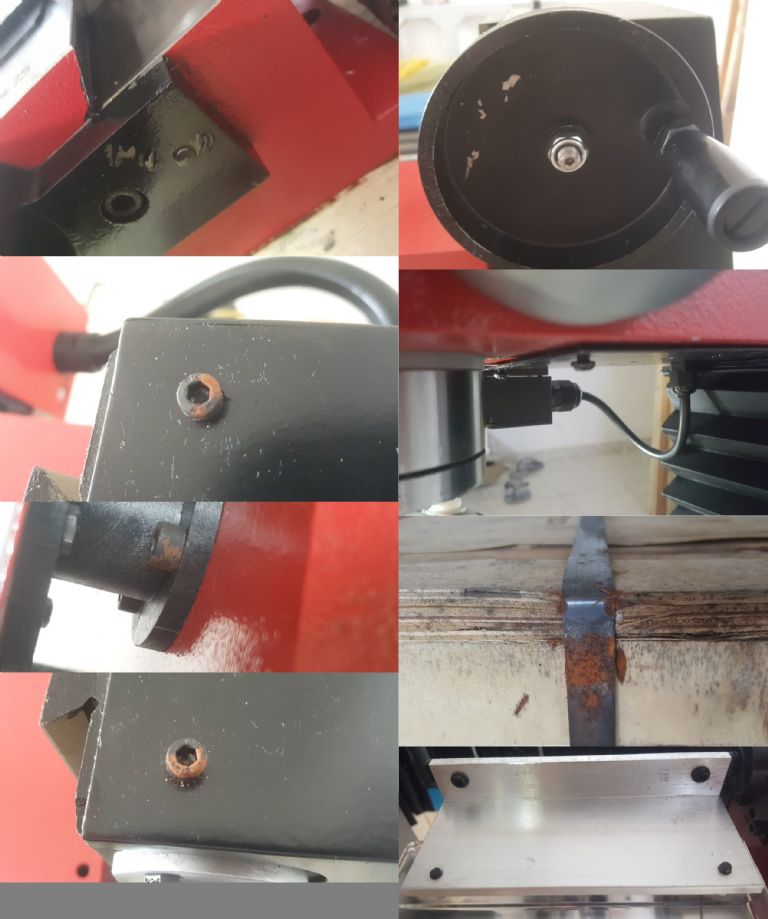

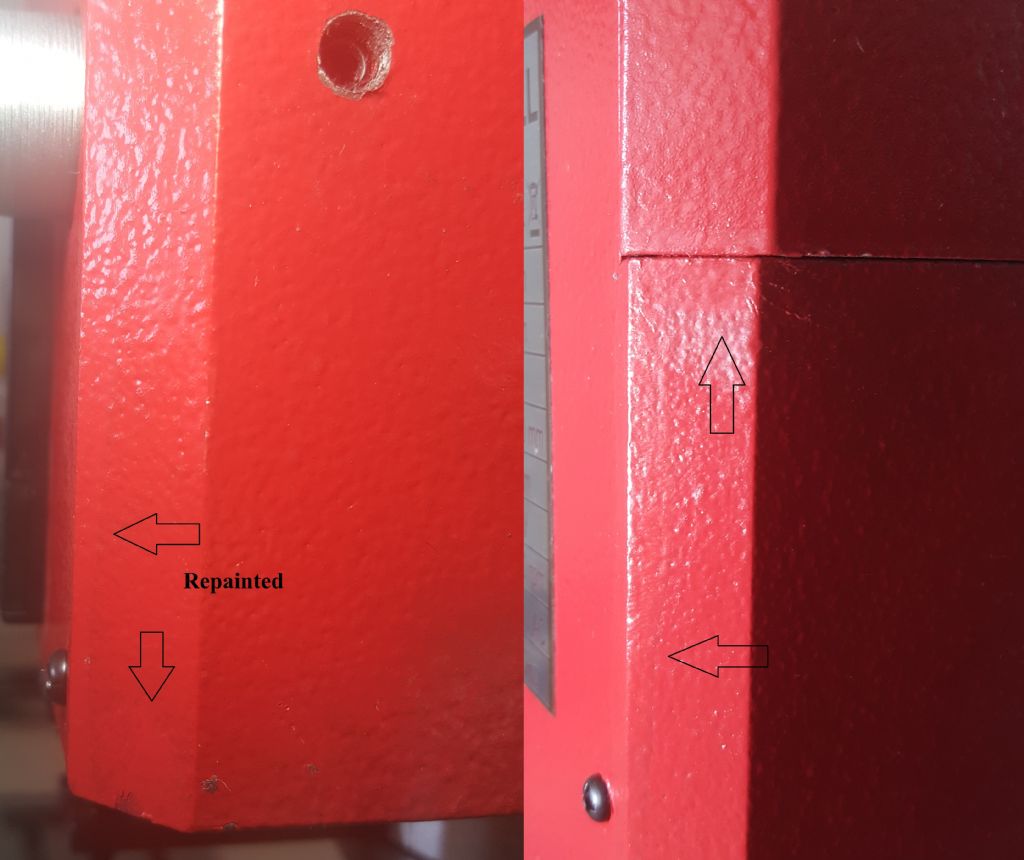

      I wouldn’t be happy with the damage to the cover. There’s also signs of rust and other badly prepared paintwork. If Sieg really have sent that out of the factory like that they don’t deserve the business. I do wonder however if this machine has been damaged in transit and been tarted up (badly) by the dealer or someone else? Perhaps you’re not the first owner. It would be interesting to know the date of manufacture. This doesn’t necessarily effect the standard to which it’s been manufactured, maybe they’re all like this. I can’t comment on your methodology except to say using a square in one of your setups wouldn’t be my first choice. I wonder what other dealers of similar machines think of your findings and what they’d be prepared to do about it? Good luck with the machine whatever you decide to do but be aware there are plenty of folks out there that have “fettled’ these type of machines to improve them. Looking on the net should give you some idea if you decide on that route.

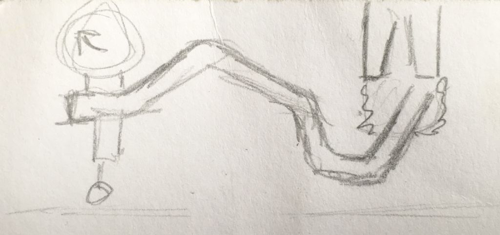

                            It’s simple trigonometry : If there is an angular error between the ‘output axis’ of the chuck and the axis of the machine spindle, then your trammel beam will act like a swash plate and the DTI will rise and fall.
                            Edit: Swash Plate animation: https://youtu.be/z-wA9Tx8930

                                    #498292
                                      Posted by Tony Pratt 1 on 28/09/2020 10:35:58:
                                      … the chuck/collet or whatever is only really connecting the DTI to the spindle bearings in a rigid set up …
                                      I apologise, Tony … You were correct in your first assertion.
                                      I have just returned from a good long walk, and some pondering; and it became quite clear that the mis-aligned chuck would simply form part of the “any shape you like, provided it’s stiff enough” trammel beam.
                                      By way of demonstration : here is the scrappy little sketch that I doodled whilst I was out.
                                      blush MichaelG.

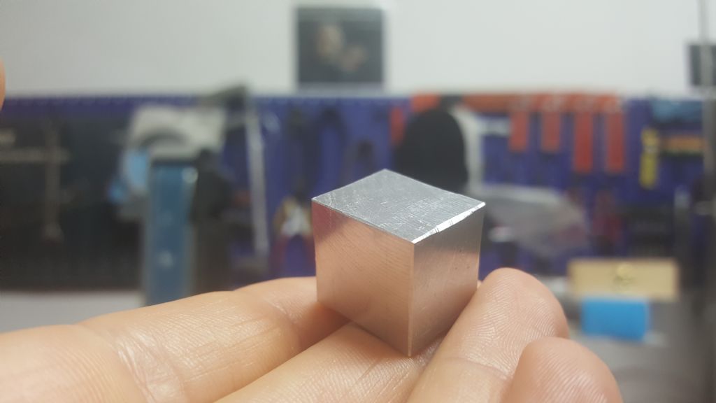

                                            ChrisB & SillyOldDuffer, I thought about your comments about cutting a metal or squaring something, and I honestly don't think this is the way to go, for one, when squaring properly, if my face cutter is tilted 10 degree to the front and I rotate the piece on its axis, it will still turnout to be perfect. even the sides! so long as my x axis is spot on – and ~0.03 mm is spot on. Also, I don't have a big enough stock of material. And My point is that when times comes and I will have a project that will need this few hundreds of accuracy all problems will arise… Will it cut metal? I don't see why not, I already squared a small aluminum piece of 20 mm thick to 18.6×17.4×15.6, but this won't help me judge my mill at all, first of all I don't have a proper grounded granite table and a height gauge, and my machined square and caliper will only give good results as my vise, which is a cheap Wilton vise with an accuracy of doubtedly 0.001". I plan to buy a Kurt 4" vise, and a granite table and so on, but only after I know my mill worth it. ***By squaring I assumed you meant making a cube:
                                            As I said my ER collect didn't arrive yet, so my only choice is to use a square and it is one order more accurate then the measurement I am looking for so I don't see the problem.

                                                      Posted by Nir Somthing on 28/09/2020 17:42:53:
                                                      ChrisB & SillyOldDuffer, I thought about your comments about cutting a metal or squaring something, and I honestly don't think this is the way to go, for one, when squaring properly, if my face cutter is tilted 10 degree to the front and I rotate the piece on its axis, it will still turnout to be perfect. even the sides! so long as my x axis is spot on – and ~0.03 mm is spot on. Also, I don't have a big enough stock of material. And My point is that when times comes and I will have a project that will need this few hundreds of accuracy all problems will arise… Will it cut metal? I don't see why not, I already squared a small aluminum piece of 20 mm thick to 18.6×17.4×15.6, but this won't help me judge my mill at all, first of all I don't have a proper grounded granite table and a height gauge, and my machined square and caliper will only give good results as my vise, which is a cheap Wilton vise with an accuracy of doubtedly 0.001". …
                                                      Look at it this way, measuring hasn't achieved anything positive yet. It's created lots of suspicion, but not confirmed the mill is a dud, or suggested what ought to be done to fix it.
                                                      On the other hand cutting metal achieved something – you made a cube! The point is, if the mill with Nir at the controls made a cube successfully, then Nir's mill can make other objects correctly. Rather than rejecting it, perhaps it's good enough. Judge the mill by what can be made with it, not on measurements that could be misleading or irrelevant. What can't the mill do in practice?
                                                      I wonder if there's a misunderstanding about how accuracy is achieved with these hobby tools? It's not done by dialling in dimensions and expecting the cutter to be spot on under all circumstances across the full range of travel. Rather the operator becomes skilled in getting the best out of the machine, allowing for shortcomings rather than expecting them to be eliminated by the manufacturer. Even if the Seig passed all the DTI tests, it's too lightly built to be highy accurate – even monster machines bend slightly when cutting.
                                                      Early craftsmen produced superb work without accurate machines – they had to substitute technique for advanced tools. A milling machine makes it possible to work faster, and industry spend big money on mills that the operator can trust without constant checking. However, with care similar results can be got with ordinary kit, it just takes longer.
                                                      What do you intend making? It matters and in the absence that information I don't know what to suggest at the moment. Hobby mills are good for most amateur purposes, but probably not suitable for a busy professional workshop, or making watches! Very high milling accuracy (0.001mm) suggest a Jig Borer and tool-room facilities – truck loads of money. I mill for fun but perhaps Nir really needs a jig borer, or a much heavier machine.
