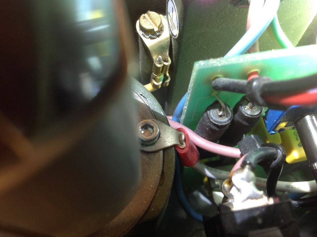

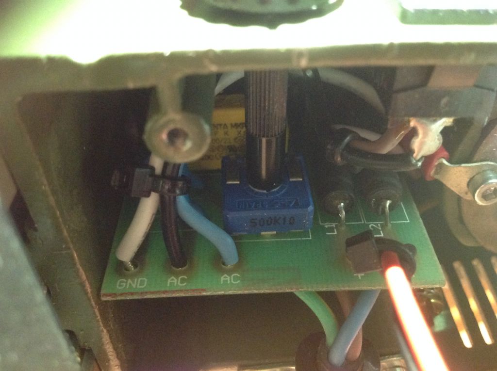

                    I've added some more photos here and in my album, which hopefully convey a tiny bit more information to the initiated.
                    I have tried to extract the circuit board with attached wiring from the housing so that we can see what we're dealing with, but the speed control shaft passing through the wall of the housing is preventing me from lifting things upwards and I can't see any easy way of removing the external knob from the shaft (I've tried gripping the shaft with needle nose pliers while pulling the knob away from it, but it is stuck fast). I can't fathom out another way of getting the circuit board out at present short of desoldering the connections.
                    I can't see any obvious blackening of internal components; only the copper windings glimpsed though the cut-aways in the motor body looks quite dirty, but this may just be accumulated dust.

                      Looking at your detail photo, Bill … I would say it is almost certain that the control knob just pulls straight off the splined shaft. [ Although the plastic surfaces may have stuck together over time ]
                      Given the easy access to the motor terminals, I would be tempted to just touch them with a suitable DC voltage and see if the motor turns. … Wise electronics experts may disagree of course !!

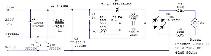

                                Here's the circuit diagram, which I found here:
                                A bang with smoke often makes diagnosis easy because it leaves obvious damage, so it's odd I can't see any. Possibly because it's one of the components with a cover – like the chokes L1, L2 and L3.
                                My guess would be L1 because it's completely hidden inside the octagonal black case marked CMC/14881. But L2 and L3 are also candidates, not least because they might be designed dual-purpose as fuses as well as EMC filters. Easy enough to check continuity of these with a multimeter if you have one, or a kind person steps in.
                                Looking at the spec of the Proxxon, it's clearly not meant for heavy work!!! Looks as if it's for modellers specialising in plastic, wood or chaps working on PCBs.  I think it would be quite easy for a metalworker to push it too hard, even with brass.
                                Edited By SillyOldDuffer on 31/01/2019 10:49:35

                                    Again here is another site with the circuit diagram plus a picture of the pcb identifying the components. Dave beat me to posting as I was rummaging through other pages on the net looking for any other data/information, at least it is not the same site as he has identified.

                                        The circuit diagram confirms the motor is a 220V model. Simple speed controller for these are widely available on eBay, as in the link I gave. If the motor is OK surely better to just junk the present controller, bring out a cable from the motor and use a new controller? If the motor isn't OK then bets are off!

                                              Good photos Bill but no obvious signs of smoke in there, nor of brass swarf having got into the motor /control housing.
                                              I would agree with Mike and Derek – look at the capacitors first – starting with the big 'yellow brick' (C1 I believe) but I suspect if this has died it might not be easy to test as it will probably have blown 'open circuit' and capacitors are not easy to test without the right meter even when removed from the circuit. If you can unsolder them and have a look at their undersides there might be evidence of damaged casing or the smell of smoke.
                                              The next items I would look at would be the bridge rectifier D3 – the black brick mainly because it is easy to test while in circuit – between each pair of pins there should be a resistance one way and short circuit / 0 ohms with the test meter probes connected the other way round (opposite polarity) . No harm checking the inductors L2 and L3 which should read as, effectively, short circuit (0 ohms) on a multimeter continuity test.
                                              At first glance the rating of D3 at 1 amp looks a bit light for a lathe so that raises the thought that this might b a vulnerable component. That said the motor should only be drawing 0.5 Amp so strictly speaking the rectifier is not overloaded.
                                              Triac also needs taking out of circuit and a slightly more specialist test instrument to check it.
                                              Having got the board out of the housing can you smell smoke on it anywhere?
                                              This is a very simple circuit and if you can find someone with even fairly basic electronics knowledge and a decent test meter they should be able to locate the fault and source replacement components.
