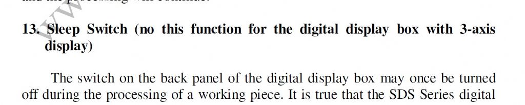

                According to my manual, the Sleep function is only available on the 3 Axis version.
                #517118
                GordonH
                  @gordonh
                  In my version of the SDS6 manual, there's an ambiguous reference to the 3 axis display in the Sleep function heading.
                  On my 2 axis display, pressing the HA button puts the display to sleep, while the unit remains switched on and continues to calculate x and y axis positions. Pressing HA again turns on the display.
                  I think that the section heading may be intended to say that the sleep function is not available on the 3 axis display but cannot confirm if this is so.

                      According to my manual, the Sleep function is NOT APPLICABLE TO the 3 Axis version.
                      Just been to the workshop (BRR) and tried my 2 axis DRO on the milling machine
                      The DRO must be in INC mode, pressing HA puts it to sleep mode and the displays go blank as if powered down but still tracks any axis movements which are displayed when HA is pressed again. But if the DRO is switched off either by the rear switch or wall socket any axis movement is not stored.

                                  Just to back up my previous post, here's the relevant section heading, from my manual:-
                                  I've just tested this (to make sure I wasn't mistaken) on my 3 Axis display and the HA Sleep function does work.
                                  This section also has  "In not ALE working state", so to use sleep, the unit must be in INC ( the HA button is disabled in ALE), as suggested in a previous post.
                                  Edited By Nick Hughes on 03/01/2021 15:54:06

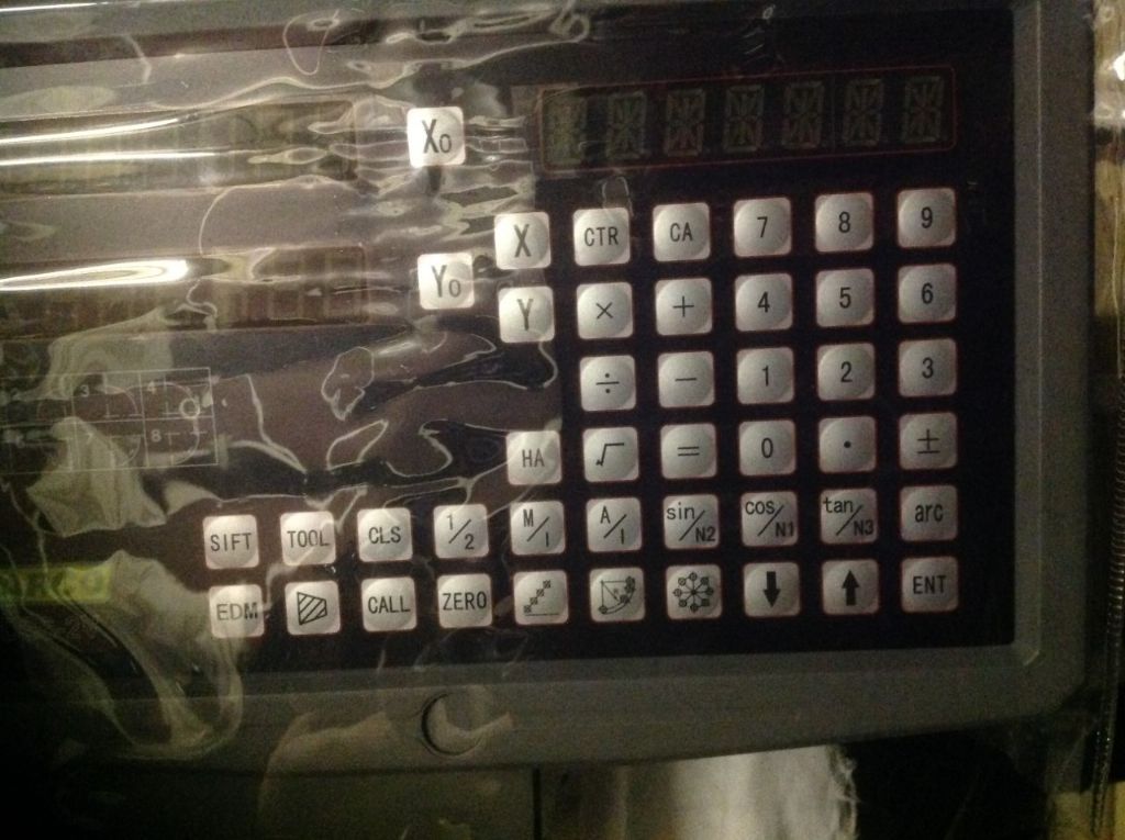

                                    Apologies for my necro-reply to this, Nigel; I've only just got round to giving it due attention.
                                    I looked at a video corroborating what you say.
                                    A problem I have is that, contrary to your and the video's description, there is no "ref" key on my DRO [see pic].
                                    I'd hoped my manual might clarify what to do instead, but it doesn't really. On p.11 ["Methods of finding mechanical origin"] it says:
                                    "Move the raster ruler to the position which is initially set up as the mechanical origin [not sure what this position is], and then enter into the select page of Segmented compensation. Choose Find_ZE and press ENT to the interface for choosing compensation method, press ENT the interior of digit display meter handles automatically. At this time finish finding the mechanical origin and quit the absolute co-ordinate system automatically."
                                    It goes on, in a similarly cryptic style, with more instructions than I can quote here at the moment.
                                    In order to try and get to the "Find_ZE" point indicated on p.11, I previously tried following the instructions on page 8 relating to "segmented error compensation":
                                    1). "Move the raster ruler to the smallest end of the co-ordinate [not sure what is meant by that] and enter into ALE right-angle co-ordinate system.
                                    2). Press X> M/1 enter into the input function of multi-segment compensation of x-axis.
                                    3) Set the segment compensation
                                    1). Find_ZE…"
                                    The problem was that "Find_ZE" is not what came up on the display at this point, so I was unable to comply with the instruction on page 11 "Choose Find_ZE" , which I'd hoped might have allowed me to arrive, via an alternative route, at the outcome suggested by you and the video.
                                    Any help would be greatly appreciated.

                                        I don't have a Sino SDS6 or access to one, I'm afraid, but I did find this manual online
                                        Page 10 of this manual refers to using the HA key to find the "first absolute zero of the raster ruler as the mechanical origin". I see that your keyboard does have a HA key (Home Axis ? ). The keyboard description describes the HA key as "Function key for sleep", though !
                                        The manual refered to is particularly difficult to understand – so many functions & so many obscure descriptions ! I have found the same manual as above on a couple of sites & also references to the console as having a referencing or "power down memory" feature as standard, so it should "just" be a case of working out how to access it.
                                        M-Dro (Allendale Electronics) used to sell these consoles & make mention of the fact that they supplied them with a "UK written manual". As they show this console to be superceeded in their line-up, you could see if they would send you a copy of their manual ? I have installed a couiple of M-Dro readouts at work (not the SDS6 console, though) and have found M-Dro's technical support to be very helpful.
                                        Nigel B.
                                        ps. Found another version of the manual
                                        Pages 20-22 give a bit more coherent description of referencing, but also suggests there is a "memory" function to retain displays after a power interruption if the axes are not moved while powered down (not sure I would trust it, though ). It also suggests that the HA key may have different functions between  2 or 3 axis counters. This manual has a picture of a consolew ith coloured keys, so may be later / updated version than yours. Might help some though ?
